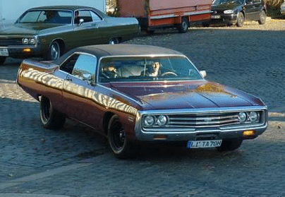

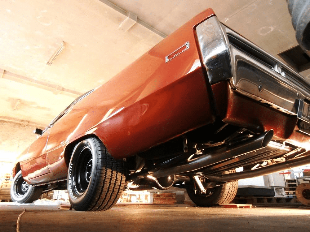

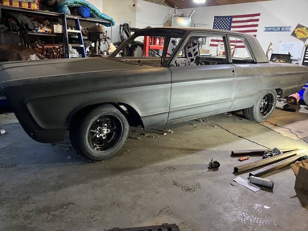

owner reports 215/60 15x7 wheel in front, 275/60 15x10 wheel, 5.5 backsp. in back, no modifications for fitment.

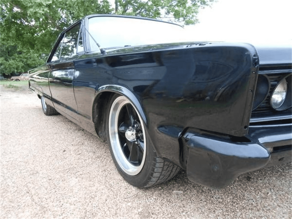

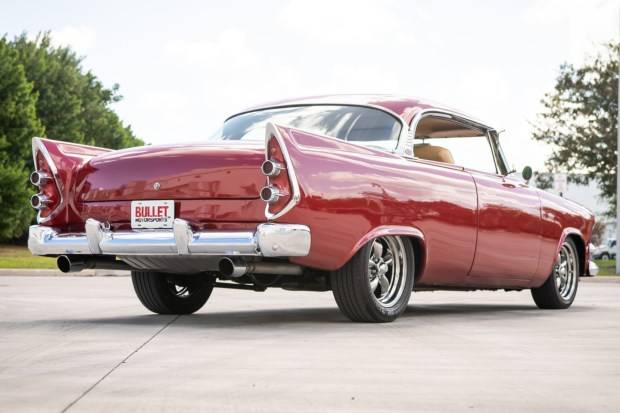

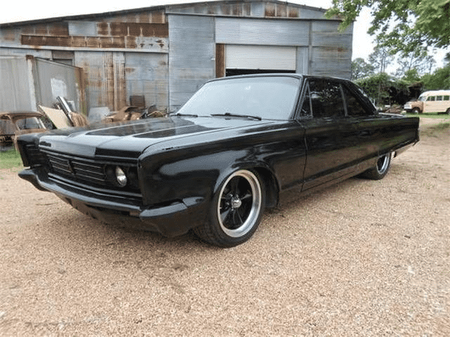

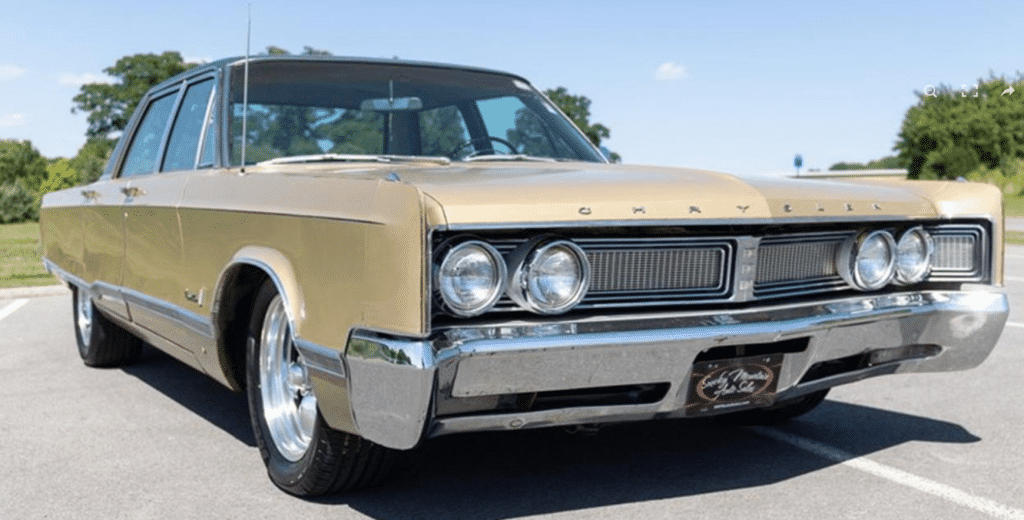

Five-spoke American Racing 17″ wheels are mounted with 215/55 Mastercraft MC-440 tires up front and 235/55 Pantera Touring CUV A/S tires.
Backspacing not listed. Nor is rim width, but tire size max recommended rim width is ~8.5 inches - eyeballin' these suggests at least 7 inches.

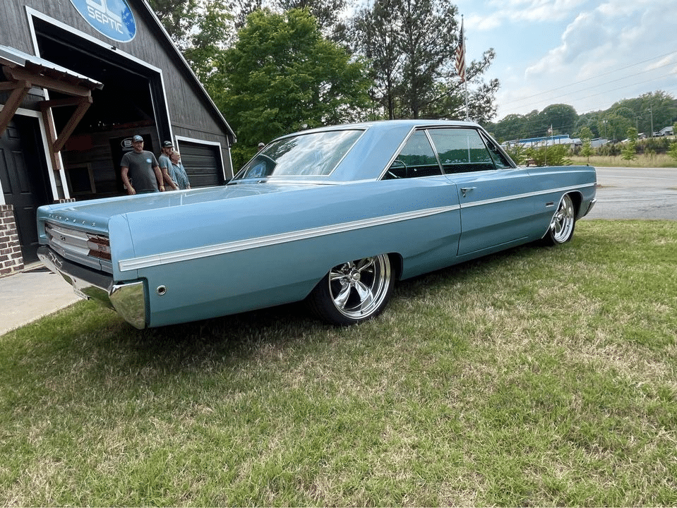

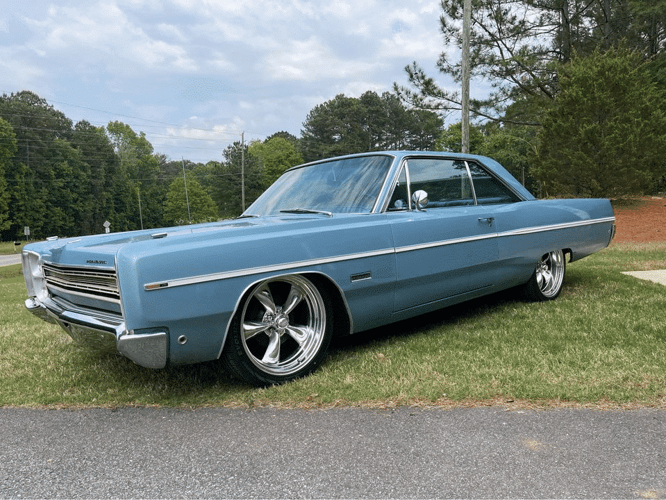

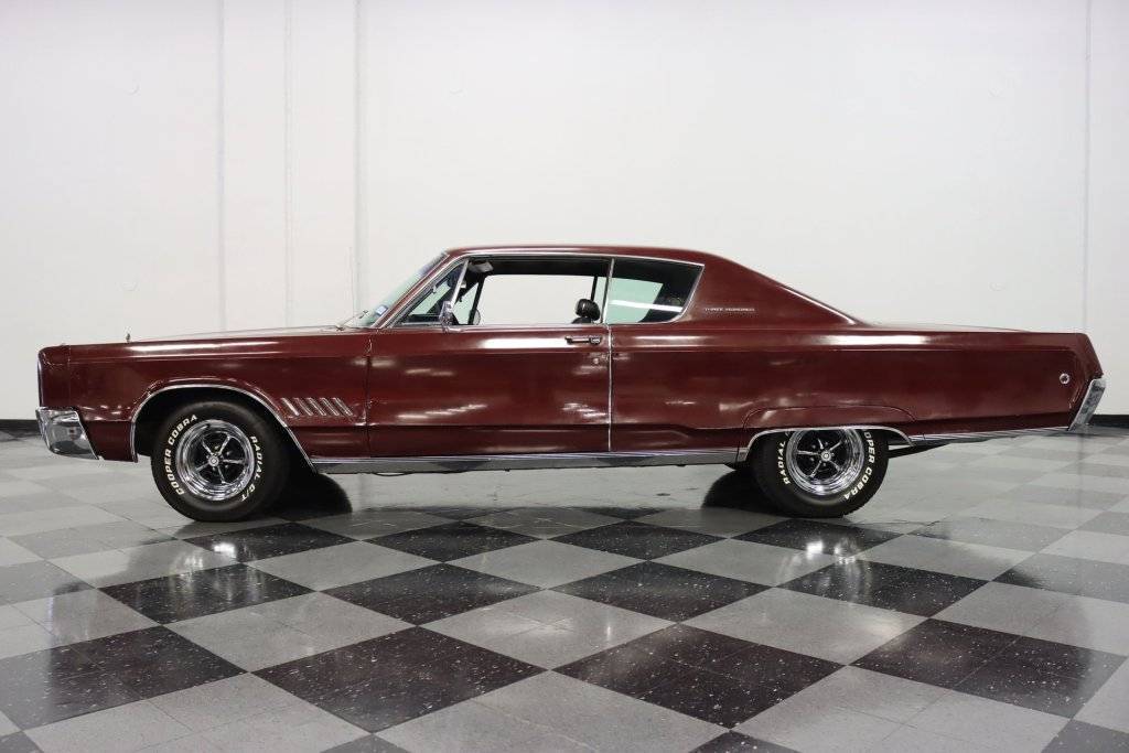

1967 Newport

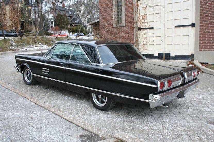

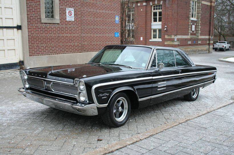

advertised to have 17x7/8 Torg Thrusts (staggered sizes front vs. rear), mounted to 235/55 tires. No backspacing given.

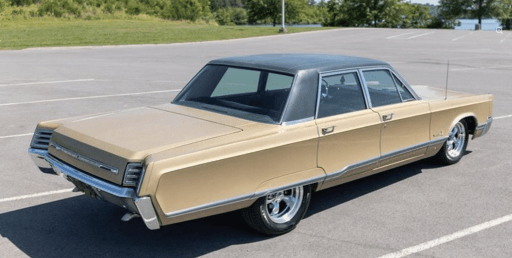

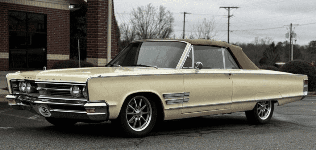

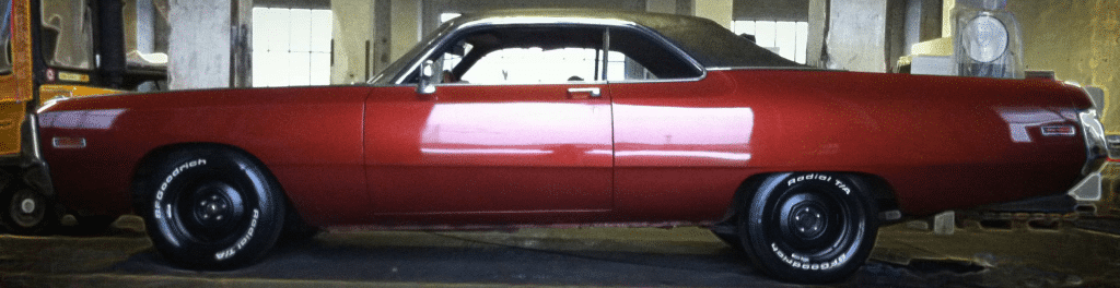

1968 Newport. (sorry - might be here, however, as Cragar S/S's are an old school staple that comes up a lot).

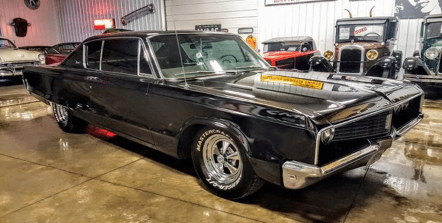

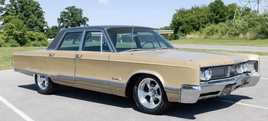

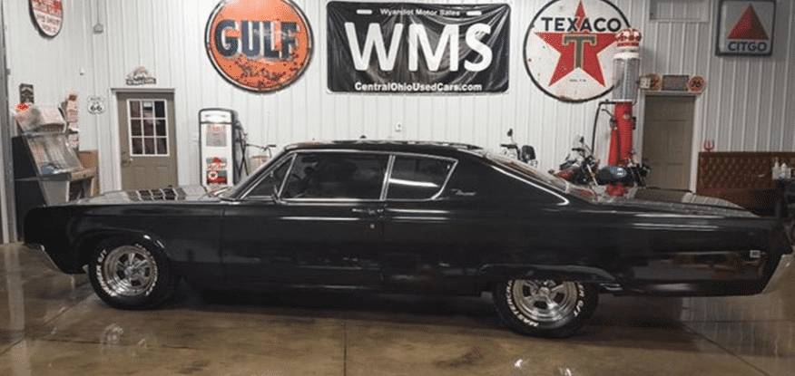

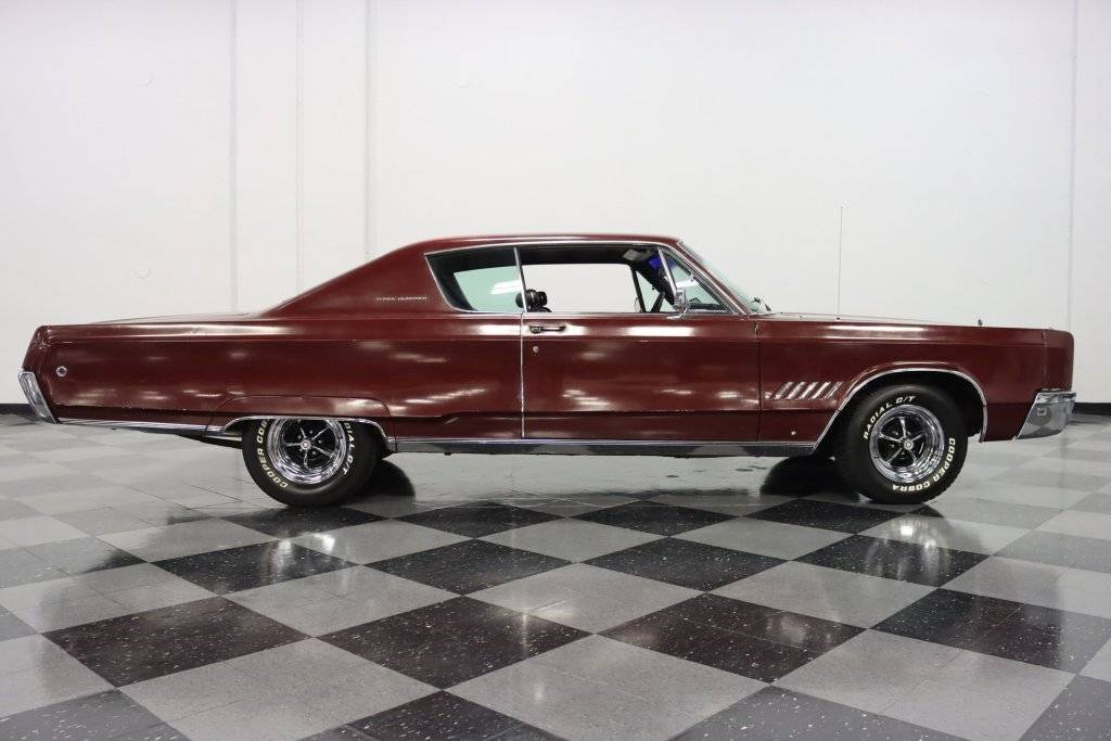

Only spec disclosed was 235/70-15's all around, eye-ballin 'em look like standard offset (~4.0 inches), and 7 inch width. If so, all should be fine with that combo in my experience.
Those rear wheels have the appearance of the 15x8 Ramcharger wheels, which have 4" BS.
agree, thats how it looks.
much deeper (more backspacing than that) my experience with that tire size in back you'll get interference. directly or if not by body roll.
maybe owner (@ATw) will see this and report the real deal.

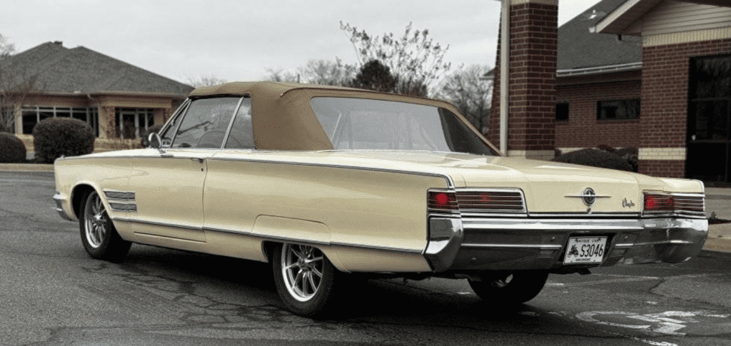

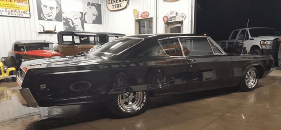

I am not on Faceplant, so if anybobdy can see the exact wheel size, please post it here?

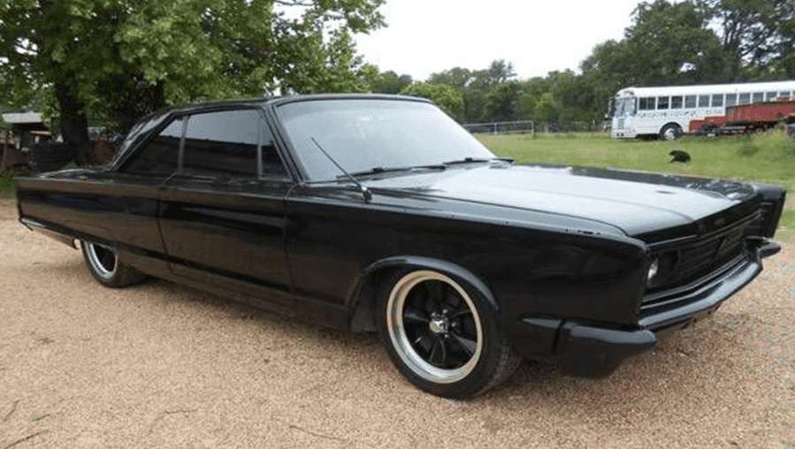

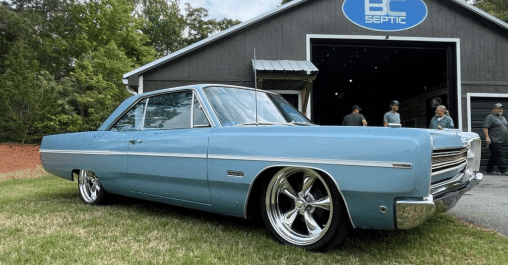

It does say they are 20 inch diameter, and most examples of that size, with a bolt pattern that could fit, would be 8 inches/9 inches width.
They certainly made wider wheels in the 20 inch diameter, but I see wider than 9 inch being a challenge, Could be why no skirts on (I assume it has skirts because I see that fender wheel well trim).
The backspacing (without mods to the car) in the rear, to clear the quarters on THIS car, has to be around five inches (eyballin' it). More than that (i.e., more positive), that pushes the wheel toward suspension.
Further, IF 8-9 inches or wider, the backspacing would have to be around 5 inches lest that is a weak wheel structure (AR probably wouldnt offer such a wheel spec).
