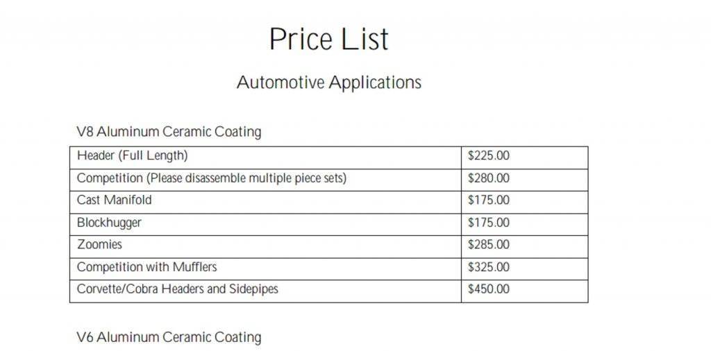

Anyone who has done this, how to these prices compare to your experience (please, you do not need to say exactly what you paid :))?
These prices look reasonable? thanks for a reply.
looks reasonable to me...gotta figure at least hr labour sandblsting..ect ect..cost powder..ect ect...
Everything is put in a burn-oven, before the blasting, prepping, and application/baking. At least at QC Coatings. They've been doing coatings for decades.
