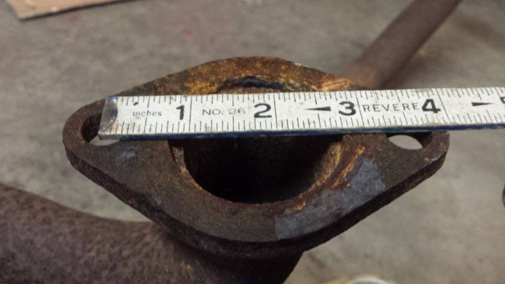

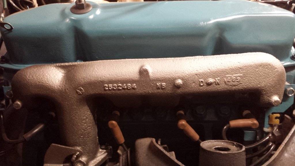

Thank you for the reply... Here is what i have. I attached a picture of my original 'Y" pipe flange and manifolds
That sure does look like a 2" connection. If the replacement exhaust will bolt up, you might have to use a 2" donut.

Well, a buddy of mine stopped by with a pair of 69 H.P. manifolds. out of a wagon. The pass. side fit like it should on the exhaust flange with my new exhaust kit. The drivers not so much. it appears it's up about an inch higher and slightly different angle. Does anyone know what 'C" body used the H.P. manifolds? 300? Id like to try to use them now i have them on the car.
