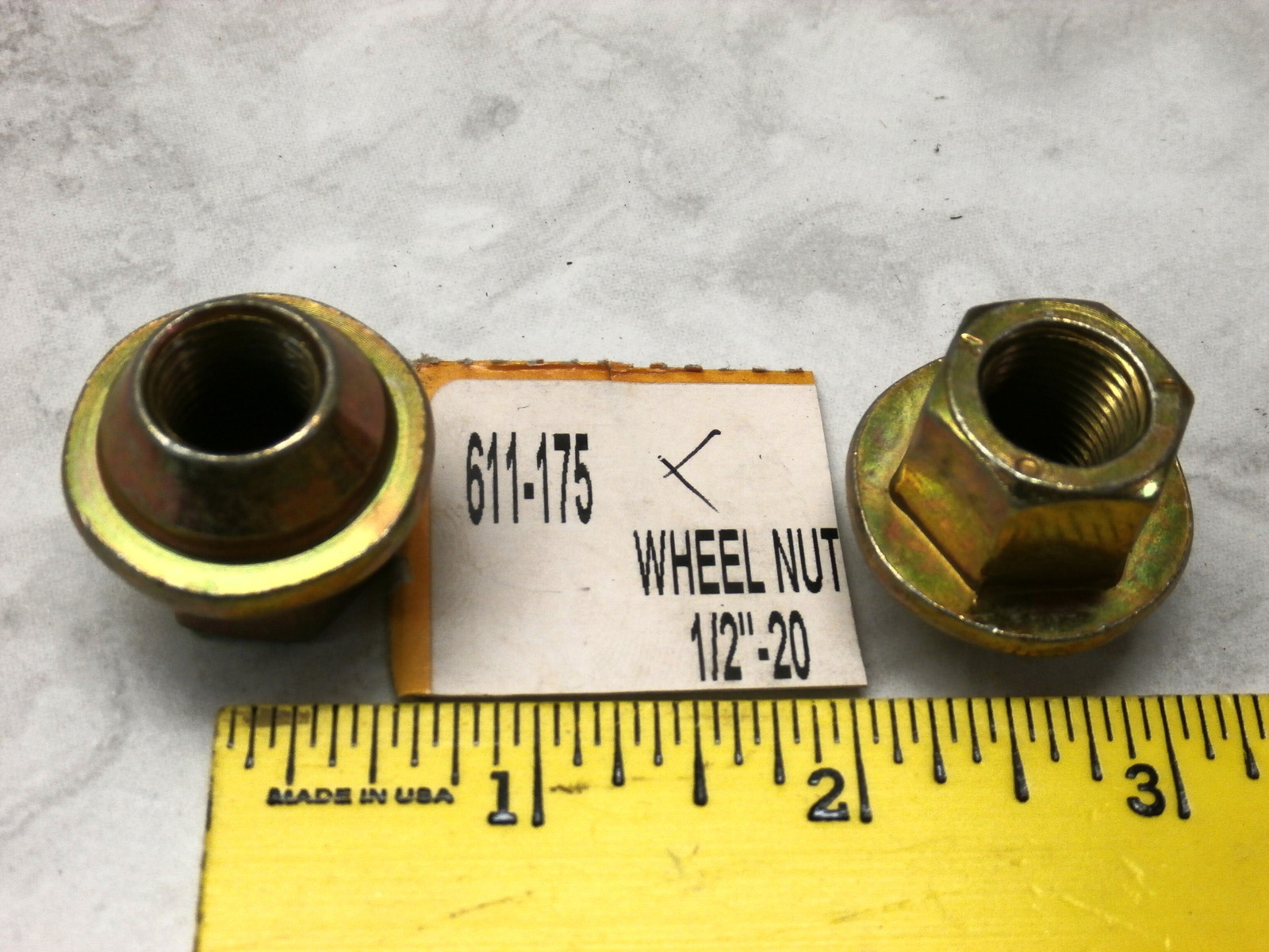

I had to run these lug nuts on my 1st Gen crewcab, so I could run the center caps from a 2nd Gen truck as well. Anyway they are Dorman 611-175. Look for a box of 10. They are a 3/4" hex, with 1/2"x20 thread, and have a nice wide flare and ridge on them. I keep meaning to get 20 for the wagon. With the wide cone and ridge, it is so much nicer because the socket doesn't bounce off the rim, it rests on the lug nut only. ;)

Those lug nuts will work just fine with steel rims , the ones with the free-wheeling conical ends are primarily for alloy rims and they won't chew into or collapse the seat on soft aluminum rims rather they will just push inwards and stop spinning when their tight.
