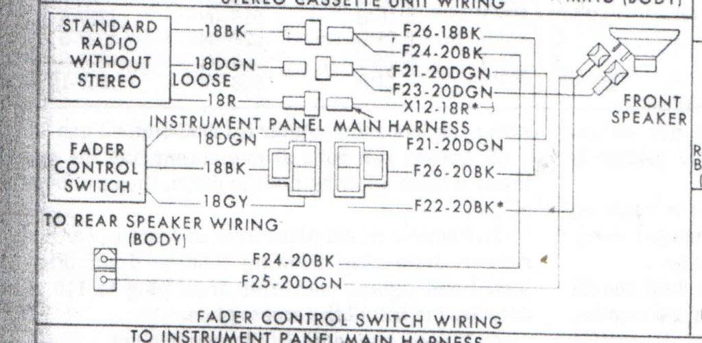

Factory wiring schematics are available in the factory service manual downloads at www.mymopar.com . The radios should wire the same as in '69-'73 C-body cars, I suspect. Free downloads. The radio wiring is in these schematics, too, but it might take some looking to find them.

Below is your current wiring, as long as 1972 and 1973 are same.

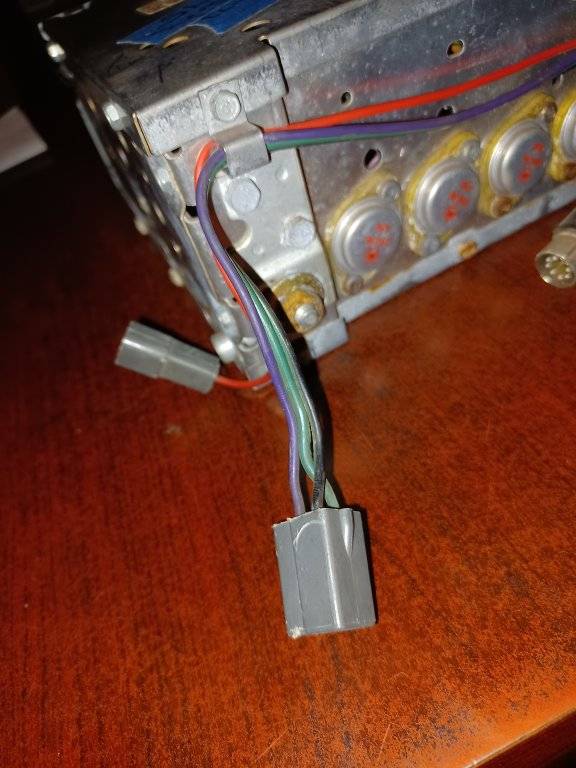

My guess is that your am/fm stereo unit has a violet wire, not pictured. With stereo, violet and dark green give left and right channels. Red is power and black is ground.
There might be a way to bypass the fader and wire the violet left channel directly to front and rear left side speakers. If your Newport has a single front and single rear speaker, you could take out the fader, wire dark green to front and violet to rear.

A picture of the wiring at the rear of your stereo radio might help us. Ben
That schematic helps a lot, thank you. My car has two speakers. One dash, and one rear. It looks like the best option is to wire each speaker as an individual channel. Green to front, and violet to rear as you said. I read about wiring both channels together with a resistor between them, but keeping them separate seems much safer to me. I'd rather not burn up a good radio.

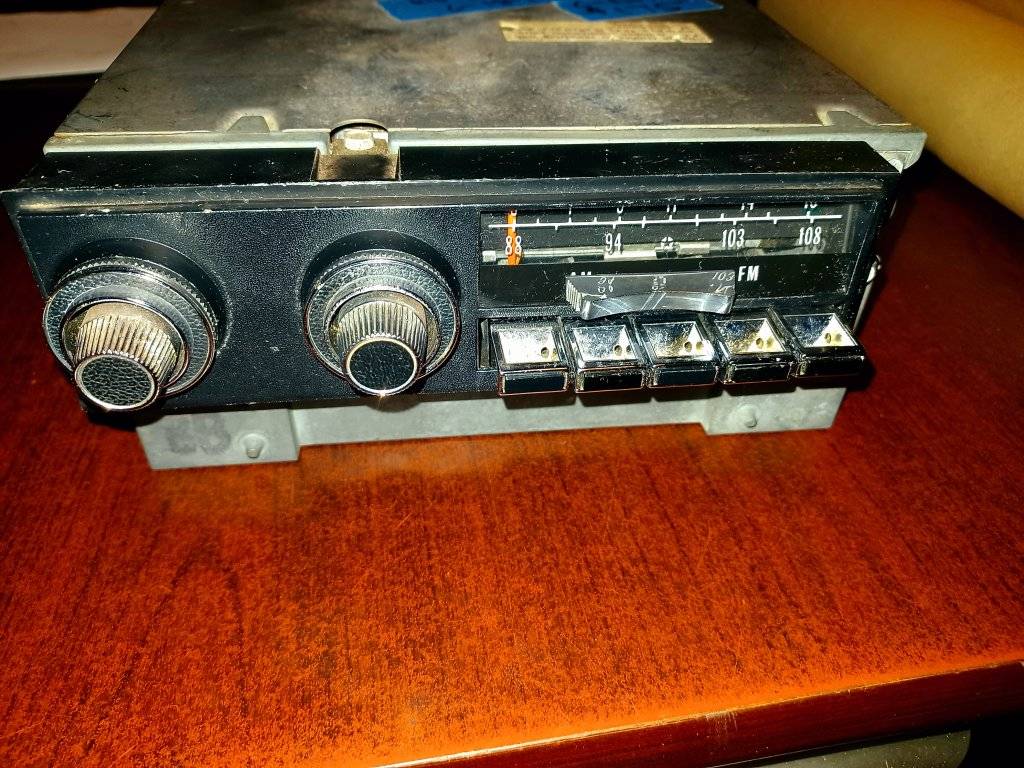

I have been on the lookout for a nice one for some time now. This one has no paint chips or anything and really cleaned up nicely. The pushbuttons were stuck, I easily got them free by separating a rotating disk that had stuck together. With a little oil, the buttons move very quick and smoothly. I have to strong-arm the presets on my old radio.

Good plan! And nice work on the radio.
