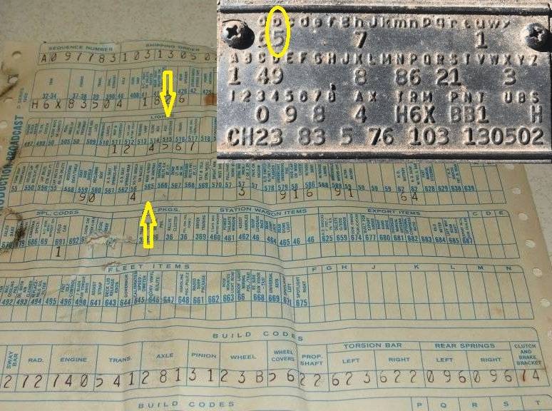

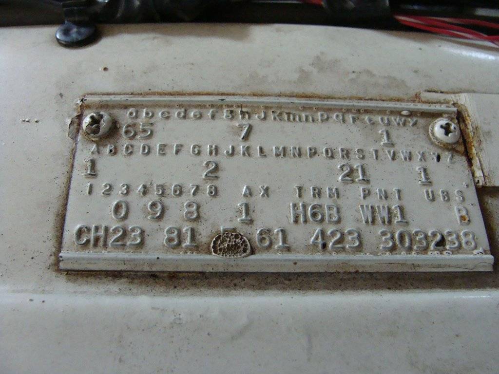

As @69CoronetRT will tell you, online decoders are full of errors. I've talked with him about this same thing, why I have a 65 vs 64 for my buckets and console.Tag has a 5 where it would typically indicate Rear arm rests w/ ash trays. But on the broadcast, the only "5" that might code to a tag is in Lights - for the ash tray. (r. arm rest code isn't even on broadcast)
@69CoronetRT Here's another 'odd duck': I was going through @GOLDMYN 's broadcast from the "Fender tag lovers..." thread: Tag has a 5 where it would typically indicate Rear arm rests w/ ash trays. But on the broadcast, the only "5" that might code to a tag is in Lights - for the ash tray. (r. arm rest code isn't even on broadcast). Do you think that maybe some of these anomalies being discussed are simply errors by the tag stamper, and nothing really beyond that? Goldmyn - does your car have ash trays in the rear arm rests?
Note: the superimposed tag is not covering any relevant info in the broadcast.

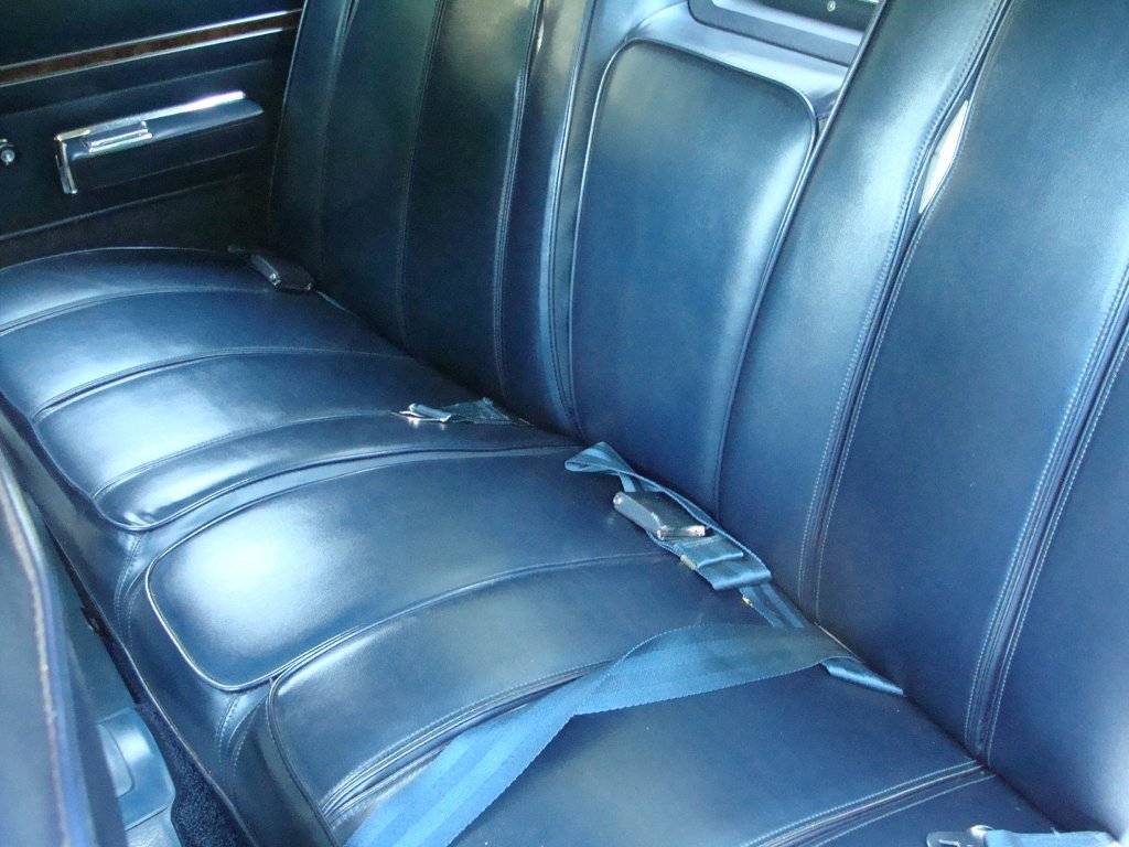

Yes, ash trays in rear@69CoronetRT Here's another 'odd duck': I was going through @GOLDMYN 's broadcast from the "Fender tag lovers..." thread: Tag has a 5 where it would typically indicate Rear arm rests w/ ash trays. But on the broadcast, the only "5" that might code to a tag is in Lights - for the ash tray. (r. arm rest code isn't even on broadcast). Do you think that maybe some of these anomalies being discussed are simply errors by the tag stamper, and nothing really beyond that? Goldmyn - does your car have ash trays in the rear arm rests?

Indeed 455 would be power buckets L&R, but looking at the broadcast, that's not what's coded - it appears it is 454 left power that is on the sheet. (the *6*/564 bucket codes jibe) Certainly 485 would have been buddy seat, but the 486 console code is already in that slot on the sheet. 485 would be a center arm rest, but I believe that would be for a *2*, or *5* (I believe) interior....correlation of b/4 and b/5 with *6* interiors.
