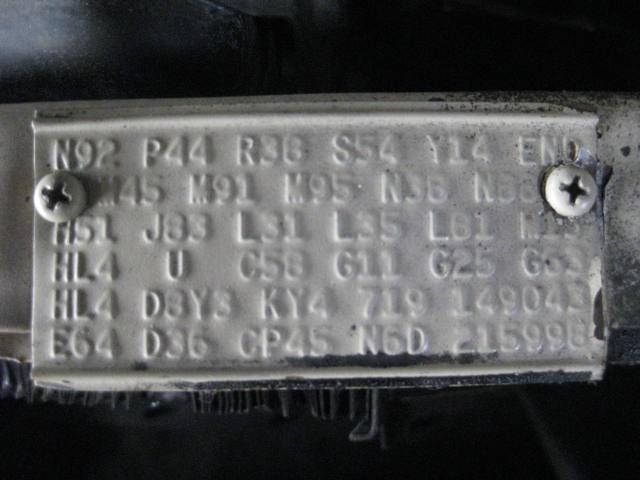

Hi All, I finally got a chance to get a few pics of my fender tags. I know some of you are pretty knowledgeable on these and enjoy decoding them. Thanks for you help.
Top to bottom... 78 New Yorker Brougham, 76 Town & Country, and 67 Imperial LeBaron.
Under the left screw on the NYB is M45 I took out the right one which was covering M25

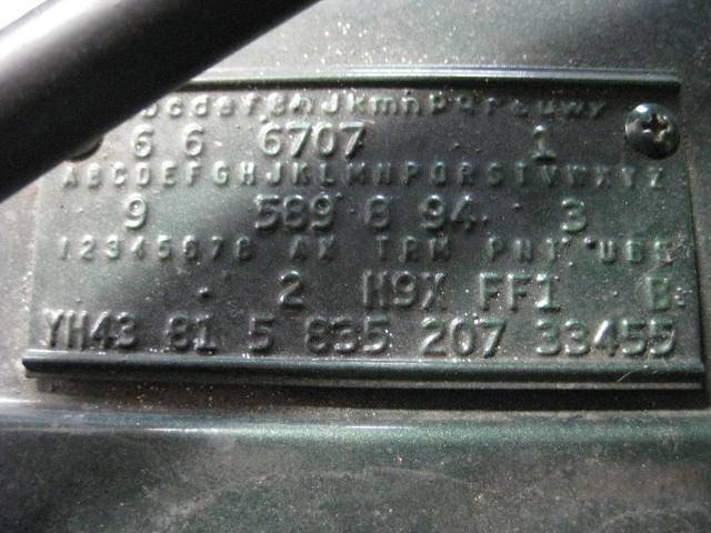

Your bottom tag decodes like this:
YM43 = Imperial Crown 4-door hardtop
81 = 440 ci 350 hp single exhaust
5 = Automatic transmission
207 = Feb 7 1967 build date
835 = Tires 7.75 x 15 whitewalls (x5)
33455 = SO number
AX 2 = 2.94 gear ratio, not a SureGrip
H9X = High trim level, split leather/vinyl bench seat, black
FF1= Light Green Metallic paint
B = Upper Door Frame paint color B is Black
D9 = Disc Brakes front/Drum Brakes rear
J5, K8, L9 = Power Brakes, Locks, Windows, Steering, Bench Seat
R4 = AM radio search/tune
b6 = Shoulder Belts (?)
d6 = rear seat speaker
g6 = Bumper reveal Moulding
h7 = Fender-Mount Turn Indicators
j0 = Beltline Moulding
k7 = R/H manual operated mirror
u1 = Sold Car/Expedite

This is my first decode of a 67 Imperial so I'm spitballing here....
Does the car have these options:
J/5= Power seats? Were the H9* seats power seats standard?
K/8= Power Windows
l/9 = Power window vents
N/8 Power trunk release (does the car have this?)
Q/9 = tilt telescope steering wheel (does the car have this?)
b/6 = does the car have seat belts for a center passenger in the front?

Thanks Patrick looks close but no cigar...lol mine is YH for LeBaron it doesn't have the b6 shoulder harness, or power locks, I wonder what they mean by upper door Frame color black... mine is a hard top.

Mine has every thing except the seat belts for the front center passenger. Thanks

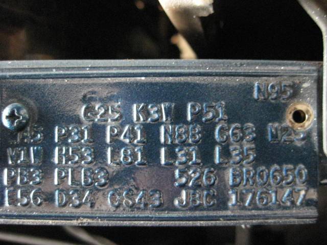

The top tag....
M45 Fender skirts
G25 Glass, ventless side
K3W Stripes, Tape, Body Side & Deck (White)
P51
N95 Emission Control System (California)
P31 Power Windows
P41 Electric door locks
N88 Speed control, Automatic
G63 Mirror, remote control, Right side
M25 Sill mouldings
V1W White vinyl roof
H53 ATC II (Oh No!)
L81
L31
L35 Cornering lights
PB3 Cadet Blue Metallic
PLB3 Light Blue Leather
526 May 26th
BRO650
E56 360 4BBL
D34 Torqueflite
CS43 Chrysler, Special/Luxury Class, 4 door hardtop
J8C 360 4BBL, 1978, Jefferson Plant
176147 Sequence Number
The L codes are lights.

My upper door itself on my '66 Coronet hardtop is black, and has the same code. That is what that means. The inside upper portion of the door is painted black,
Also, that is why I put a (?) next to the annotation for shoulder belts, as I was not positive of that meaning.
