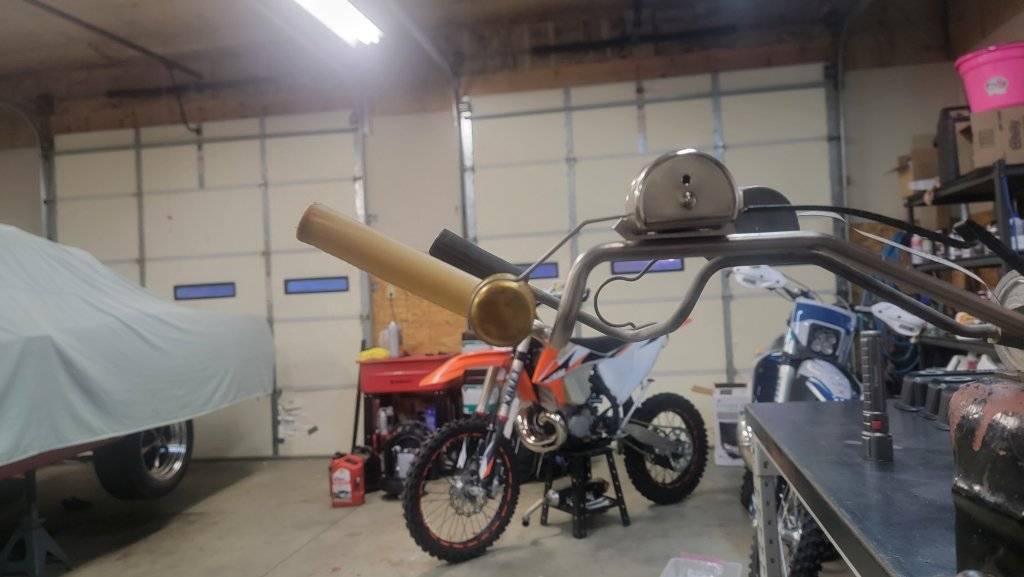

I see a couple of interesting toys in the background there
