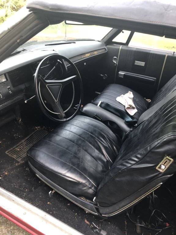

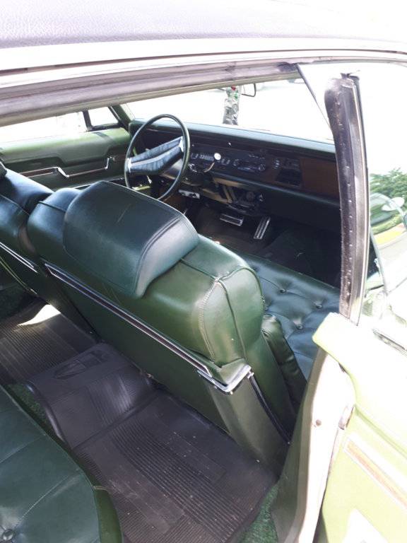

Various questions. Are these seats from a ‘70 Fury III? I don’t see them referenced in the sale brochure. They look similar to a ‘69s Sport Fury Bucket seat.

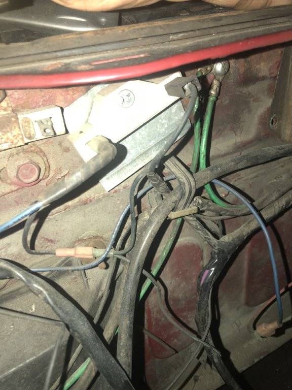

Also - I’ve replaced all exterior lights but this drivers park light. I’m getting voltage to the connector and I get about 10.5 volts to the park light connector. That should at least make it light dimly. I suspect a bad ground but all my headlight harness grounds are replaced and clean. Are the park lights grounded through the wiring harness ground cable? Or are they grounded through the housing itself?
I say that the seats are correct despite that odd-looking upholstery on them. 71s have seat back latches operated via push buttons and 70 to somewhere pre-Fusie time
the latches had a release mechanism with that vertically moving lever. Also the head restraints look good, because they where ``skinnier`` on Slabbie seats, and only 69-70 had that adjustable type on the buckets. Divided bench seats are another thing like my 73 Imp shows. Will the wheel covers from a Chrysler stay on?

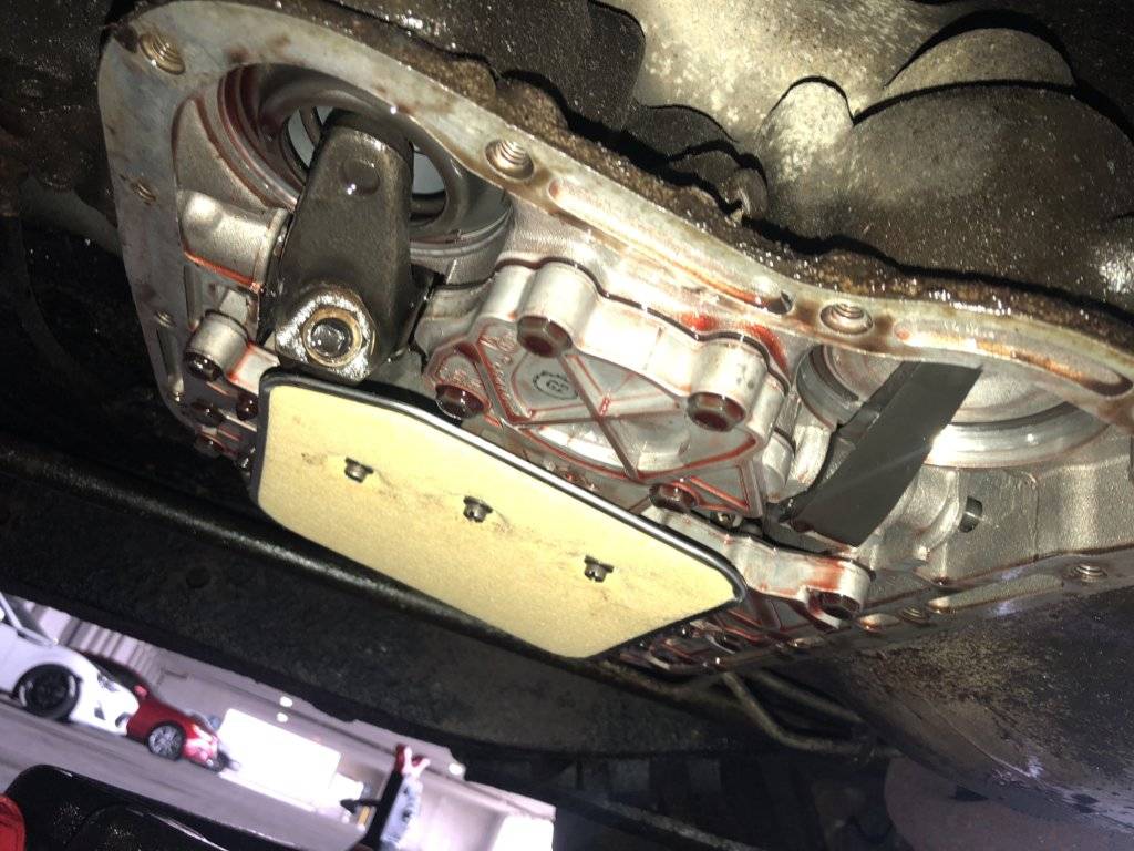

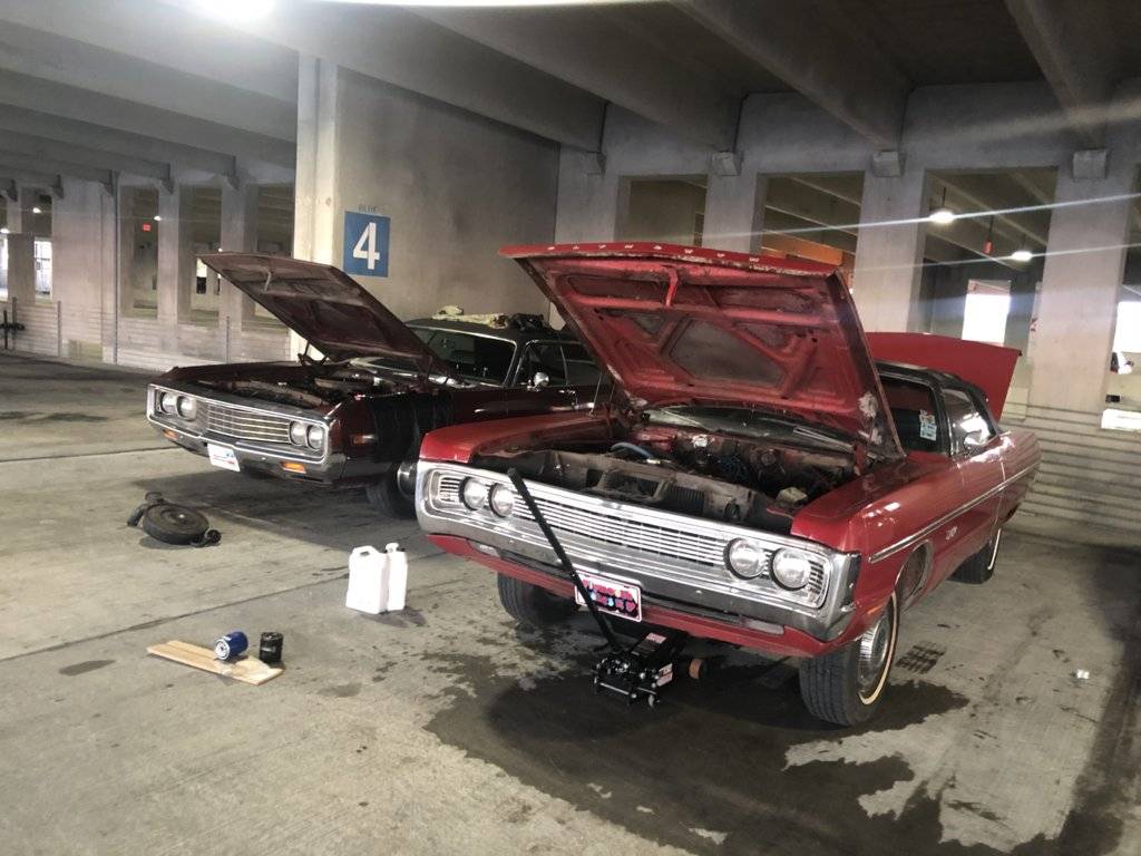

Finally got around to dropping the trans pan. Pretty happy with what I saw. No sludge or discoloration of the fluid. It looked pretty new and still had a pungent smell. Replacing the filter there were very small flakes of metal - and some at the bottom of the pan but there was none circulating through the fluid. Doesn’t look like it was enough to warrant immediate action and the transmission still shifts strong with all gears working. It always surprises me how something so little as changing old fluid can “wake up” a car in its throttle response. It does seem like the Pan has a tiny leak at one of the front bolts. Not excited about dropping it again to fix it but we will see.

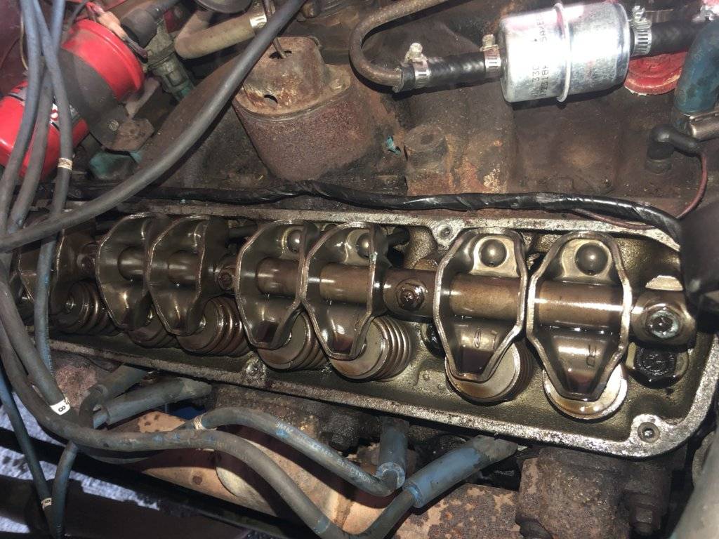

Drained all the oil out of the block and popped the valve covers. Nothing alarming and no gump or metal flakes but the oil was pretty discolored so I’m sure it was passed due on it oil change. Don’t know what was run before so just changed to Rotella 15W-40 non-synthetic. There was a leak coming from the oil filter before so we will see if this one holds up. Replacing the valve covers with a nice rubber set from Edelbrock. The first set valve covers cracked and leaked like hell so I’m on my second set.

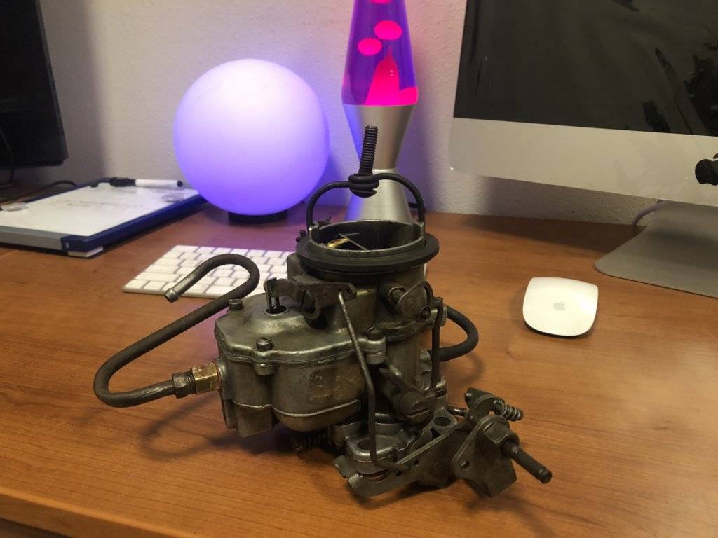

The carb runs like garbage while cold - sputtering and coughing, shaking until it reaches a good temp. Amp gauge fluctuates and doesn’t regulate until the engine warms up. Will go and try and adjust the choke and settings a bit but I believe it’s the original carb and who knows the last it’s has a rebuild. At least a 1bbl should be relatively simple. It’ll be a learning experience.
However. It is a great night cruiser. I’ve been training her up as I would like this to eventually be her car. Still getting use to the touchy brakes and overly assisted power steering.
You gonna keep that one barrel or upgrade to something bigger? I had all the same issues with mine. I messed with it for a while but it was essentially an on off switch. Best thing I ever did for my 69’s 318 was that Holley 600. That little motor loves that thing and I think it helped mileage vs the tiny sewer hole it replaced. Just wondering. Nice going on your fury man. It’s a beautiful thing whenever so far so good happens!!!

I’ve thought about switching out to something - but haven’t done any research into what would be a good replacement. Something easy to rebuild and with a nice automatic choke. Not too keen on electric. Might have to look into that Holley!

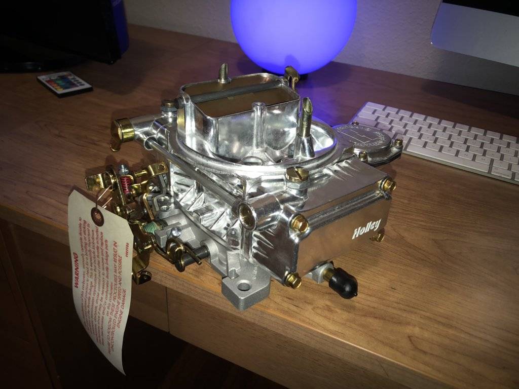

Gary was able to help me out and let me get a 4bbl manifold. Need to clean up the surfaces a bit but its a clean piece and should bolt in easily.
For fuel delivery - switching things up. On the Carter the fuel line and seat were almost fused to the body, the lines got kinked/bent and there was damage to the carb body. So. Decided to ditch the Carter for now.
To sit on top the new manifold, Picked a Holley 4160 4bbl 600CFM. Ill have to use the Mopar Adapter Arm PN: 20-7 but other than that, all the linkage looks like it should switch over easily. Hopefully the kick down linkage isn’t too short now. New Carter fuel pump. New filter and lines from pump up.

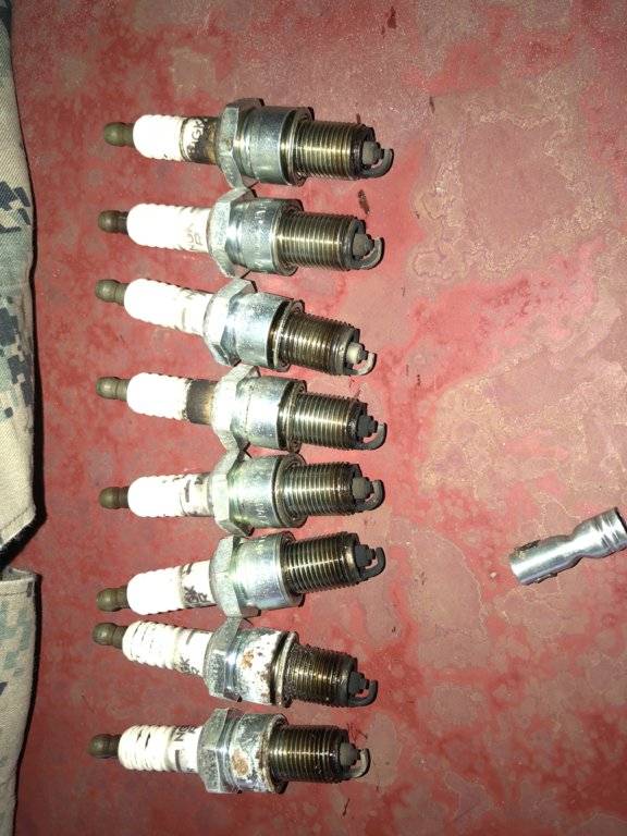

Replaced the old wires with a set from Taylor. Old plugs were corroded and abraded. Changed out plugs with NGK 3459. Out come the old.

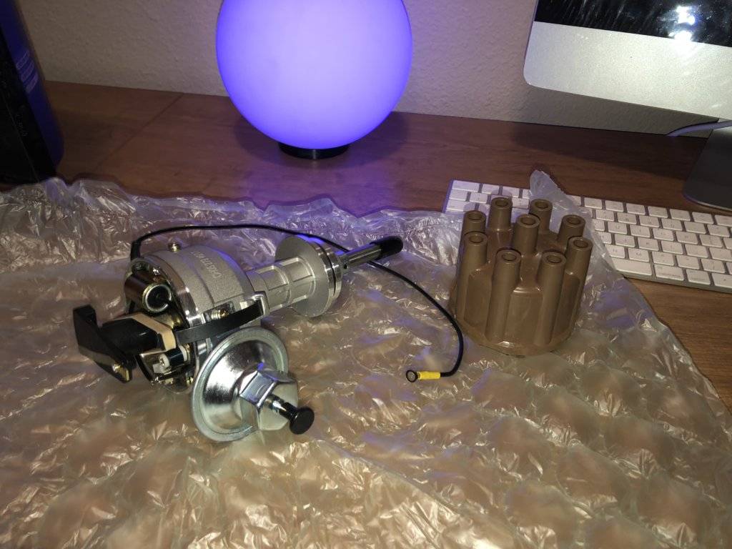

For ignition

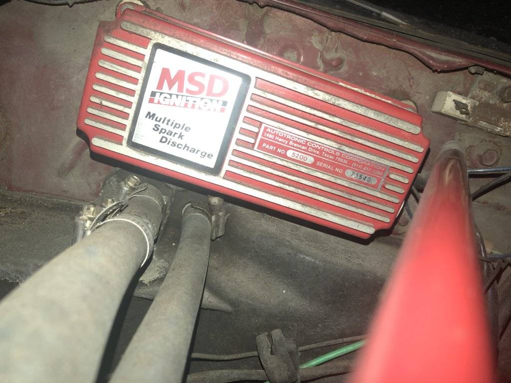

Since I got the car I’ve wanted to get rid of this spaghetti wire mess that is an MSD-5 setup. I’m sure its been in there since the late 80s. Lots of electrical gremlins and haphazard wires that I’ll need to fix. Day by day.
Out comes the old distributor. Rotor looks to have some damage and internals are all but corroded.
Replacing is a nice points dizzy from @Rehrenberg on eBay. Very nice POC and great shipping time. In goes a new coil. Resistors. Lots of new wires I’ll have to splice in or create.

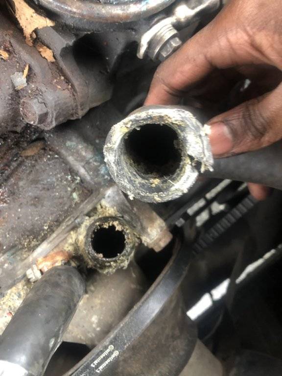

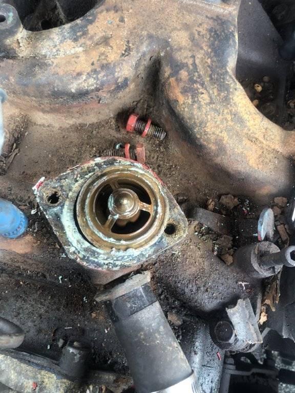

Drained the block of coolant today. Every passageway was caked to the point of needing to cut rubber. Will try flushing out the system and cleaning the waterways once its warmer out.
Took off all the attachments and bolts from the intake. (Not pictured) Doesn't seem to budge from either end with a pry bar. Have hit it a bit with a rubber mallet to loosen it. Any suggestions?
