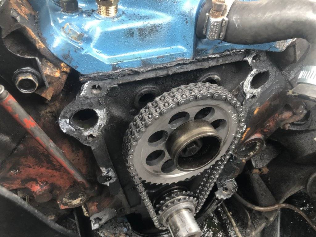

The chain had some slack in it. About 9° degrees of play in it with camshaft engaged. FSM limit is about 8..5°. Decided to replace it while I was in there with a Cloyes Double roller set. Motor has good compression in cylinders. Cam wear is suspected for the mileage. Worked on getting the oil seal in without a press but made it work and sealed it with Neoprene. I’ll have to do an oil change for any material that dropped down into the oil pan.

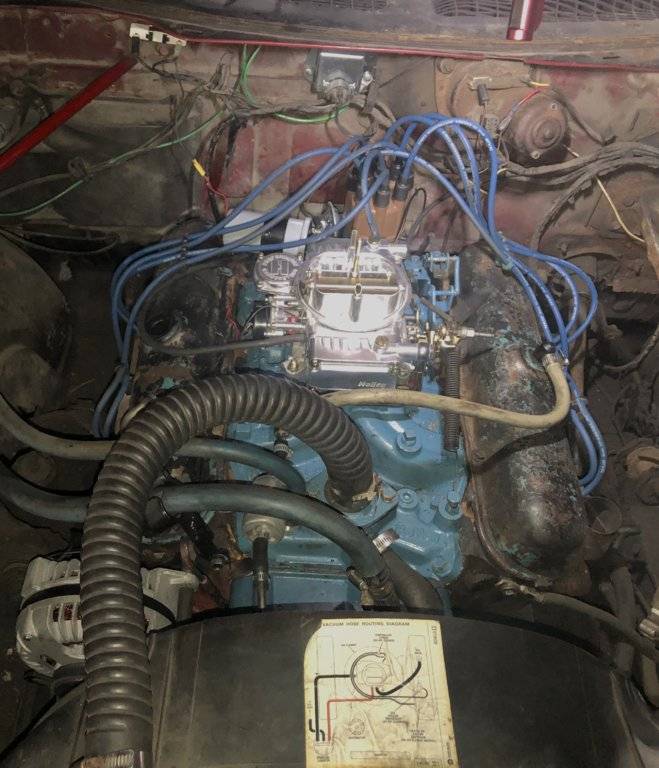

Starting to look like an engine again. Ignition rewired, choke hooked up, Engine on TDC, Dizzy lined up. Block full of coolant.

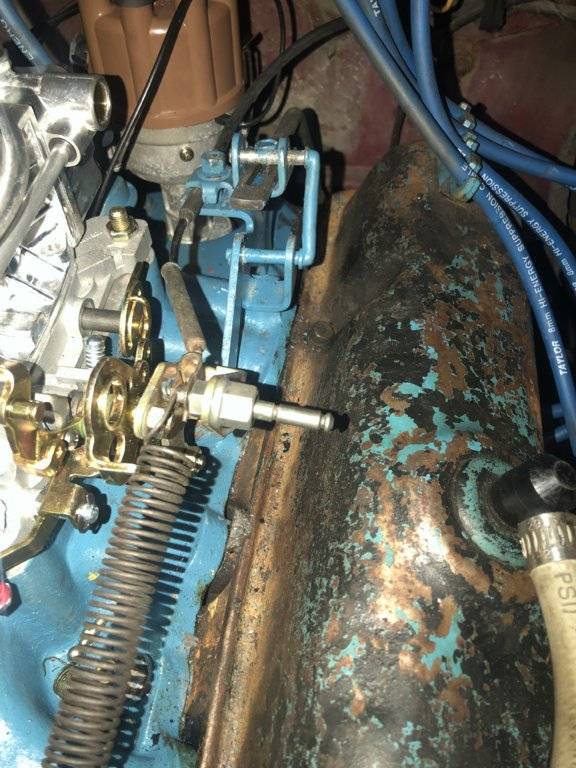

Last thing should be the linkage. I’m able to set up the kickdown, but I can’t get the throttle set up properly. Sitting a bit too far forward.
Possibly need a different or 4V bracket? It’s the original 2V off the old intake. Anything I can fabricate?

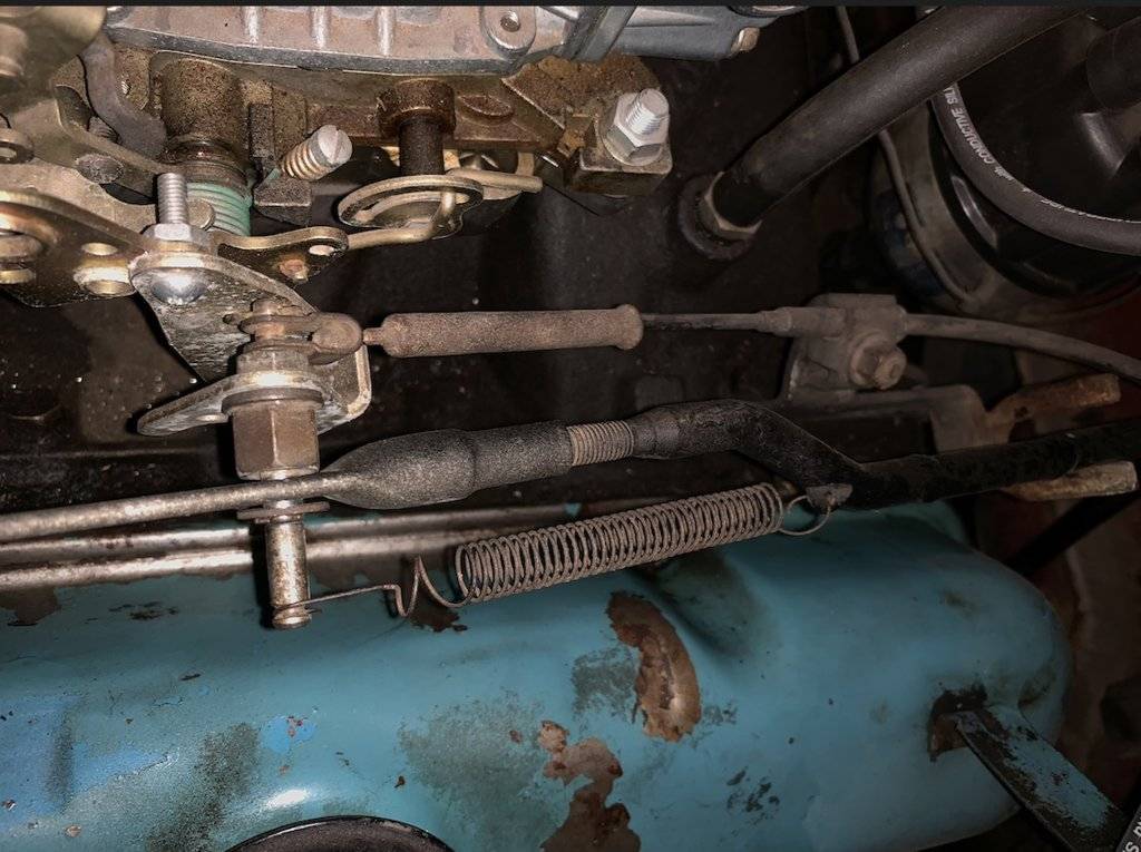

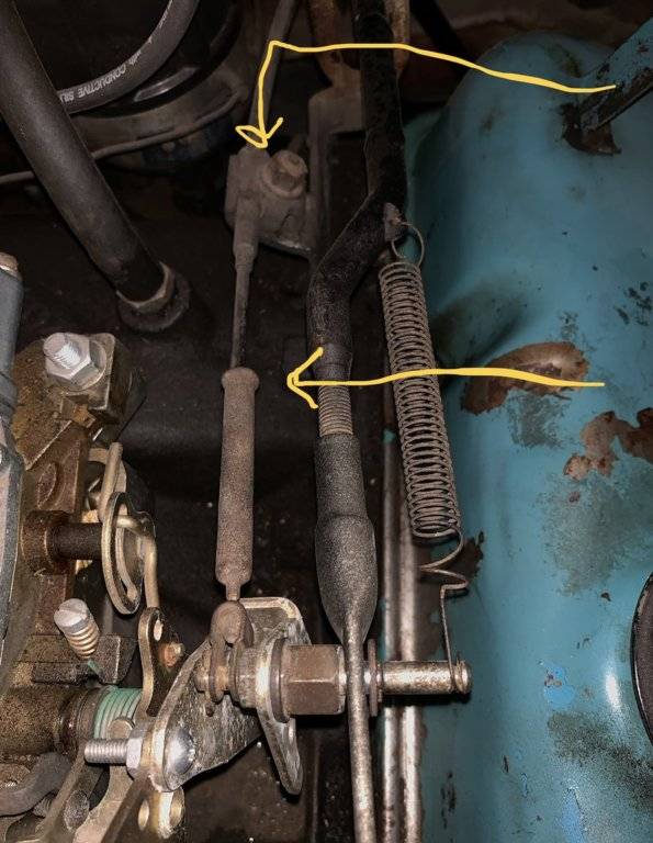

Here is the no cent fix for your linkage. Check out my pick I’m exactly the same set up as yours. Holley 600 from a 2bbl. All I did was bend the foot feed bracket straight up and it both moves it in line and a little back at the same time. In some cases you have to bolt some all thread in the clamp and use a hose clamp to hold the foot feed cable. It’s sleazy but it works. Check out my picks and you’ll see what I mean. That binding cable will give you fits and eventually snap. You got this.

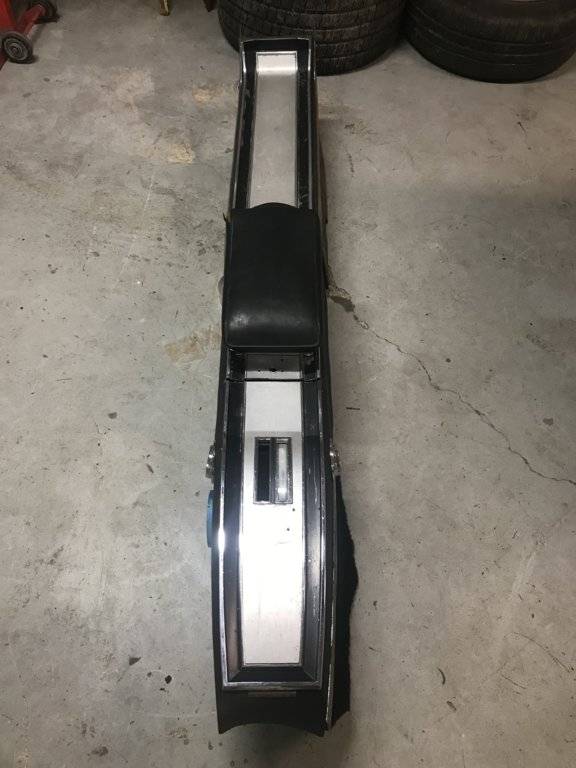

While I take a hiatus - A friend is parting out 2 ‘66 Chargers and selling the console for a pretty good price. Might as well jump on the opportunity as it’s local. What all do I need?
The console body itself, wiring, the 3 welded brackets, linkage and shifter? (Shifter is already sold so I’ll have to source one)

Looks like I'll be needing a new steering column collar, a good shifter/knob and once i find out the skinny, possibly the correct linkage. Maybe I'll check a parts book tonight while I'm on duty. I'll get some pictures of it once i pick it up this weekend.

Also looking at the pics and info The Goose gave you earlier I don't think will apply to your set-up. Looks like the conversion he did was on a 68 or earlier model with the multi rod kick down linkage. The kick down on your car is a one piece from the tranny to the throttle linkage and if you bend up the throttle cable mount it will interfere with the kick down linkage's ability to move. You can see on the pics posted that his kick down linkage mounts low and below the throttle bracket assembly.
I had a similar suspicion. Im not around the car so I'll have to check the play and movement in linkage when Im around it, but yes it uses the 1 piece kickdown linkage.

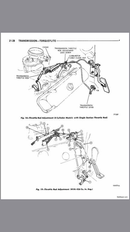

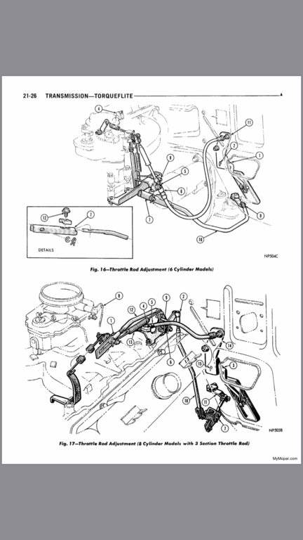

I think what i would need is the 3-Piece linkage detailed in the manual? The only issue however, is the manual makes zero mention as to what engine applications each setup is for. The only distinctions it makes, are for 6 Cylinder, 8 Cylinder, and HEMI cars. Additionally in the diagram, they both picture 2BBl BBD carburetors so maybe theyre all interchangeable?

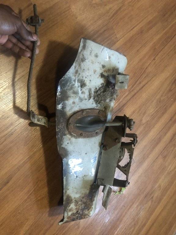

So I picked up the console and linkage. The linkage looks like a similar shape and all the bolts and positions are the same as the listed picture. As for size and length, it may vary.
Pictured I have everything from the Upper Rod and the first Rod swivel piece. Is the “Column Lock Rear Rod” and the “Adjustable Rod Swivel Assemblies” items that would already be on a car with column shift? More clearly my question is - would I need to go back and make sure I grab these pieces of linkage? Or will it already be on my car?
Well your 3 piece kick down is specific to SB and BB due engine height and geometry. So looking for a a set-up off and SB and a 4bbl is going to be tough since they never offered one to my knowledge, but if you get the lower section for a SB 2bbl, and then run a 4bbl BB throttle bracket and upper rods I think you should be able to make something work.
