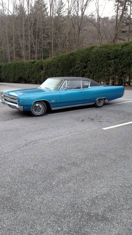

First day out with Sport Fury. Not the best.
