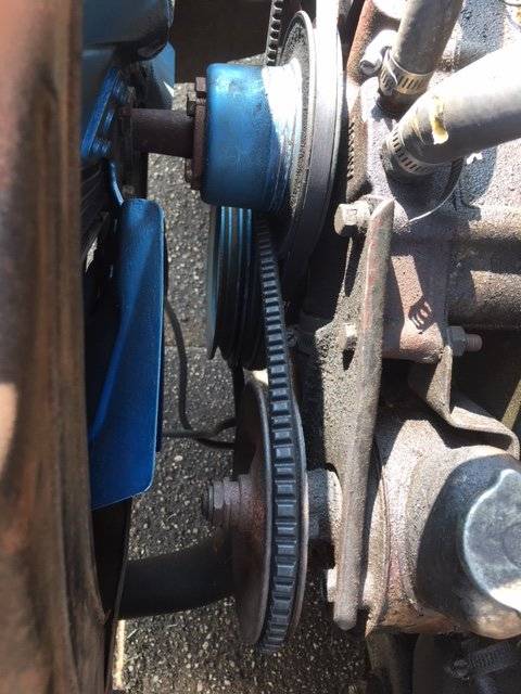

i went to check the power steering fluid in the 68 and noticed the power steering belt was half turned over on the crankshaft pulley. I put the belt back on right but it turned almost by the time I made it home. How could it turn? I just replaced the belts in July with gates belts.
Usually flipping belts are the result of misaligned or damaged pulleys, belts can sometimes also do strange things if they are run too loose. As you have a rigid PS mount, I doubt that you have an alignment issue. Once a belt has turned over, the cord inside usually breaks so that the belt will no longer run as it should. Replace the belt as it is now damaged and see what happens. Check the pulleys for dings or other damage.

Maybe it's an optical illusion, but I think that belt is in the wrong groove on the crank pulley.
If that's a Gates belt, it's doing an impersonation of a Goodyear "Top Cog" belt.

From what I've seen, you can have about 1/2 groove mis-alignment and not have any belt longevity issues, as long as the tension is normal.

So, what made it "jump ship"? Still probably needs a new one, for good measure.

Any brand of V belt can do that. The only reason-it is an end belt from the tube or slab it was cut from. I bet if you cut the belt all the way thru, you will see that it does not have cord all the way thru the belt, it should have. Also if you hold the belt cog side up, inside out up you can see a taper. That belt should never have been shipped. Get a new belt
I just got a replacement belt for the other one. It's the right groove, I have the three groove crank pulley hoping eventually to get the a.c. Working. The pump is a little out of alignment with the crank pulley but this setup has worked for three years and 8,000 or 9,000 miles. Yes the colors are wrong but why stay stock when I no longer have number matching engine, core support,etc...
