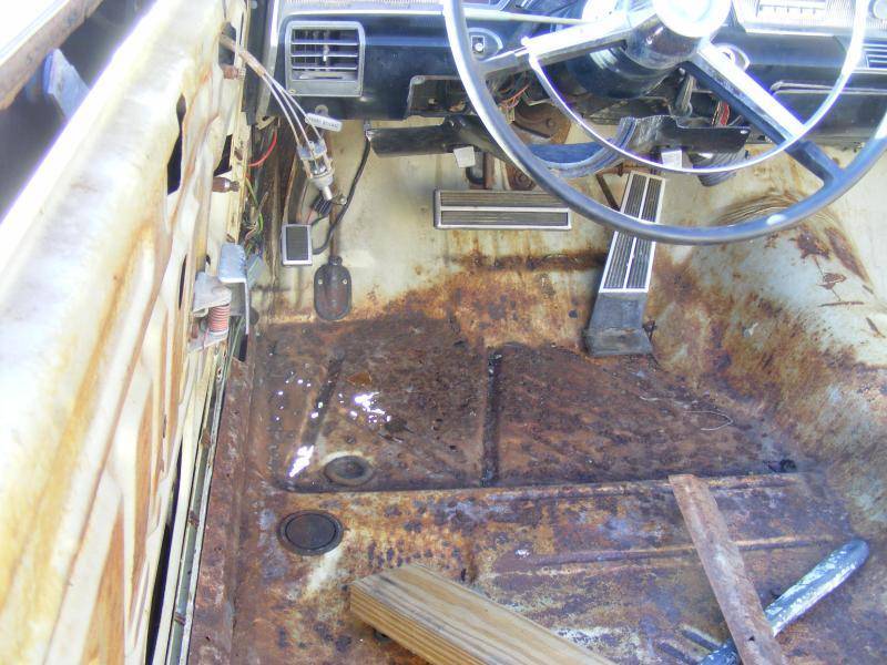

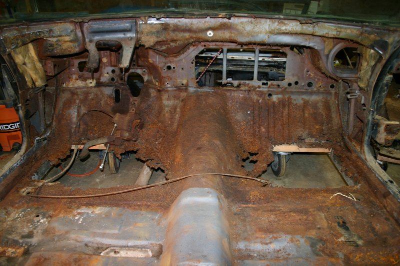

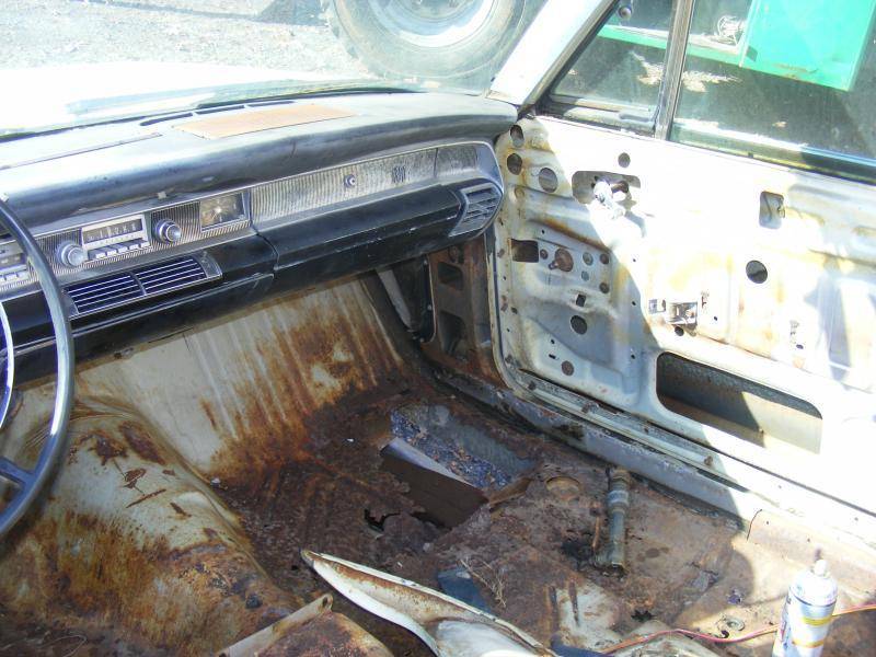

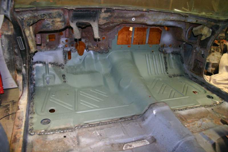

what is shown in the desoto is 100% more than i have now thanks again for posting the pics i did`nt figure it would be easy but you have to start with something

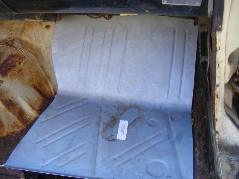

i ordered a r&l front set from them they shipped right away these are obviosly not oem but for a starting point for replacing what i have they are a hell of a lot better than starting with a flat piece of metal and a hammer . i will go on to get the rears and and trunk stuff from these guys. possibly 2 sets.good luck with your project

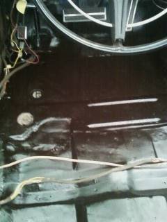

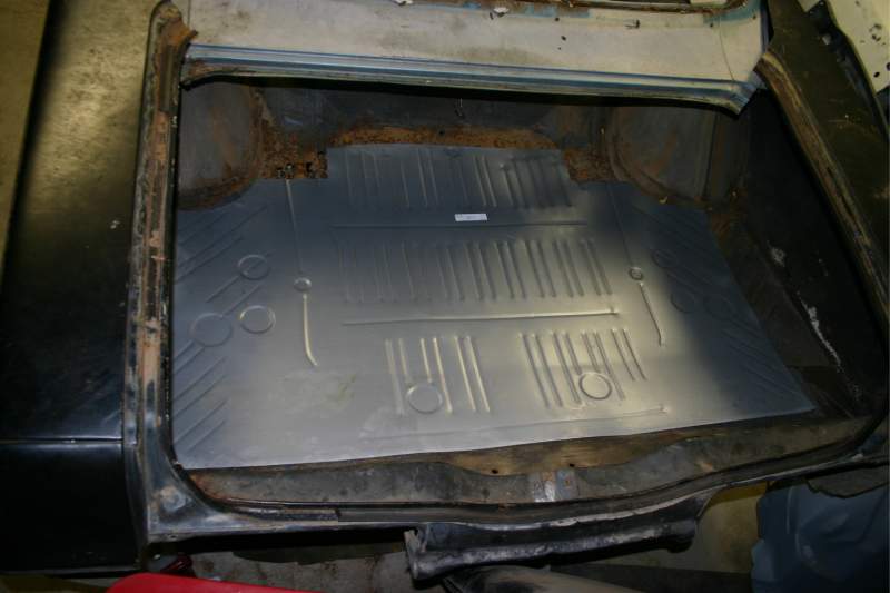

just tossed in where they will eventually go

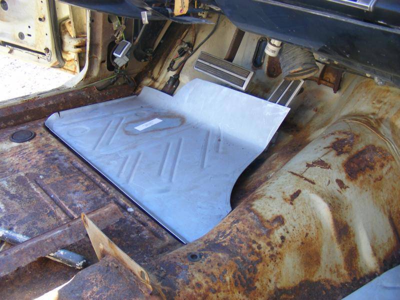

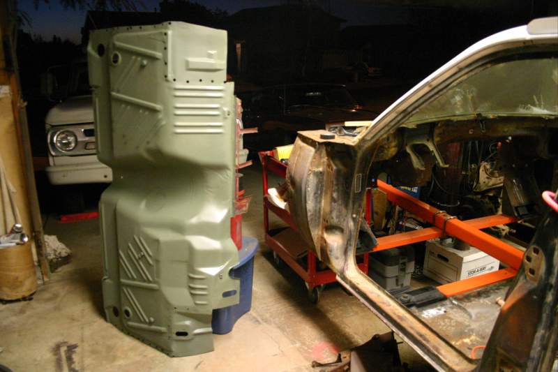

same ones i used. they need some adjusting here and there but will work fine. jnnpjp.JPGfloor2.JPG

PS I still think those patch panels are junk.
Cuz he seems determined to use them regardless so after the chalk line is layed down I want to compare the area to be cut to the replacement panels.
That will show how close or not the replacement panels which I called junk comes to replacing the factory floor pan being removed. You already knew the answer but you had to bust my balls and make me spend all this time typing the response.

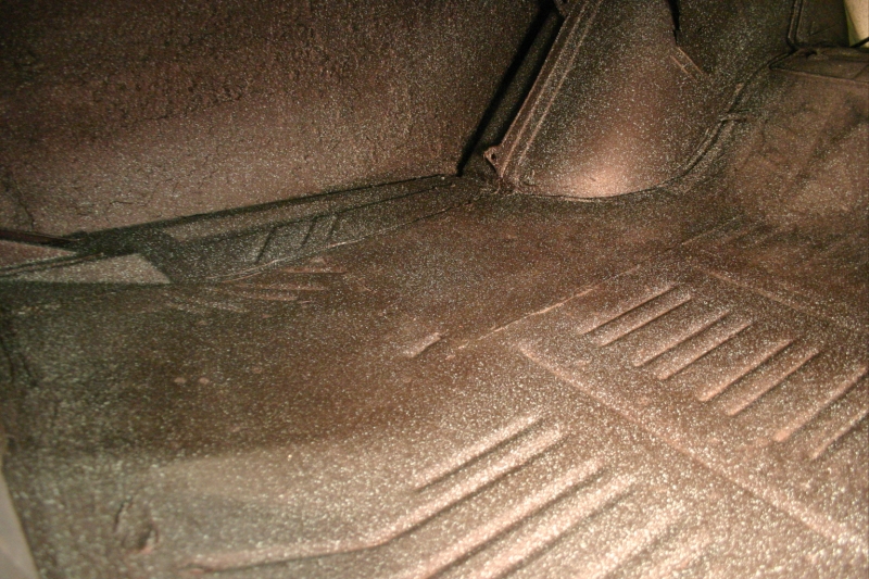

It is hard to show in pictures but the grooves are "V" shapped and about 3/32" deep not even close to the 3/8" deep "U" shapped ones on the factory panel. The grooves are not even close to the same layout and the panel cutout not even close, we won't even get into the forming aspects.

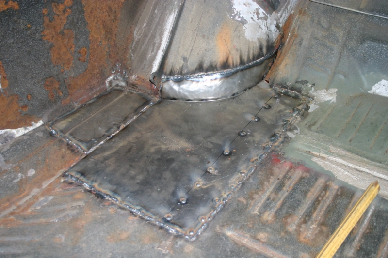

This is the one I got for the trunk, good thing in further evaluation I found I didn't need much and we just used flat stock. I griped and they refunded me the money.
These are no where near close for a "restoration" but for better than nothing rust repair they are fine but for the money at that point I'd just work with flat stock.
