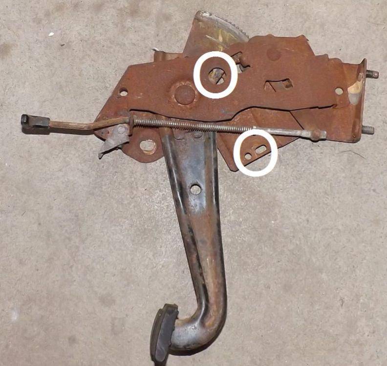

There is a locating pin that lines up with a hole in the side of the brake assy and it just slides out, it isn't locked in at all. Then there is a little nut with a u-shaped bracket that holds the cable housing in place too. You will have to get on your back with a flashlight and have a good look to see what I mean. I will see if I have a picture i can post.
Ok here goes, I have circled where you will find the places to look. The top circle is whee the pin appears when you line up the hole by moving the foot pedal until you see it to get it out. The lower circle is where you will find the bolt and U shaped bracket holding the cable housing in place. Remove that too. BRAKE EXAMPLE.jpg

Thanks for the picture.
Mine looks different then this. I'll try to get a picture of it in the next couple of days. What set me off was the two studs that stick out the front of yours. The one I'm dealing with has a bolt that goes through the front out toward the fender, then you put two bolts in that go from back to front (position very much like the studs.
