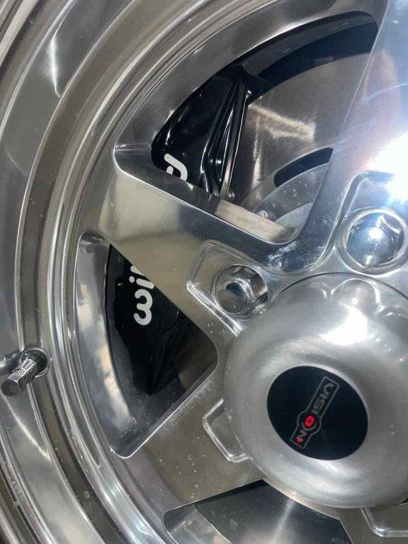

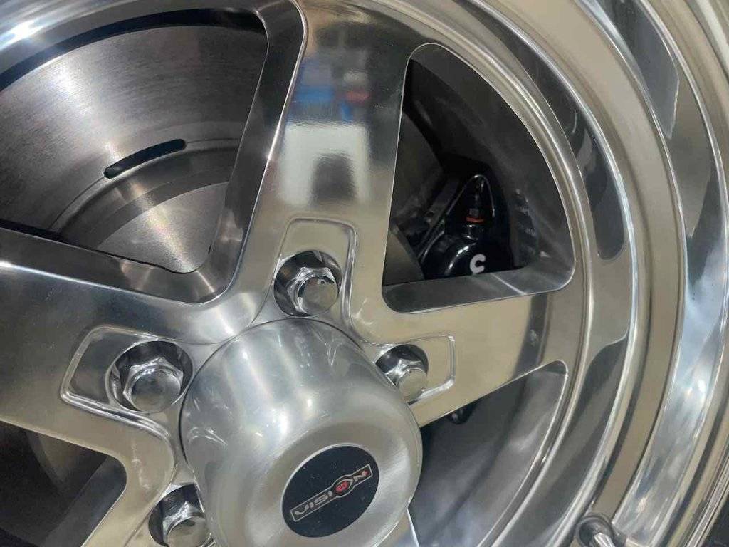

LOL probably gonna piss most of the people off that commented on this thread but I put wilwoods on my 66 SF the beginning of this year and with it being the 2nd vehicle I've installed them on I love them. The other vehicle has had them on for 10 years now and still working great. 6 piston front 4 piston rear with 12.19" rotors and still fit 15 aluminum aftermarket wheels for that retro look I wanted with a wheel/tire combo. Didnt waste money with drilled or slotted rotors since you will never notice a difference unless you are building a hardcore road racing vehicle that your'e constantly getting into the brakes hard. Installed both sets myself easily and can stop the lead sled on a dime now but obviously dont have that OE look. As for the other aftermarket kits I've looked at them and many seem kind of sketchy especially if you opt for the rear disc that uses a parking brake for most non wilwood aftermarket kits.
