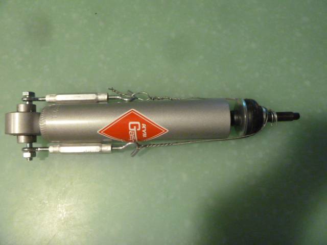

    This is what I did. Same principle with the addition of a couple of dollar store turnbuckles and two washers. Made a potentially frustrating job a piece of cake.

    I use bailing wire. Nice rig w the turnbuckles.
