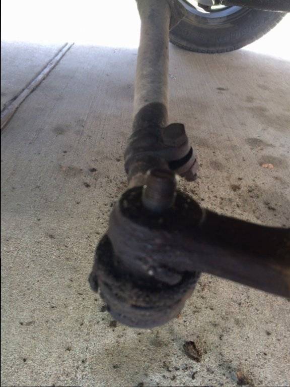

I'm moving on to the front suspension on my 68 Fury. I'm trying to get the tie rod assembly out right now and am stuck.
I've removed the cotter-pin and castle nut, but I can't seem to get the assembly to drop out of the center link and knuckle arm. Do I need a pickle fork or something? I thought that was only for separating the ball joints?
Any tips before I start wailing on it with a hammer?
There is a smaller pickle fork designed for tie rods. Sometimes they come apart with one smack of the hammer and sometimes you need to use the fork to separate them. I would put the nut back on about half way and try giving it a couple of whacks with a hammer before using the fork.

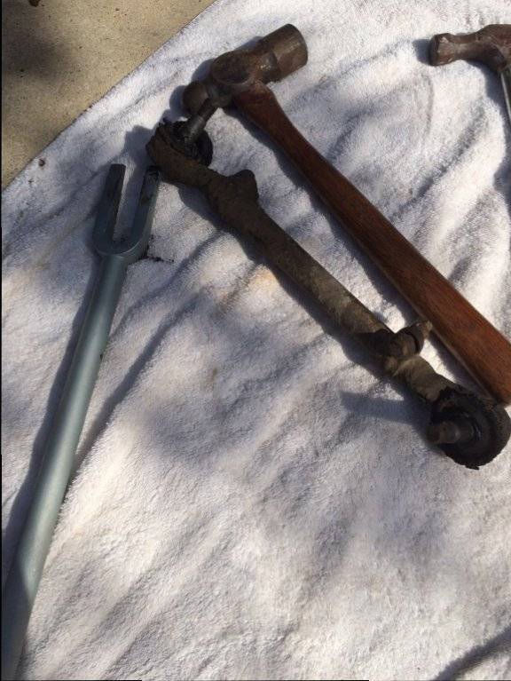

Thanks everyone. I tried putting the castle nut back on about 1/2 way down and rapped it with the hammer a few times - no luck. I went to Autozone and picked up a pickle fork ($12) and that did the trick. I had to beat the hell out of it, but was able to disconnect the tie rod assembly, idler arm, center link. Now on to the driver side tie rod ends and pitman arm.

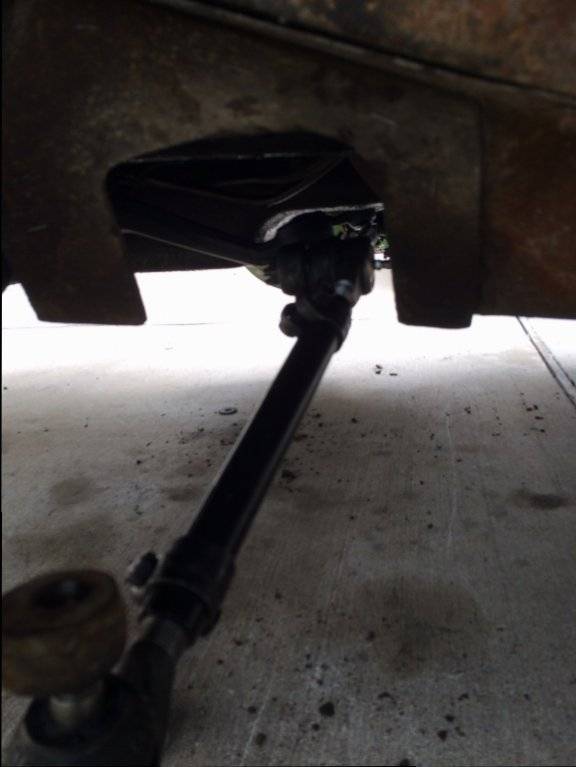

i put a chain around the arm to hold it to break that one loose. otherwise it just flops around with all the rest of everything unhooked.

Lol - Wish I knew that like 2 hours ago! I had that exact issue with the centerlink, idler arm all dangling around with the pitman being the last link.
Ok, I finally was able to get all the steering components unhooked and pulled out of the car. What a messy job. There was road dirt, grime and grease on everything under there.
I was able to use the pickle fork to get the tie rod ends off (inner and outer) but I had to go back to Autozone for a pitman arm puller. I also didn't have a wrench or socket big enough to release the nut on the pitman arm. It's like a 1 5/16 fitting or something. I ended up using a monkey wrench and getting it off.

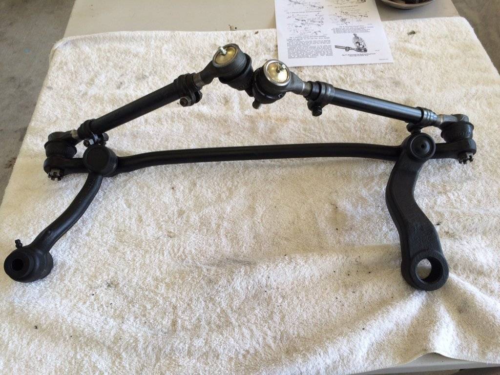

On (hopefully) final update -
Parts dried overnight and I was able to get things hooked up under the car. Assembly was a LOT easier than disassembly. I took it for a test drive and I am impressed. There's no more 'float' in the steering. Also, the car lost most of its' creak/groan when turning corners. I'll need to go get the car aligned next.
Next project is the ball joints and I'm guessing I probably ought to do the control arm bushings at the same time. Is it possible to get the bushings pressed in with basic garage DIY tools (vice, etc)? Or do I need to take the arms to a shop to have them pressed in? I still have to order the correct tool for the ball joint, the one I got was way too big. Maybe I'll save that project for next month.
Here are some pics to share:

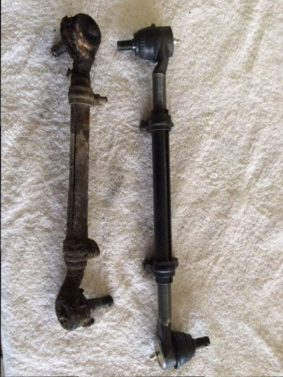

Getting the new tie rod assembly to roughly the same length. Using the old one as a guide.
Loosely assembled in the garage:
Pitman arm and Idler arms are loosely bolted in while I get the tie rod fitment and try to get the wheels pointed straight.

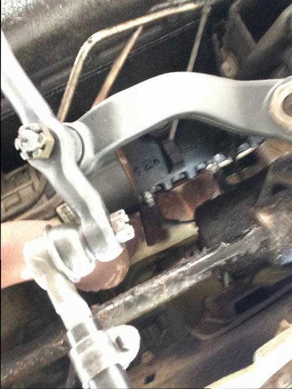

There was lots of back and forth from one side of the car to the other trying to get the wheels pointed straight and the pitman arm locked into the right spot. While the wheels are now pointed forward, the steering wheel is at 3 o'clock. I'm hoping I can pull the steering off and turn it back to 12 0'clock. If not I guess I need to unbolt the pitman arm and move it over a few splines.
One final question. Do I need to grease these fittings? They are Moog components and appear to be pre-greased. I have a grease gun, but didn't know if I need to load up all the joints really well.
The Pitman Arm Spline Nut is 1-15/16" and torqued to 120 ft/lbs. I doubt you'll be able to use a monkey wrench to torque that nut so it's best to get yourself a socket. Since it's a steering component, don't skip getting a socket to torque the nut for safety reasons. The last thing you need is for the pitman arm to dislocate and lose your steering!
Thank you! I hadn't thought that far ahead. I went and got the correct socket and was able to torque the new pitman arm to 120 ft/lbs.
Yes, you do need to grease the joints. Fill them until you see the grease just start to peek out the rubber seal. Looks like you got the RareParts Diamond Series Pitman without the blind splines - is that correct?
If you have your tie-rods EXACTLY the same thread counts as the original ones and you definitely have the pitman installed correctly, your steering wheel should be positioned at the same location before you took things apart. You should have 3.5 full turns lock to lock. If you do, then at 1-3/4 turns from either side your front wheels should be pointing straight (if that's how they were before you dismantled things). If you DON'T have 3.5 turns then your pitman is probably positioned incorrectly.
