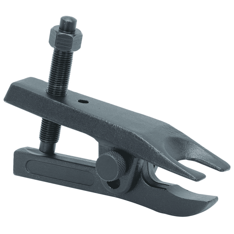

Works great! $20 at HF And some auto parts stores loan them out.

Adding the pressure of a pickle fork, or maybe better yet, that remover that @halifaxhops suggested, with the smack on the side should release the joint.

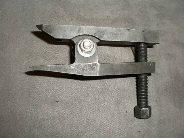

I have looked at this type of puller, but they have never seemed tuff enough.....but, jut for grins, I will get one. I went back this am and tried more heat and hammer with the pickle and nada. So, went to the bin and pulled out two pullers, the first was the small normal kind, short and stout, but turns out it was too wide.....about 1 3/8 span and would slide off half of the arm. So, got out this one that I thought was not tuff enough either. Put it on, and got it as tight as I could draw. Finally added a lot of heat and it sounded like a gun going off when it jumped. Age and pounding certainly had seated this tapered shaft. I am going to try a smaller of the small type claw puller....needs about 1 1/8 opening of the claw jaws. Will try the others on the passenger side, later.

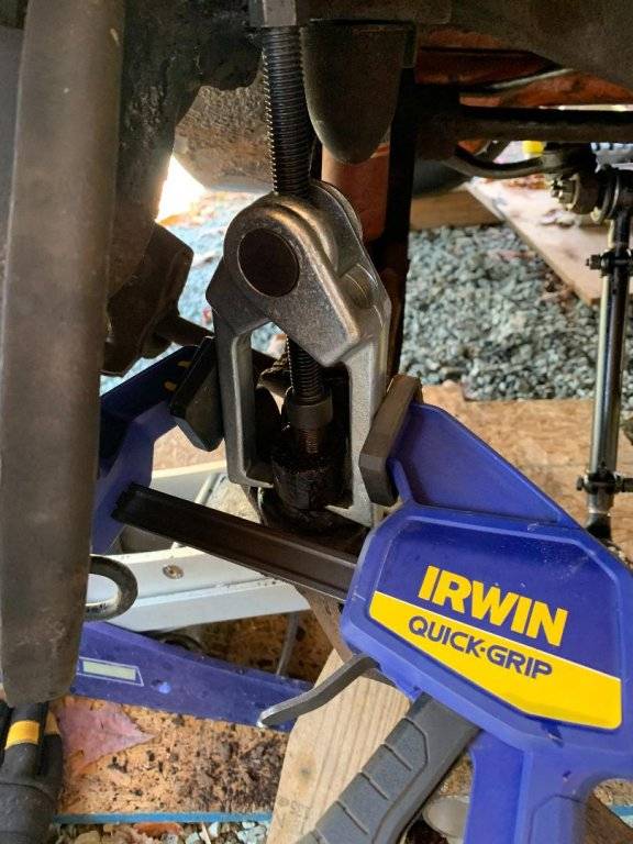

Here is what an air hammer set up looks like. Brace the lower control arm w/ a floor jack or a large block of wood. Have used this set up for 20 plus years.

I just ordered this type tool also recommended above.....and we will see. Also used to have an air hammer with pickle fork attach, never tried it. But, I have never thought to try this one by David, to drive out the stud with air hammer, cool idea. thanks again for better ideas.

I must say thanks to one and all for the encouragement. After the nonsense on LH side, I almost said nah.... But, this type puller recommended by Halifax and also hemi71, worked like a charm. Wish I had tried on the nasty first one, but this second one was simple, did not even really tighten and no heat and pop. Thanks again all.
