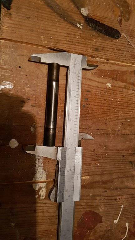

So...the car would not start, no fuel to the carb, figured either pump or filter. Bought new pump and a new see through fuel filter. Removed the pump and the pump pushrod, measured 81.8mm or 3.22in or 3 2/9.
I have no idea on how long the pushrod needs to be or should be??

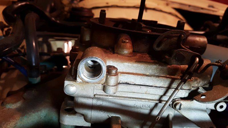

Rod is 3 1/4 long (+/-). If the bowls are empty, the float valves are already off their seats, adding fuel will seat them. You need to see fuel coming out the pumps discharge line. Service manual will give you a time/volume measurement. Remove the line, put it in a small mouth bottle and crank the engine with the coil ignition wire removed to check the value and see for yourself if it's pumping. There is a screen at the inlet to the carb beneath the the threaded fuel line adapter fitting if it's a Carter. Check it for clogging.

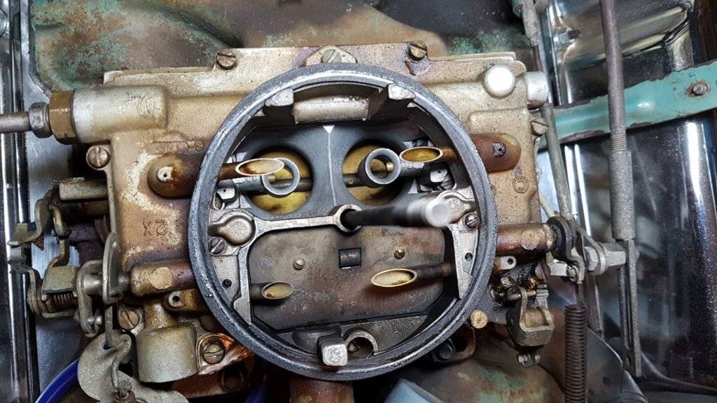

The bowl vents in question should be inside the air cleaner's "ring", where it seats on the top of the carb. The vent tubes should have 45 degree "slash" at the top. Usually one near each of the primary throttle bores. The external bowl vent is open at normal hot idle, but closes when the throttle is opened, by a linkage to the throttle linkage on the side of the carb.
For the record, 2bbls usually have just one, near the center, straight-cut on the top, inside the "ring".

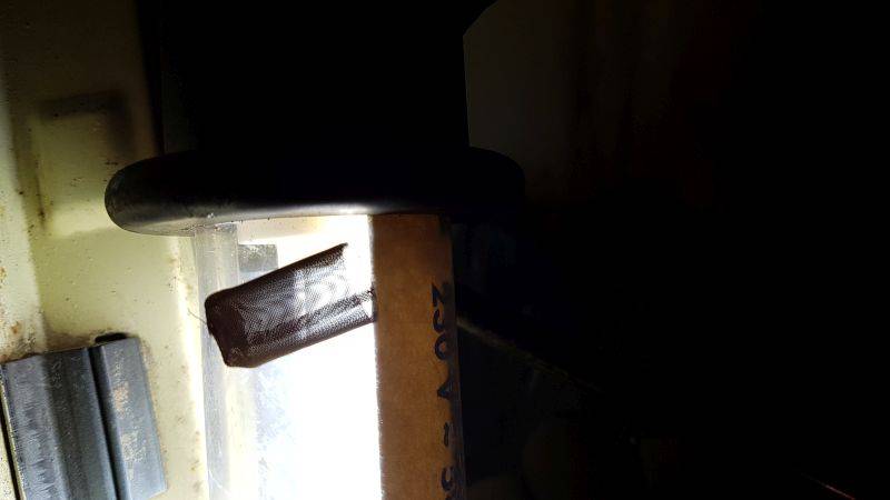

So, continued today. Removed fuel line fitting from the carter afb, removed screen, looks ok. Removed fuel line from carb to pump and blew through with compressed air just to be sure. Put some gas down the bowl vents on the primary side. Opened the choke plate and moved the throttle so that I could see that some fuel squirted....tried to start...no go, have checked and verified spark. Will start for some revolutions with some start gas into the venturi...

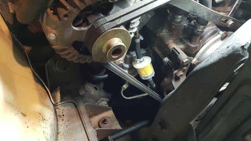

And the pump will not put any fuel into the filter...

Here's a stupid thought...I haven't switched the lines on the pump have I? The rear one should go to the tank right...? Seems logical... Never mind, the fittings are not the same, just a hose fitting to the tank and a hard line fitting to the front...so that can't be it.
