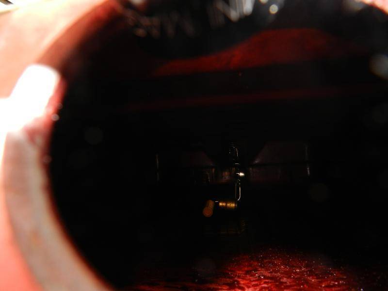

I have diagnosed my fuel tank(68 NYer) junk. This is a real shame because from the outside it is beautiful. When I dropped it from the car it sound like sand and gravel was sliding inside it. When I pulled the sending unit, oh it was nasty. It seems that Spectra has the market corner on these. What are your opinions? Are there any other options?

I just got back from the radiator shop. After showing them the amount (close to 1/2 gallon) of rust and crap that I sucked out of the tank yesterday he advised I get a new tank if one is available. With that said I'm going to get a new tank, sending unit, and filler neck from Vans. I'll post an update once I have all of the stuff in hand.
