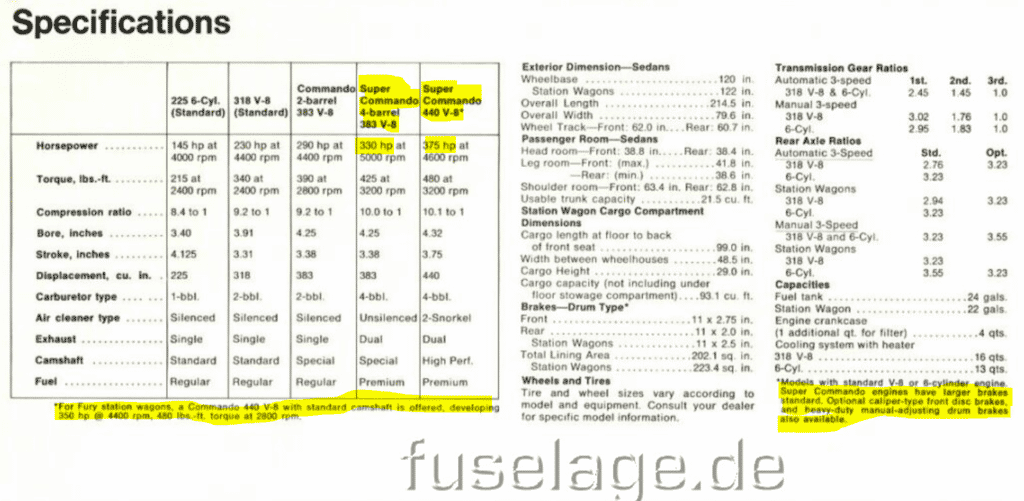

According to the brochure (or was it service manual quote) posted above, yes the 330 horse engine was high performance.
375 horse 440 Magnum is high performance, so is a 390 horse 6pak engine. Pretty sure ALL 6pak engines are stamped HP. I'm not sure about whether ALL 375 horse engines are stamped HP but I have seen some 350 Horse 440's stamped HP and nobody considers the 350 engine high performance.

You seem to be implying that the Super Commando 383-4 was not considered a HP engine. I disagree, although the RR 383-4 was rated at 335, IMO that doesn't mean the Super Commando 383-4 used in Fury's was not considered a HP engine also. From a technical perspective, the 330 Bhp engine had higher Bhp, higher torque, dual exhaust, and required Premium fuel compared to the 383-2 290 Bhp. From a Marketing perspective, Plymouth called there HP engines "Super Commando" and used the red lettered hood ornament on the 383-4 330 Bhp engines so they obviously considered it HP.

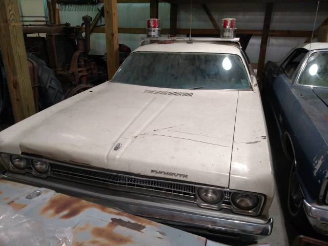

Well I'm a believer some 1969 Furys did indeed hold 383 HP engines. Granted this may only be confirmed by pulling the cam shaft. Here is my weathered unmolested 69. The alternator and air cleaner have been swiped off the car long ago while my friend/ previous owner had it setting out side for 20 years. A few years ago I acquired it and crawled underneath to verify the engine block has the matching serial number to match the VIN on the car. Also then clean off the distributor pad to find a HP stamp. This car has a factory Holley 4bbl carb. I'll don't currently have a photo of the HP stamp or engine on my phone but can take some if interested in more photos.

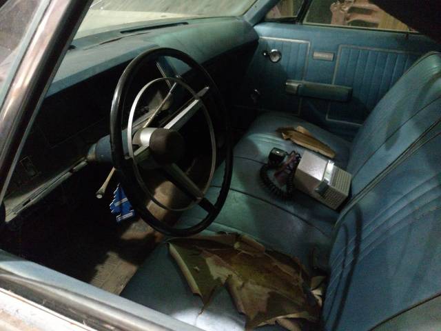

Yes. This is a real Nebraska Fury Pursuit car. Certified speedometer, unit number painted in door jam, reading / front mounted dome light, K-code indicates government car. My old watched it sell at auction from the state impound yard ages ago. He kept track of it and eventually bought it. The car sat in his pasture of 300 plus Plymouths for decades. He was a collector but didn't realize how rare this car may be today. A few parts were stolen off and eventually the disc brakes and HP engine would have been pulled. I was fortunate enough to purchase it and stuff it inside. I'll take more pics of the carb and engine. I've had it buried for some time so I need to breif my memory too. Thanks-you.
I've never seen a Holley on a 383 OEM. Is that a factory cop car?

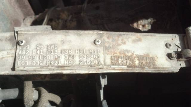

I Googled up a tag decoder. E63 comes up as a 335hp 383...

As shown earlier in the thread, the 1968-1970 E62/E63 code and H/N VIN code simply means the car has a 383-4. It doesn’t tell you the horsepower rating or application as many sources, incorrectly, list. These incorrect sources add to, and continue, the confusion as to what actual assemblies were used in what applications. They do not clarify anything. They treat the A, B and C body assemblies in each year as if they were the same assembly in all applications over three years and they are most certainly not the same assembly.

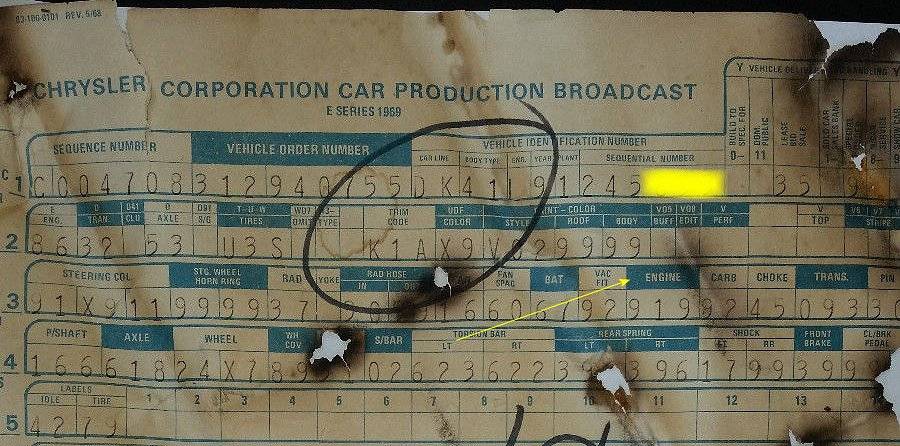

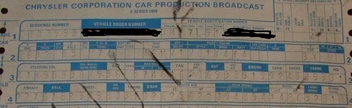

Mopar didn't do anything different with 'cop car' assemblies. They are the same as any other assembly.
"Police car" 440s and "civilian" 440's used the same engine assembly. I would presume 383s are the same. This will be easy to document via the broadcast sheet.
One is a DM. One is a DK. Both are L codes. Both have the same 919 engine assembly code. Same transmission PN.
