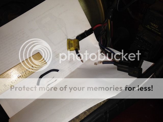

Referring to the photo above, the length of the actual fusible link is buried in the center of the length of this wire...correct? Probably about where the rubber tag is...I'd estimate the original fusible link length that burned up was only about 1" long (see photo below). I cut it out so I know...and BTW I saw solder in there. This whole wire (above) is probably 7" long. Can you please explain why solder can't connect wire to wire especially if the fusible link is ~ 3" away on both sides? Would that solder that's 3" away still change the resistance of the fusible link? If that's so, wouldn't any connection along the length of this wire change the resistance of the fusible link? Wouldn't any wire harness modification at all through the years change the resistance as well? In no way am I trying to argue...just would like to understand. Thanks...
Here's the situation...If worse comes to worse I probably could find another connector/pin to the thick red wire...although I don't own the pin pusher tool for that connector. As far as the bulkhead connector side...forget it. That pin is not coming out...and it's scary how short of "a stub" of wire I have to work with. I've got to make sure I know what I'm doing because I can't afford to lose anymore wire on that end. I am tempted to neatly solder a little extra wire/heatshrink tube it on that end BEFORE I crimp the fusible link in. Then comes the decision on whether to cut down the fusible link wire when I get it. Is the length of the whole wire not critical...but only the length of the fusible link itself? There seems to be a lot of unknowns here....

If you do not have the tools (or knowledge; no dig intended) to properly make the repair, I would take it to someone who does. Also, I believe you have Fusible Link wire coming out of the Bulkhead. There would not be a piece of Fusible Link pieced in between two wires like that; at least not from the factory. It should terminate somewhere with a proper connector (Bulkhead). The Fusible Link is a vital part of the wiring and if you repair it incorrectly, there's a good chance, at some point, you could have an electrical fire. Do you have a wiring diagram for your car? It would be worth its weight in gold right about now.
This is what your fusible link should look like, minus the parts tag. Notice there are two ends that are crimped on. One goes in the bulkhead and one is clipped to the other wire.
You are not seeing solder. What you are seeing is the wire itself. It has probably melted a little from you shorting the wire.
The best way to do this is to replace the wire using the proper end terminals that clip into the bulkhead connector and to the insulator on the end that clips to the wire. Those terminals are a little hard to find and your local Autozone probably won't have them.
The next best way is to cut the existing wire off and splice into the old fusible link wire. Cut the old wire so there is maybe an inch or so sticking out of the insulators and use butt connectors as Cantflip described.
Don't solder.
The fusible link needs to be approximately the same length as the old one when you are all done. Too short and you don't have the protection you should. Too long and you've added too much resistance and may end up burning the wire up again.
