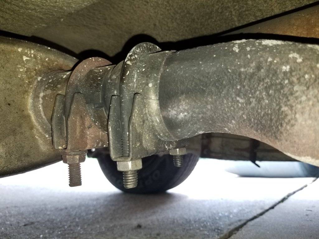

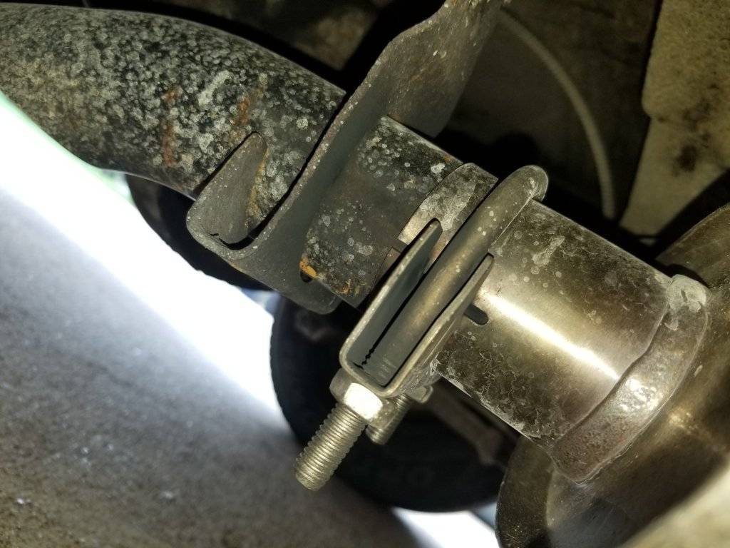

Had a gassy smell in the trunk compartment AND the cabin compartment.
As the other members have chimed in, a gas cap also.
Replaced the fuel sender gasket, smell is minimized, few days of driving after. The fuel pump failed on me.
Replaced the fuel pump. No more gassy smell in the cabin compartment!
Trunk gassy smell may be a rich A/F mix AND a hole in your exhaust system AND a rust/pinhole in your trunk allowing the gassy exhaust fumes to vent up and into the trunk.
If it may be an exhaust leak, look for black sooty carbon near the muffler also.
