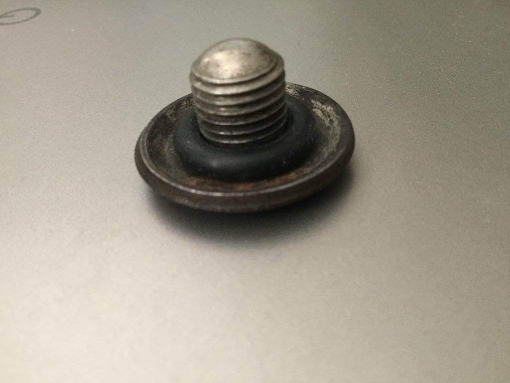

Does anyone have the specifications or even a source for the gas tank drain plug? I gave a new stainless tank and sender for my 1965 Imperial but am hesitant to take out the plug to check and the seal on the one in my car has turned to dust. Since my tank looks clean and still has all the factory undercoating, I may not use the stainless tank and keep the original but need the seal. I thought it was an o-ring but I was recently told that it was a flat washer of some sort. Attached is the plug with an o-ring but it's fairly clear that the plug's design does indeed need something larger. Please advise and thank you!

I had the same problem on my '63 300J, the original seal had rotted away. The plug is made so it will only tighten so much to compress the original oring. I tried some assorted orings and didn't have much luck, either to small or to large and would squeeze out. I found a HELP! brand fuel injection oring kit with several assorted rings and seals. It had one in the kit that was the perfect size ring in it. I found it at a local Autozone store and it was only about $5. The part number is 90100.

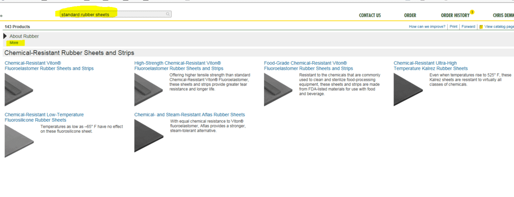

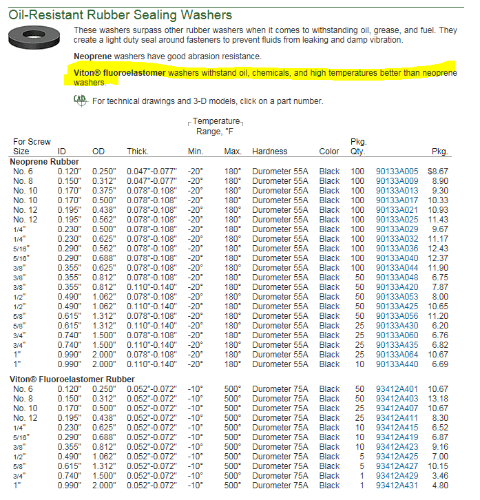

Try McMaster.com for rubber washers, they have some pretty good sorting on features of their stuff.
The bottom pic shows how to choose a material, type in 'rubber' and then hit the 'about rubber'.
You'll hafta take it from here - I ain't gonna do it all for ya! :D

As for McMaster-Carr, thank you for that! As a former journeyman prototype machinist, they were the company I had in mind once I know the dimensions but you saved me the trouble of looking up those available!

An Imperial expert I know has come up with dimensions for the seal:
It is 3/16 inch thick, 7/16 ID, 7/8 inch ID it is made of a rubber like material that is not harmed by fuel.
I revised the above after taking measurements of my plug. The steel part has a flared lip around it, the purpose of which is to prevent over-tightening.
