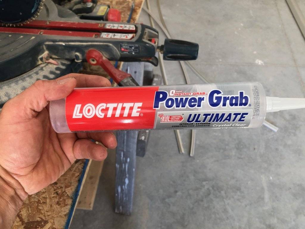

Contact cement works great but you'll be smelling it for awhile. Ive used this loctite caulk on glass and shiny plastics. Firm rubbery when dried, odorless, home depot or Menards. A little thicker than glue, maybe not good for small detail stuff but sticks to anything.
