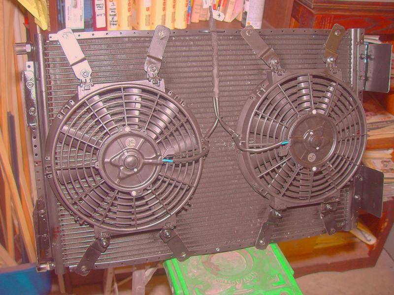

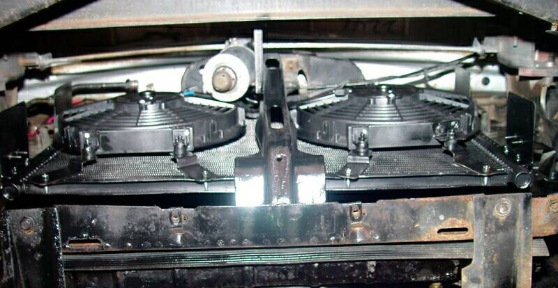

I bought the AC kit from Bouchillion and it works very well. However now that I have seen whats in the kit I will just purchase what I need for my T&C from a AC supply house. Here is the link to the multi-pass condensers they offer: ac multipass condensers - Bouchillon Performance Engineering
I can purchase the condenser for $75 to $90 depending on size. It is a universal fit and required fabrication of mounting brackets.
