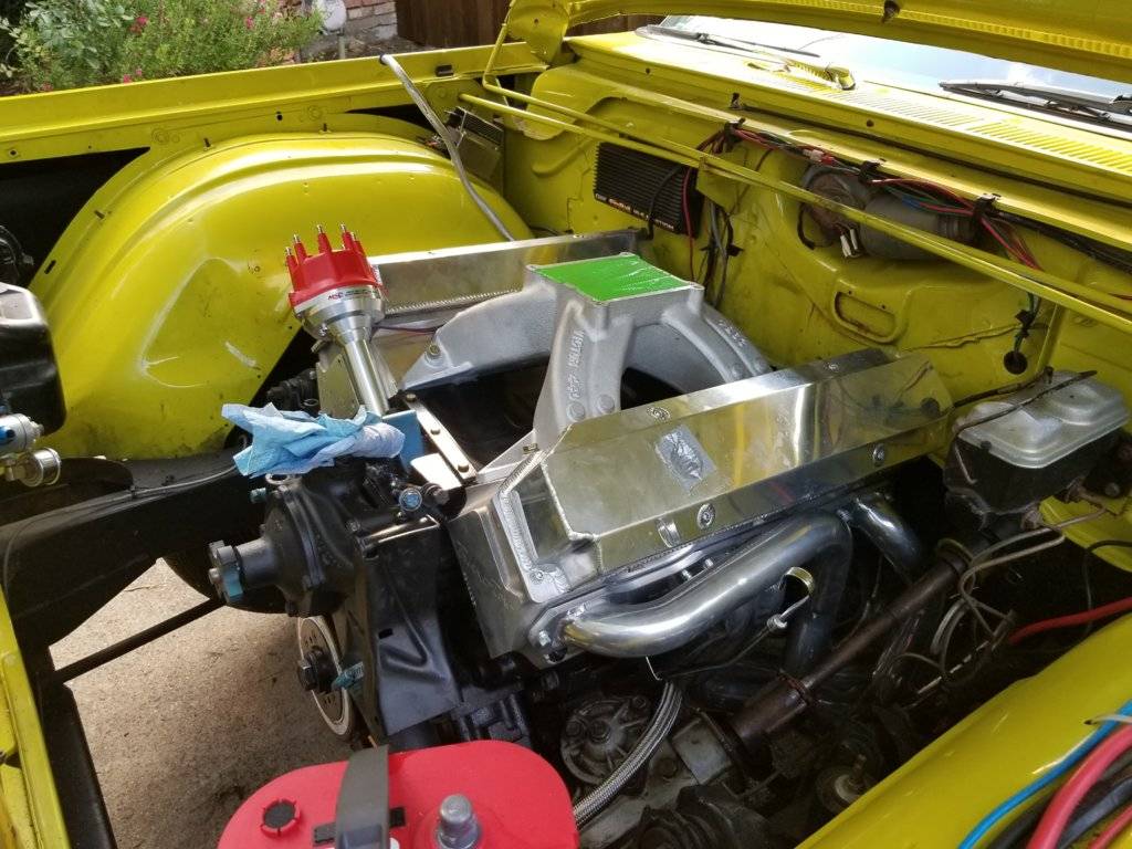

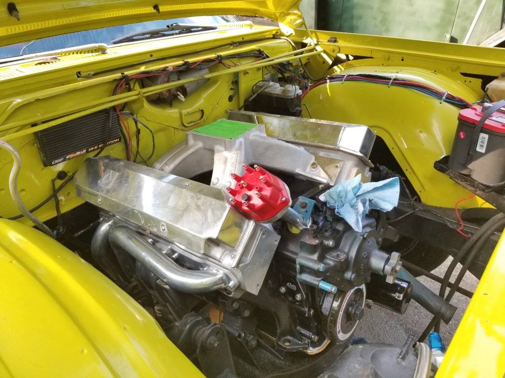

I don't have pictures of them out of the car. Here they are in the car. (TTI's on a '66).

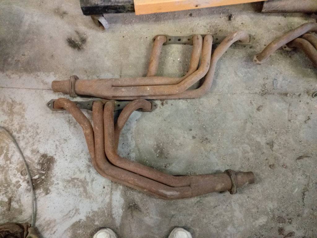

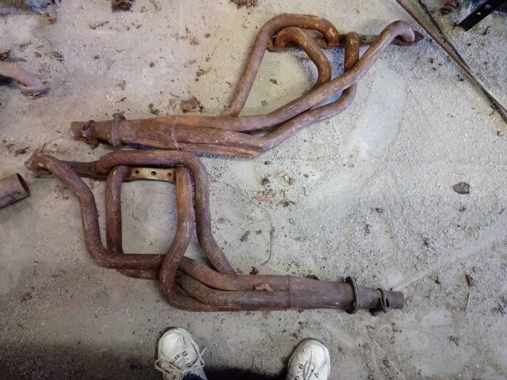

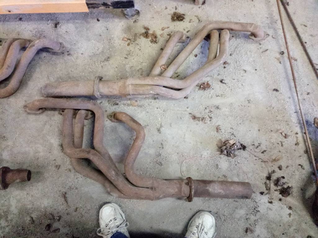

I found a set of headers for the Fury. Actually the guy had 3 sets of big block headers for sale near St Louis and got all three on the cheap as a package deal. Not sure what the others go to but figured for the price I couldn't go wrong. Also landed some really nice 516 heads which had already been updated to 1.74 intake valves, Stainless steel valves, Bronze guides, hardened seats and cut for larger lift springs. Problem is the springs were missing as well as retainers and keepers.
I'll post pics of the other headers to see if you guys might be able to tell me what they go to. Couple of bent in pipes of course.
These are the three sets of Big Block Mopar headers which I got in that package deal in St Louis. There are a few dents in them and surface rust but easily repairable. Going to glass bead blast them and hi temp paint them. Can anyone tell me what the second and the third set fit? I am under the belief that the first set will fit my 65 Sport Fury with 383. Correct me if I am mistaken.
