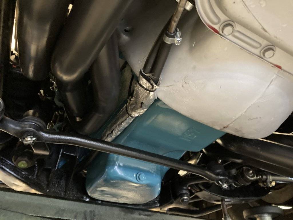

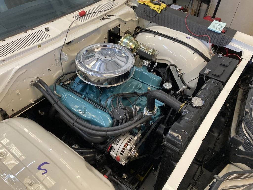

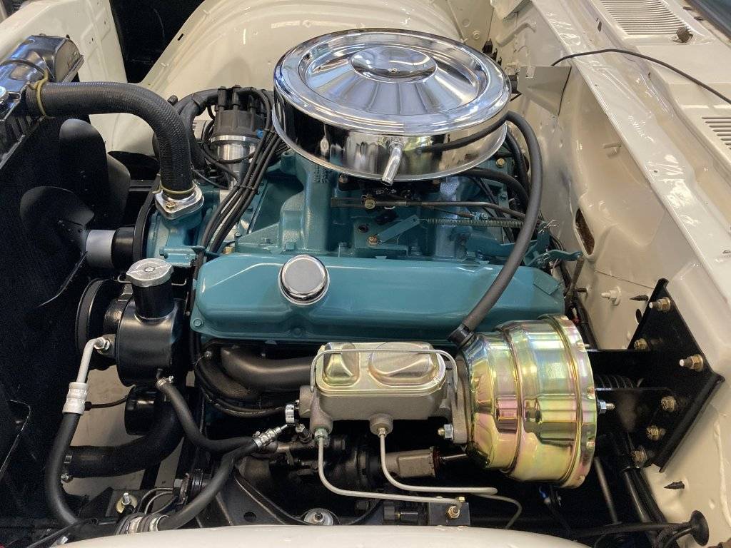

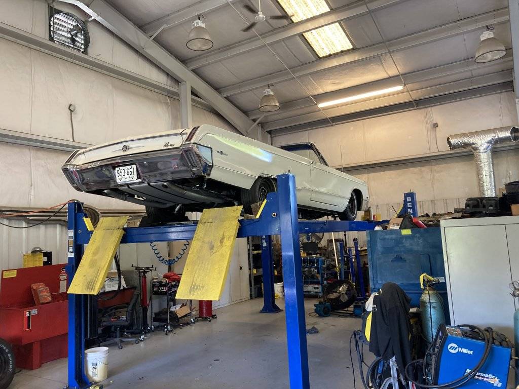

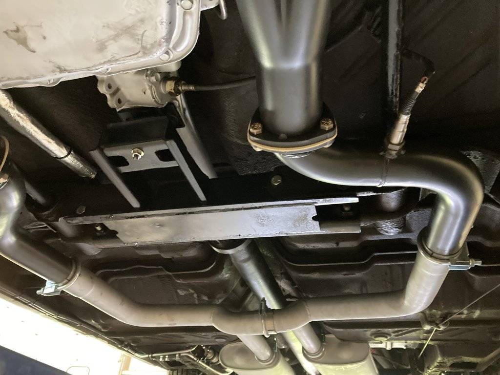

Here are some photos of the 2023 restoration work in progress. Some thoughts: Clearance on the torsion bars and transmission linkage was no issue, but you may have trouble getting the original hard lines for the transmission cooler to fit. Mine didn't. Note the rubber cooler lines in the photos. Otherwise exhaust fitment was straightforward. Hope this helps you with your decision.
_____________________________
With a newly painted black frame and lower firewall, the black headers sort of disappear.
Oxygen sensor for Holley Sniper.
Note the heat shielding on ATF lines. The shop spilled fluid while filling trans; it doesn't have a leak.

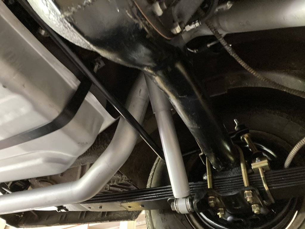

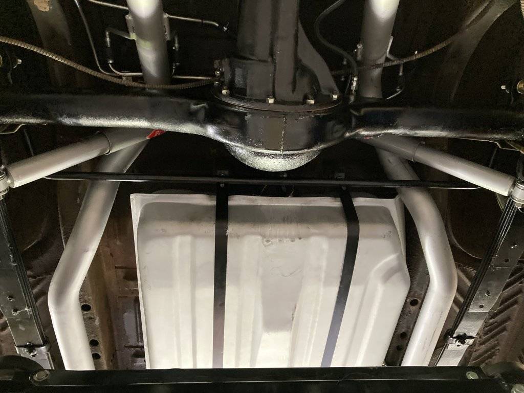

Rear sway bar (aftermarket from PST) is shown here between the shocks and exhaust pipes. It was moved and is now mounted to the body behind the exhaust pipes.

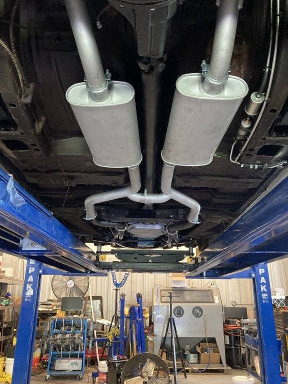

And here's a view of the tailpipes.
