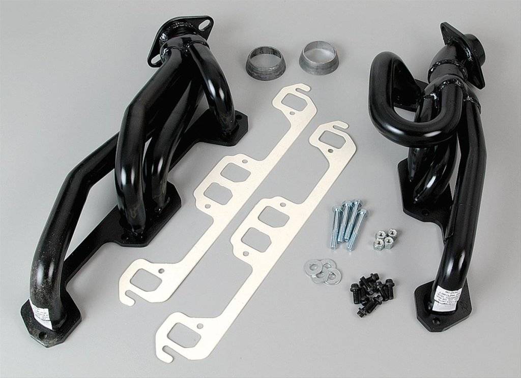

I am wanting to put some Headers on my 65 Sport Fury with a 1974 318LA motor. I have seen some posts talking about the Sanderson DD7 being a direct fit. They are rather pricey. I saw this set of Headers for a Jeep with a 360 motor. Has anybody tried to fit these to your C body? I don't have any info about the Headers.
Are those your headers or do you have to buy them? If you already have them, why don't you give it a try. The worst that would happen is that they won't work. I'll bet no one ever tried it.

Headers for a Dakota with a Magnum 318 work in a C body, obviously a shop would have to make some down pipes. They stay more up and out of the way.

I don't know much of anything about fitment from I vehicle to another. This forum seems to have a wealth of knowledge about these type things. I have not bought the Headers. The guy has them listed for $125. I thought they might be a way to get the job done without spending my great grandchildren's college money.
the back story is that there is an amc 360 that was used in jeeps. you would have to confirm that the 360 mentioned is actually a chrysler engine. even if it is, the likely hood of them fitting is about zero.
That is exactly what I needed to hear. Thanks

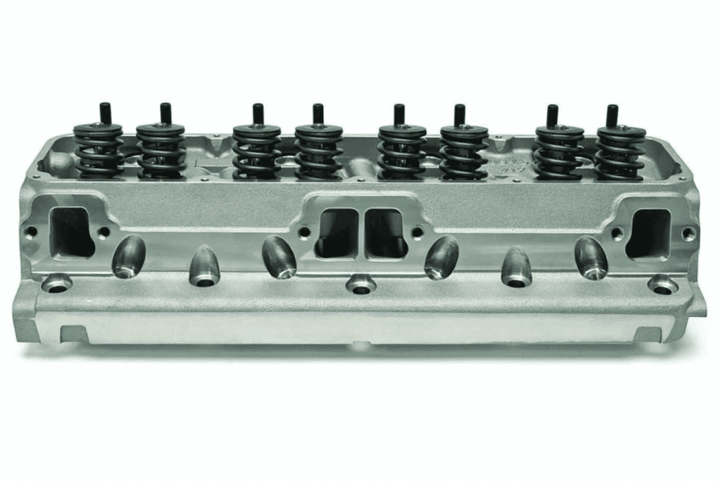

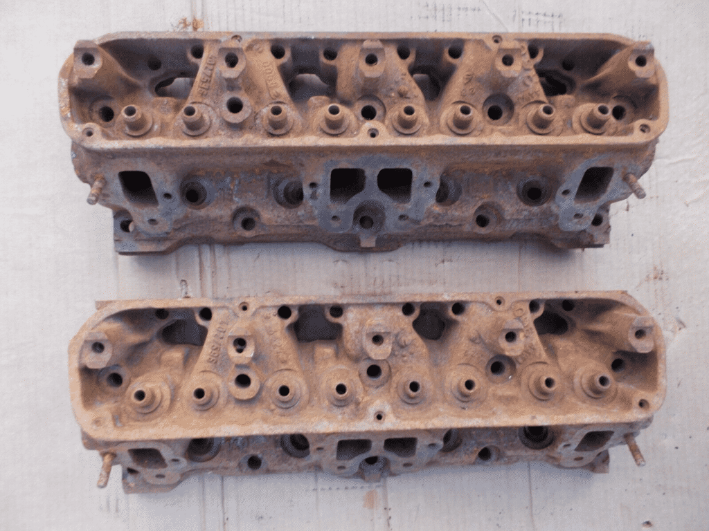

Yep, if you look at the header flange, you'll see it matches the 360 AMC head exhaust port.
360 Mopar heads.

The Dakota headers are a good choice.

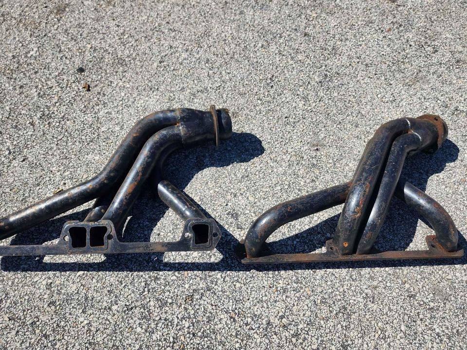

And be aware, there are Jeep 360 manifolds avaialble in the Magnum era too. (bottom pic)
They are Mopar 360 pieces, and they bolt on, but the exits are in different locations. I don't recall any reports of how those fit in a car.
