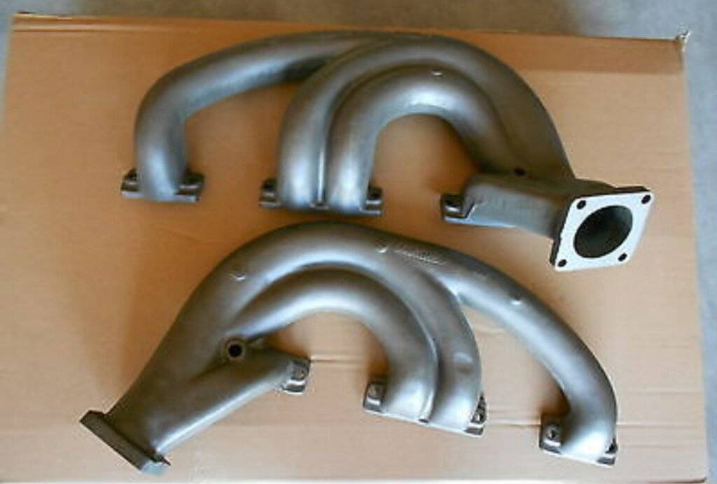

    If you have plenty of $$$$, check out the factory cast iron manifolds for the 413 and 426 MAX Wedge engines, plus the earlier factory hot rod manifolds. Some interesting items back then.

    Max wedge manifolds reproductions. Available on Ebay- $1200

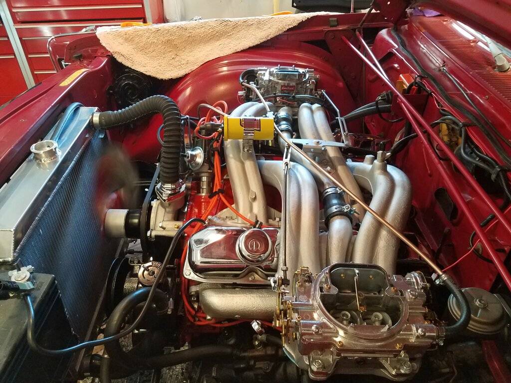

    Gotcha, I have long rams on my '66 Newport and run the stock exhaust manifolds with 2 1/2" exhaust pipes.

    Stock 383 internals with a MoPar Performance "purple shaft" hydraulic flat tapped cam. RPM range is idle to 5800, lift is .450 intake/.475 exhaust. Good vacuum, excellent throttle response and it cruises great.
    The part # is P4529270AE
    Cloyes double roller timing chain and gears.

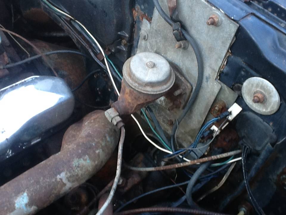

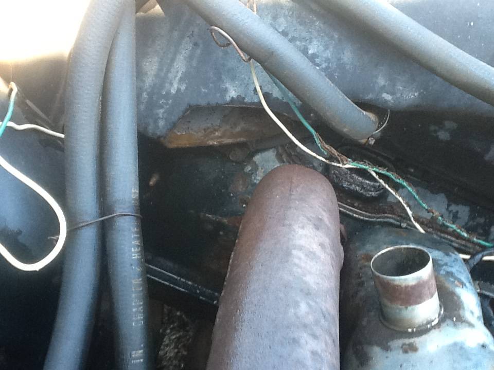

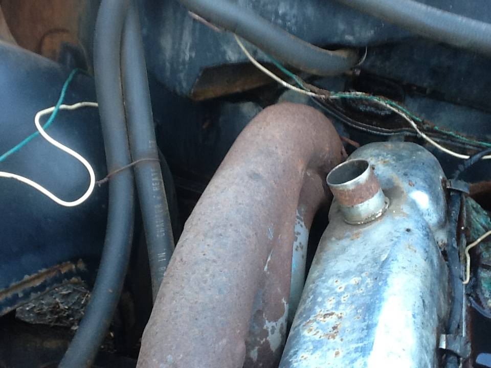

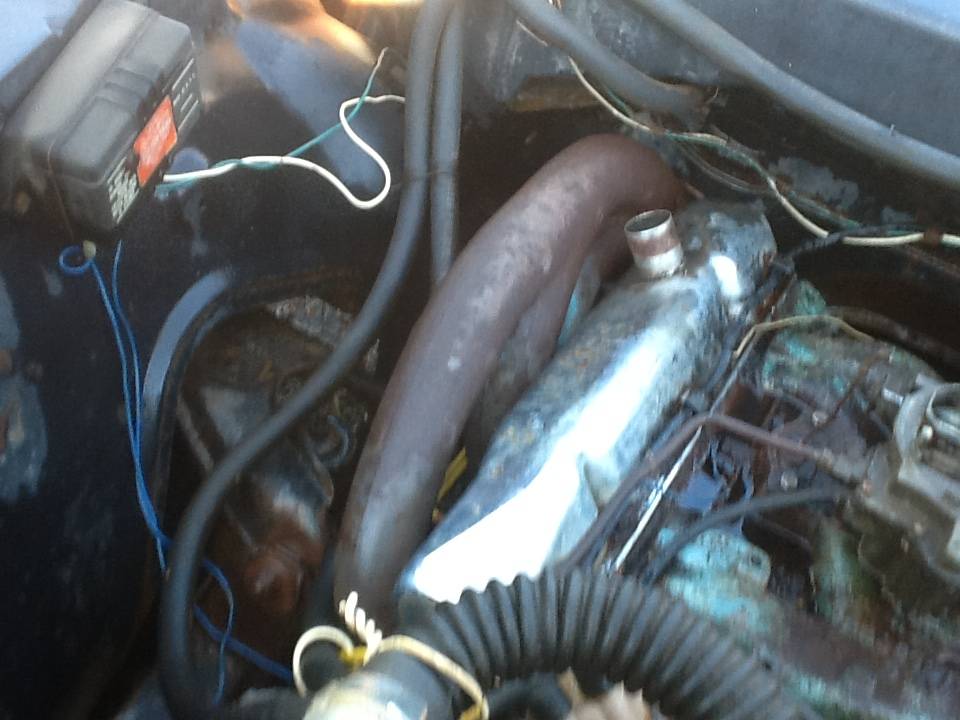

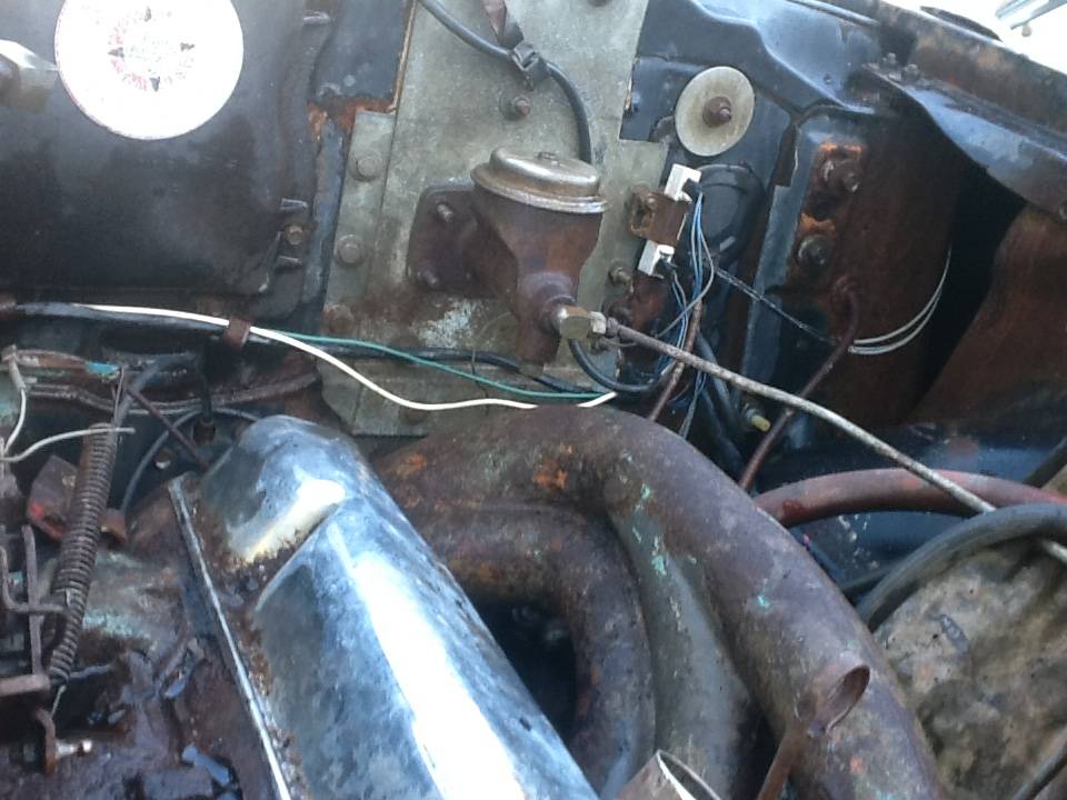

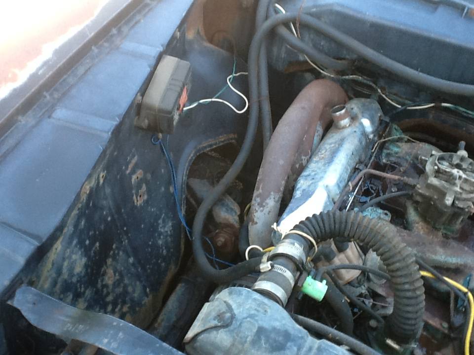

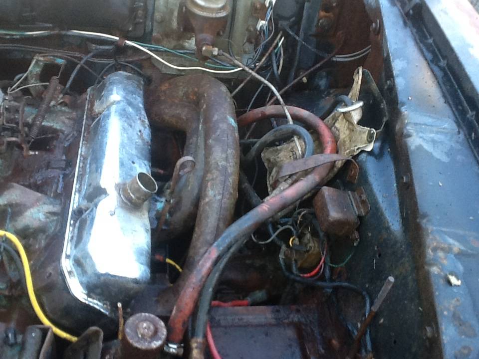

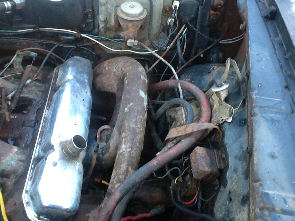

    image.jpeg image.jpeg image.jpeg image.jpeg image.jpeg image.jpeg image.jpeg image.jpeg For anybody interested in using max wedge manifolds on a 60-64 they will work but,keep in mind you not be able to use power brake booster. You will have to relocate brake lines.
    Also the heater box fiberglass is very close to manifold. Note cutoff corner on heater box.
    These max wedge manifolds were on this 61 when I got it.
