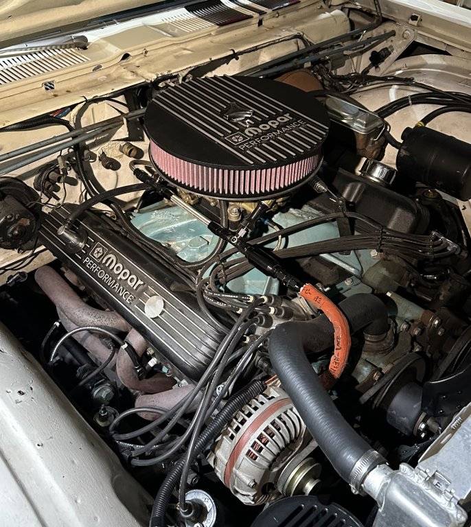

I'm running a 1966 383 in 110 F heat right now with an Edelbrock Performer 600 cfm with a 1/2" phenolic spacer (Edelbrock), an insulated steel tube fuel line with the fuel filter down low close to the pump as Mopar placed it. I time the engine at 12.5 degrees initial and have had ZERO trouble starting this engine this summer due to heat soak. The same motor burped burning gasoline from the old Stromberg WWC late last August, costing me a coil and some wiring, and I decided to upgrade heads, fuel delivery and such then.
A good phenolic spacer is a SUPERB investment.
