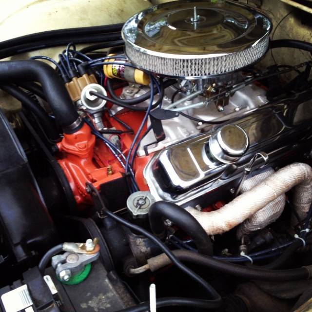

Headers can tend to put more heat under the hood as there is more exterior surface area on them than on the normal cast iron exhaut manifolds. Some people will wrap the header tubes with a ThermoTec heat insulator material to decrease underhood heat, keeping it in the pipes rather than radiating into the air, at that point. There are now kits to do this with. When done, it can look quite nice, although it might take some time to do.

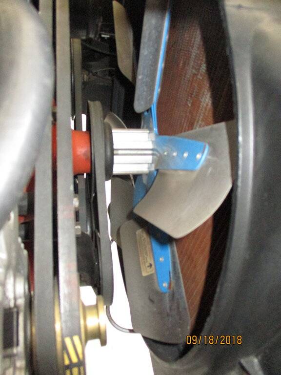

Once, I did venture off into seeking to keep things cooler on the '66. I got a stainless steel Flex-A-Lite aluminum flex fan and spacer to replace the factory fan and fan clutch. After getting the correct spacer length, the fan worked well, but even with the factory 2.76 rear axle, it sounded like an airplace under the hood at 60mph+ on the freeway. The fan was doing its job of moving air, but was making more noise to do it. ONE advantage was that even in 90+ Texas summers, after an hour freeway drive, I could grab the factory air cleaner and remove it from the carb, without any concerns of the air cleaner being too hot to handle easily. It was THAT cool. But no fuel economy advantage from all of that additional :uckily "pull" of air through the radiator, plus the noise, led me to spend less money on a new fan clutch and put everything back to stock (and quietness!). Luckily, I was able to return the flex fan and related items to the speed shop where I got them.

All aftermarket electric fans are not apparently created equal. The fans with an OEM-shape blades will probably the the quietest and more efficient, I suspect. Even so, they probably need to be modulated correctly and be supplied by an upgraded charging system (alternator and battery size) for best results. Might even consider adding a timer into the mix? FWIW

Headers have NOTHING to do with high coolant temps. Underhood temps, yes, to a certain extent. But that doesn't translate to coolant temps that are trying to remove heat from 600* combustion chambers.

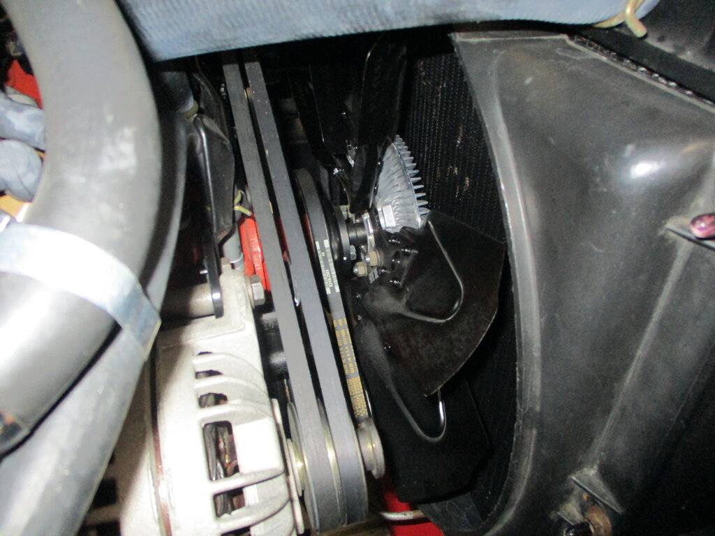

Try this OEM-style kit from Tony D'Agostino. https://www.tonysparts.com/ Quiet and effective. My TNT (with 10.5 pistons) never gets above 190 in Florida heat. And it looks perfect.
You'll need the correct spacer (from somewhere) so the fan is halfway in/out of the shroud.
When Mopar Perf was selling that kit initially, it was great price deal. Factory OEM items, which usually meant "better than the aftermarket". The "spacer" can be avoided with a fan clutch of the correct shaft length, by observation, which kind of negates the price advantage of the kit. BUT if the shaft length you need matches what's in the kit, then it's "a deal".
As for the "race" and "aluminum water pump housing" in the same sentence. A lighter-weight item which might equate to faster 1/4 or 1/8 mile drag racing trap speeds and lower ets? No more, no less.
Enjoy!

Agreed, I did not need a spacer because the setup is correct for an AC car. I mentioned the spacing into the shroud in case someone is using a clutch/fan in different application such as a non-AC car/whatever.
The kit is pricey, but I couldn't click my mouse fast enough to buy it and get rid of the terribly noisy aftermarket, 70's style aluminum Flex Fan that the PO put on the car some 30 years ago. And it didn't cool nearly as well as Tony's kit. And did I mention that it sounded like a friggin' jet engine even at idle?

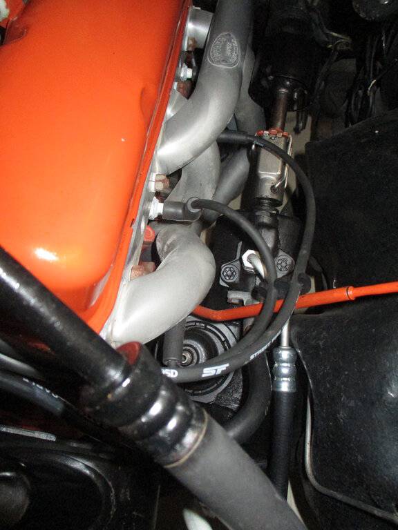

Good to know on the header heat. To be completely honest, my biggest gripe on the headers is ground clearance. And I just think HP manifolds are very nice looking, even though they have their own set of obstacles (changing plugs, cooking valve cover gaskets, and so on).

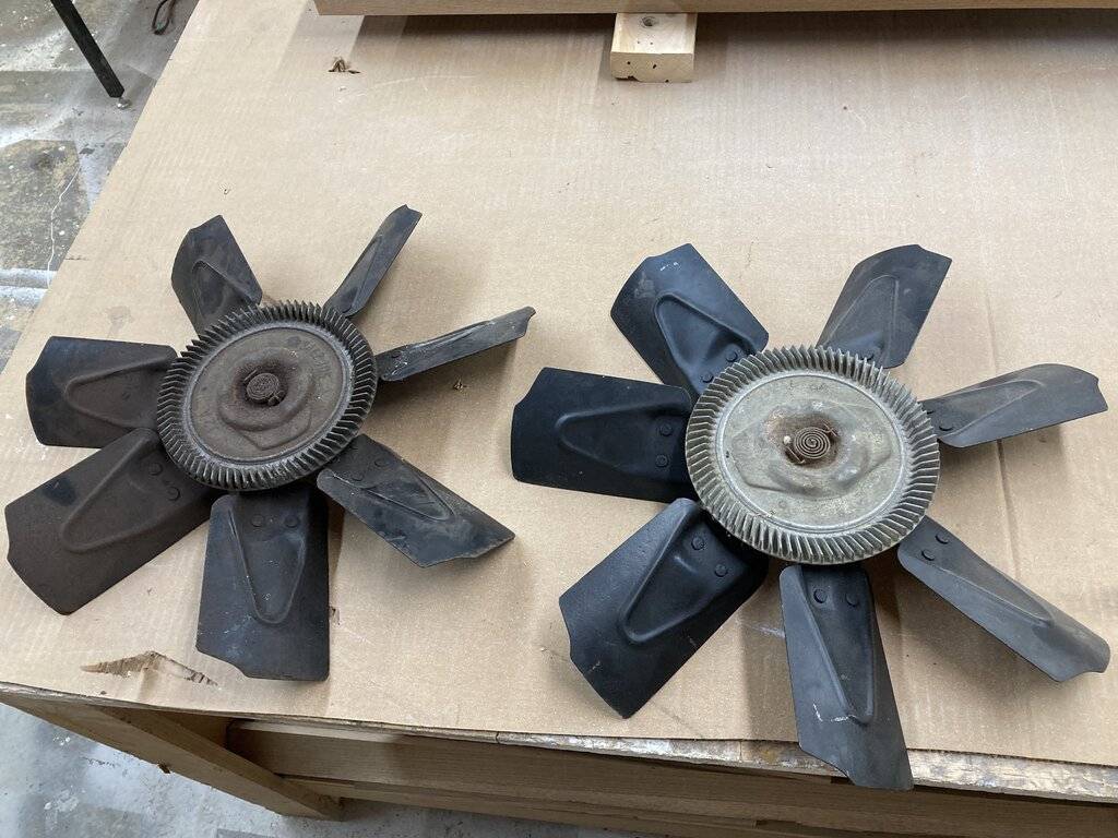

The first 2 are 18” from probably ‘67 Imps, the middle one is a 19” from I don’t know what and the last 2 are oem #216 pieces but they’re not cheap. The prices on the cardboard aren’t for these fans.
I just think HP manifolds are very nice looking, even though they have their own set of obstacles.
Yeah, the HP manifolds are cool looking for sure, but they don't make the power that headers do, if that's important to the owner. But the Max Wedge manifolds make almost as much power as headers:
On the other hand, I think my Hookers look kinda nice, and are a surprise to people when I open the hood to my "hot-rodded" land barge.
