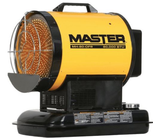

    I was curious about this same thing. The building I work in is a 50x120 uninsulated metal quonset that's about 25ft tall at the center...so there's a snowball's chance in hell of actually trying to heat it. So my only chance is to just try and warm the spot where I'm working. My research led me to think that radiant kerosene is going to be the most cost effective way to be able to get work done during the winter months.
    I picked up one of these yesterday at Tractor Supply Co and tried it out last night for a little while. I was pretty impressed with it. After the initial start up, which created a small amount of smoke, it ran very cleanly. I haven't been around a kerosene heater in many years, but the ones I was always created a smell. With this one, if I closed my eyes I don't think I would've been able to tell the difference from a propane heater. It's also not terribly loud.
    It was only in the upper 40's last night but it heated a reasonable area. I will probably need 1 or 2 more to heat a useful amount of work space. I'm also going to remove the lower heat shield, or maybe even flip it around to the top, so that the heat travels farther before floating up. I'm going to mount it onto a dolly and may also slightly raise the back so the output is angled down a little.

    My cousin has had one for about 2 years now. He said it was expensive but very happy. He runs diesel through his. I have noticed I big difference when I walk into his shop. Definitely not the stink of his old diesel salamander.

    burning diesel in a confined space is not a good idea.

    Not overly "confined" at 50' x 120' x 25' high. Lotta cubic feet there.

    Love the idea of this but...they consume air & produce emissions even if a small amount...
    I would follow what the instructions say.
    Be careful to ventilate accordingly. These were designed for open spaces on job sites.
    Headaches and confusion are signs of CO poisoning. That stuff takes months to clear from your system
    I went with electric for 2 years before installing a proper gas furnace. It cost me quite a bit to run but it was guaranteed safe to use in a closed garage.
    Best of luck with heating:thumbsup:

    I'll only burn K-1 in these, but yes I understand it doesn't matter what the fuel is, flame will consume O and and combination of CO and CO2. I don't see a reason to burn diesel as the cost/gal isn't any better than kero, in fact it may be more.
    This building is pretty "leaky" and it has two vents in the roof so I think I'll be okay, but I have a CO monitor sitting on my desk right now that's going to go in the building for safety.
