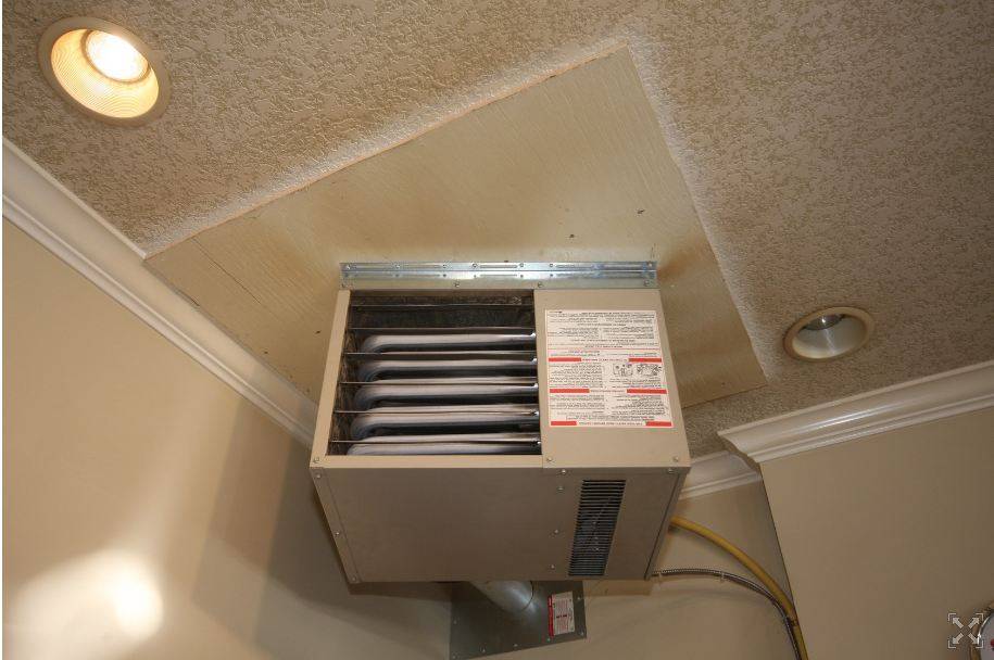

since you have natural gas close by I would do 1 of 2 things. a radiant tube heater in the area you work in the most or a forced air gas ceiling hung furnace. or both. cheapest to operate. installation cost is another. if you bypassed your hydro meter and hydro is free go electric. lolI have a BIG shop - 64' x 38' x 12' high. That's a little over 2,400 sq ft of floor space. It is insulated and has insulated roll-ups and walk-in doors, but no heat or air. This time of year, it's impossible to do the simplest work out there because of the cold.

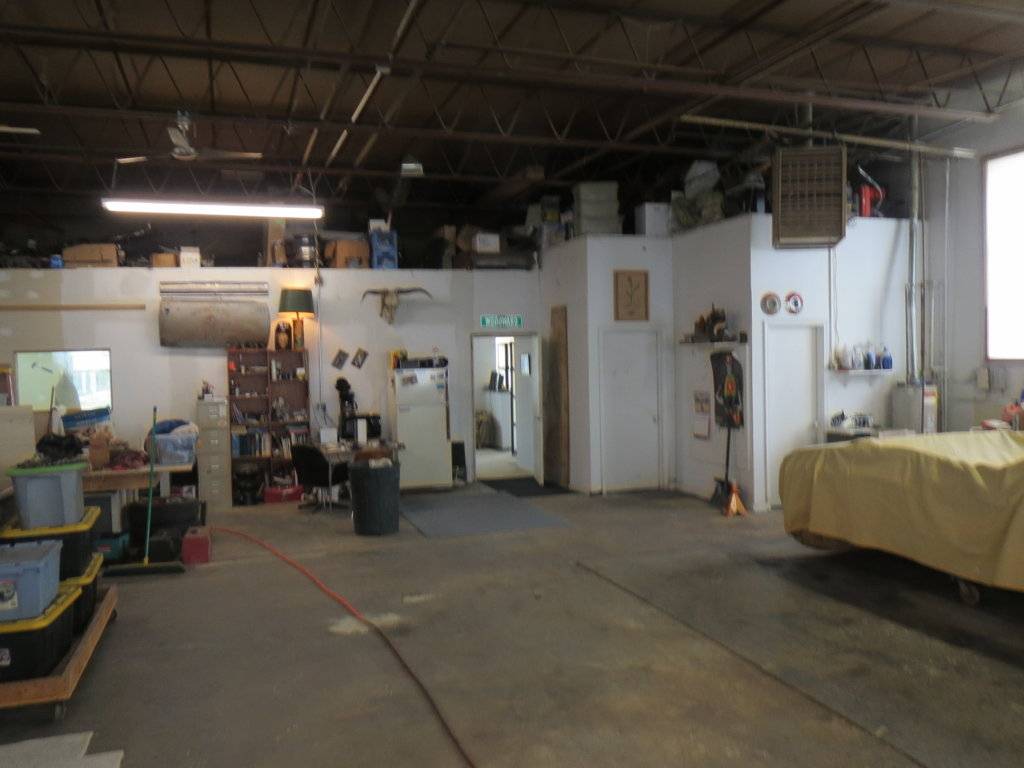

Three car attached to the house. Insulated walls with weather strip around the two overhead doors. The doors are not insulated. The furnace is mounted high in one corner. I keep the thermostat at 50F unless I have big job for which I'll crank it up to 70F. Today it's sitting at 50F while the outside temp is -25C (-13F) and the furnace isn't working very hard to keep it steady.
The furnace is natural gas, about 45,000 BTU

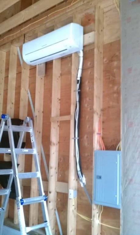

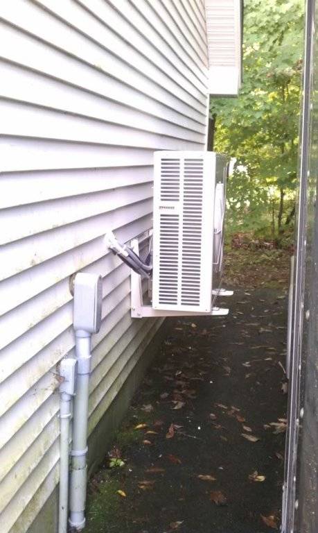

i have installed a few of those, I am surprised it keeps up with your winters?Me?

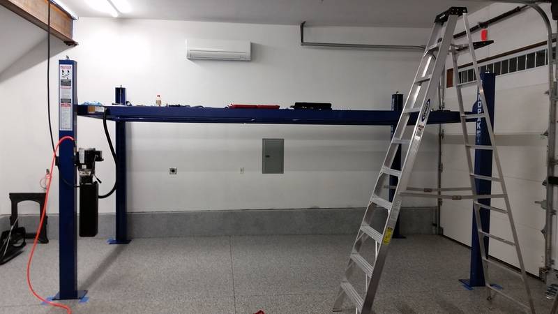

Mitsubishi ductless mini-split Heat + A/C unit. $5,000ish installed, garage is 3-bay (30x24) w/ 12’ ceilings. Fully insulated and drywalled, etc.
Energy efficient, clean, quiet and doesn’t require dealing with fuel or pellets. Climate controlled year-round up in NH.
View attachment 159390 View attachment 159391 View attachment 159392
