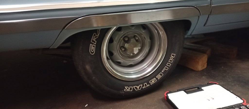

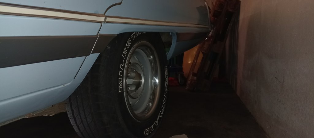

Put the fender skirts back in. Seems to fit.

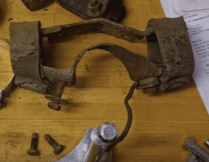

I see that you have one of the correct exhaust hangers -- don't lose it:
Like i said 99% original. Why? I already put it in my "throw-away-box" but could take it out to keep it.
Those are very hard to find. I have been lucky to find and buy several in the past 4 years, but I have not been able to find any recently. For a correct restoration, it is definitely worth keeping -- all the more so that yours is complete with the bracket and bolts/washers. See here for more info and part numbers. Even if you do not use it, someone will -- and might be willing to pay for it.
Ok! I sometimes think i'am posting to much useless pics, but i do this cause i hope that people write things like you did or see mistakes i made and mention them to me :)
I will keep it like i did with the original water pump.

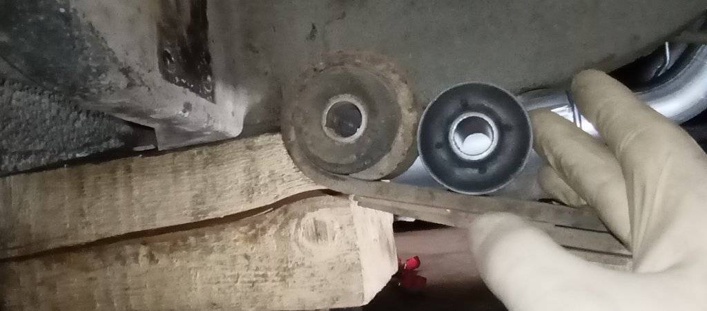

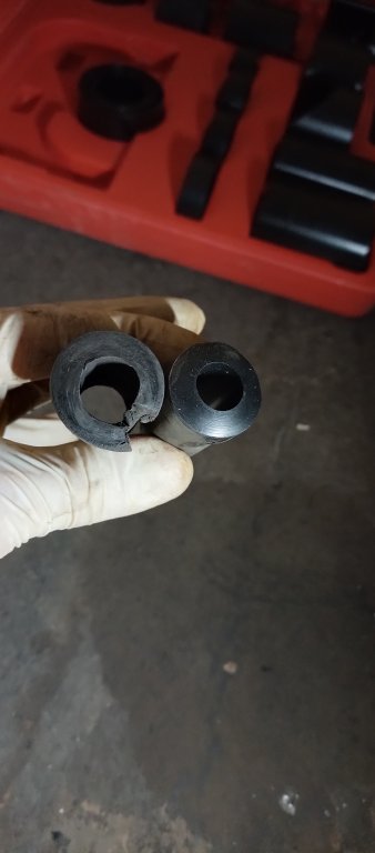

Finally had a few minutes to spare...and failed at pressing out the bushings. At least I managed to get the 4 little rubbers (hard and brittle as hell) changed. Lying under the car i don't get enough force on the pressing tool.
*At one side of the car. Will continue asap... 04/24 starts the new season and there is still a lot to do.
You know how it is... there's always something. Not making good progress at the moment. I can only do bushings once the car has been moved. I changed 4 rubbers, but because the axle is a little too far to the right when lifting it with a jack, I couldn't get the screws in :/

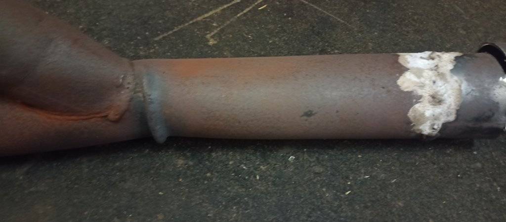

So. Finally made some progress. Yesterday after 2 evenings of work I finished welding the exhaust (flange turned). Worked quite well. Work could be nicer but...

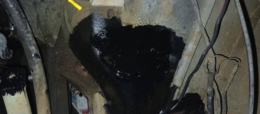

Hole under battery plate also closed. And the best? The Moparshop shipped the shift linkage and the correct bracket for the exhaust today!! Plus an original trunk key and a seal ring for the rear axle entrance. Let's see what kind of act this will be...

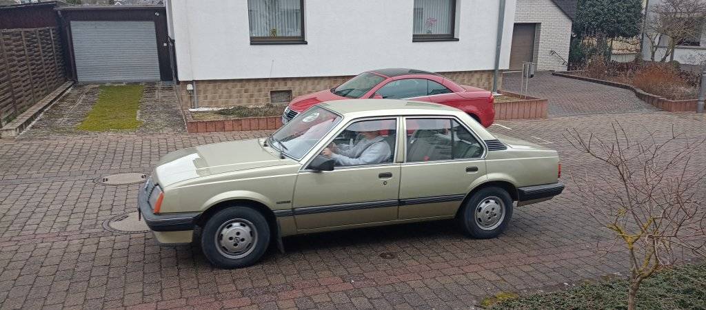

And worked on his car (1986 Opel [GM] Ascona C 1.6L / 98cui).
