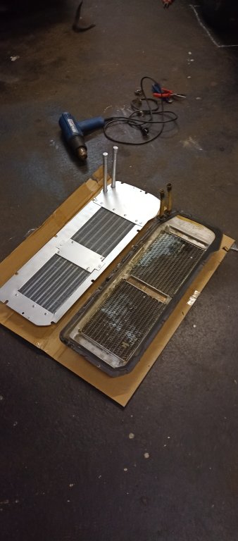

I've read this hole thing: Exact Replacement A/C Components Now Becoming Available for Our C bodies

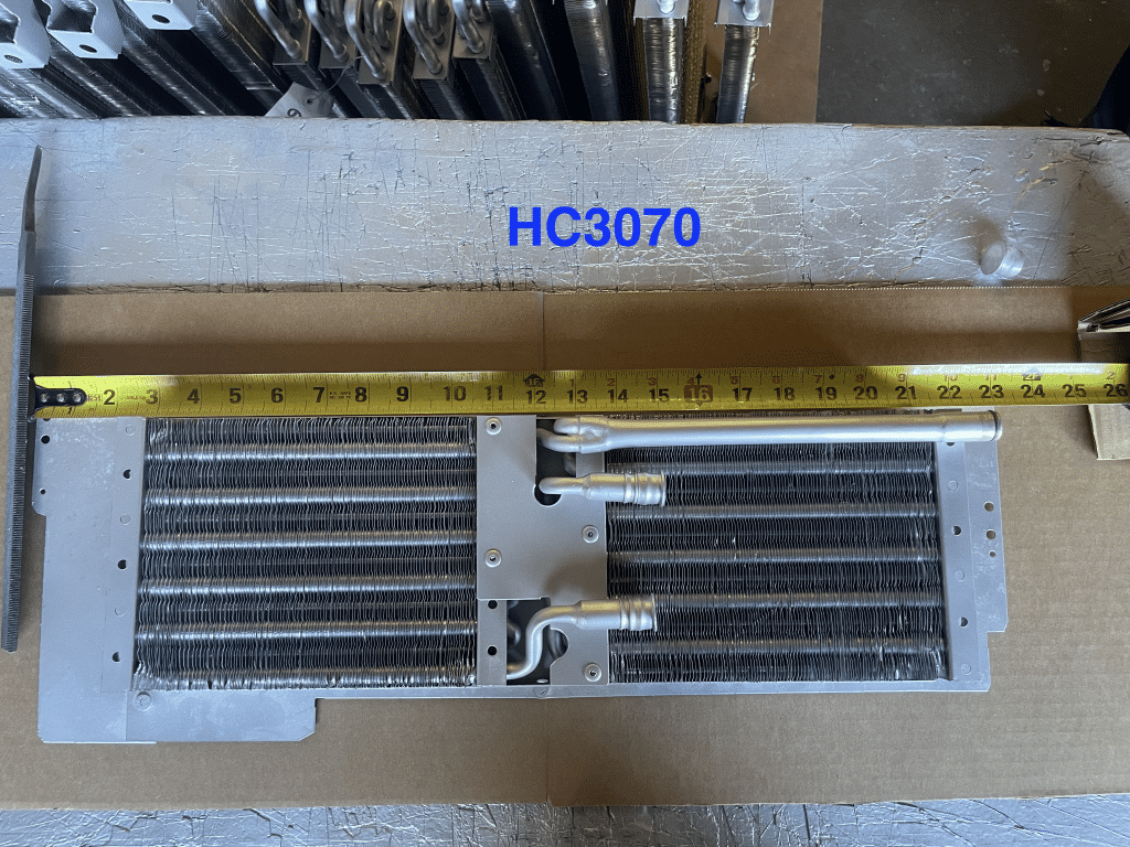

@saforwardlook you made me feel like I was not crazy and I want to thank you for that. Before posting on the forum I went through my fathers achieves of messages, returns and samples but could not narrow things down enough to make sense of why it would work for some but not all. My father would just make changes as samples came in thinking he might have missed something previously but they were still wrong. That's when I decided to do the research on the comments you all made. I am wondering if I should to get a few of the different boxes and see what differences there are on the evaps to see if we can modify them to fit in multiple applications without much modifications. If that is something most of you installing these would prefer.
As for the HeaterCore I thought those were finally correct as we modified those and have not had a return since 9/2021. Although I might have the applications incorrect. I am including the vpictures as well.
HC3070 I have fits: 65 66 67 68 69 70 Dodge Plymouth Chrysler A/C Dual Heater Core Coil
HC3071 I have fits: 62 63 64 65 Plymouth Dodge Fury B Body with factory air AC heater core
HC5777 I have fits: 69 70 71 72 73 Chrysler, Dodge, Plymouth A/C Dual Heater Core Coil

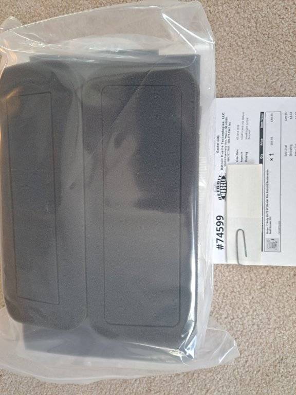

Removal of the blower housing under the hood will help you in the reinstall of your heater box later. If you haven't already order a set of foam gaskets from DMT, ( @detroitmucletechnologoies). They don't cost that much and will greatly improve Air direction flow and performance.

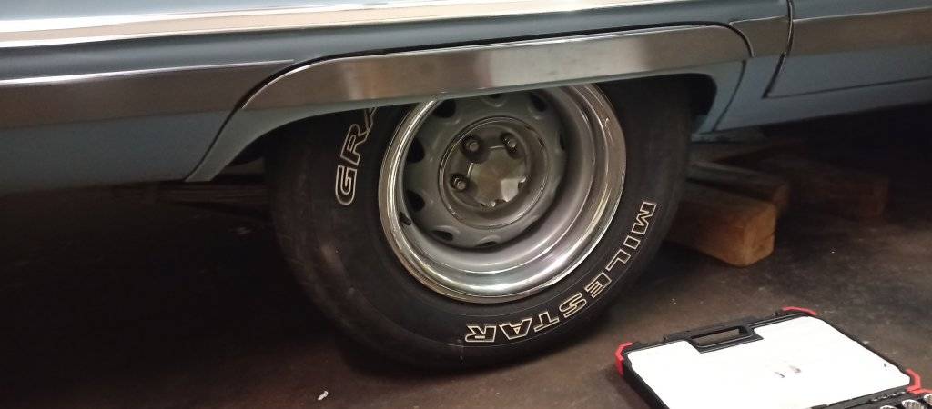

Just a question...are this Barracuda Rally rims on my NY? 8x15
Just had a hard fight to get them out of the car ( to proof the balance).
The wheel style is a 72/74 B and E bady whell, those wheels are likely from Wheel Vintiques an after market supplier that will make original style wheels wider. to help with removal lift one side at a time, remove fender skirt and then let the wheel roll under the drum inward. I found that has helped when I need to get wide wheels off. Your shocks might be B/E body length, they are too short. I found that most listings for C-body shocks are too short, I went through that with my Imperial. I started with the factory part number and did some cross checking and well, here is the post about the shocks. See post #19

Is that the shock you have on your NYer now, 22.5 ext?
You should go the longer shock, 24" KG5413 KYB rear. KG4507 KYB front. Install 72 dodge pick up truck rear brake flex hose to allow max drop of axel to remove wheels easy. The listed c-body hose is too short and when you lift car the hose gets stretched.
Front are mounted KYB 4507 after reading recommendations here.

- Mopar C Body 69-73 AC Heater Box Rebuild Restoration Seal Gasket Kit 95§

I've decided to get the heater box together this evening and recondition it when i take a look at the AC next winter. I also will keep the old heater core...just in case :D

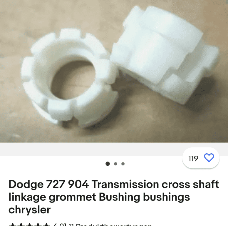

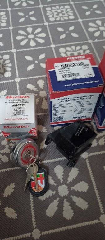

After reading a lot about bad gas mileage I decided to buy an lockable tank cap. People recommended this as a cheap step to check if it's loosing gas over there. Engine mounts...hoses for the heater Core. And linkage bushings.

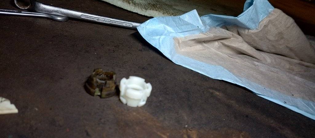

Linkage bushings was definitely time!

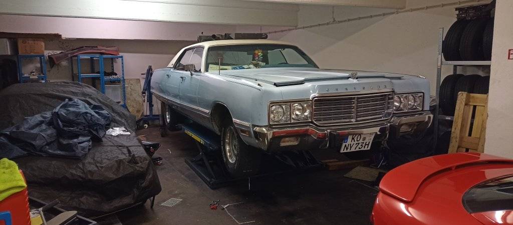

Ant how the h*** I had lived through the past 10 years without a lifting platform??!!!? 2,2 tons no problem:)
I thought of buying one of those lifts, but I mostly slide under car from the sides when working and figured the lift would be in my way. How are you liking the lift?
I Wish i had bought one years ago to stop sliding under the car from the side. But I couldn't afford it.
Exhaust work could ne done with it. Rear axle also. Front axle... maybe not. Engine: I worked just in the back of the car yesterday.
The lift brought it up within seconds! Costs about 1900$ incl delivery.
Did the test with a pretty low Opel calibra. Worked fine. Lifting high max. ~ 3,28 ft
The lift is mobile and can be moved to every place in the garage.

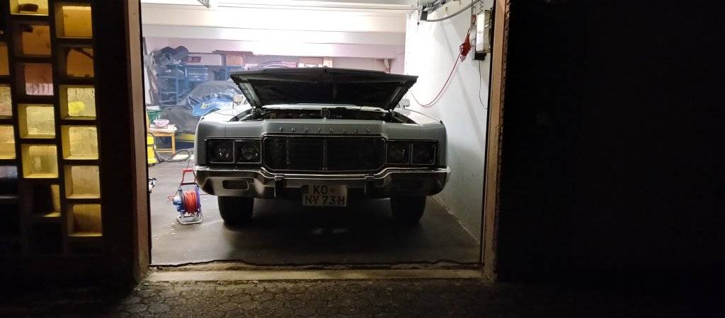

Things are a little quieter at the moment. I'm waiting for the splash shield set and the seals for the heater core from DMT. Meanwhile I change the sway bar and strut rubbers. From March 7th the Chrysler will be back on the road. I'll change its seasonal registration to a normal year-round one. I have to check the fluid level of the power steering, fill up the ATF oil and put back in the heater core at the end of march.
After sitting in the garage during the winter y tried to start the blue battleship...we'll it fired up at the second try an less than 30 sec. Runs good.
Have to fill up ATF oil today and power steering fluid. Than back in the road.
ATF filled up car running, N, hot.
But power steering doesn't works. In German cars you just turn around a few times left and right and it's done...Mopar?!
