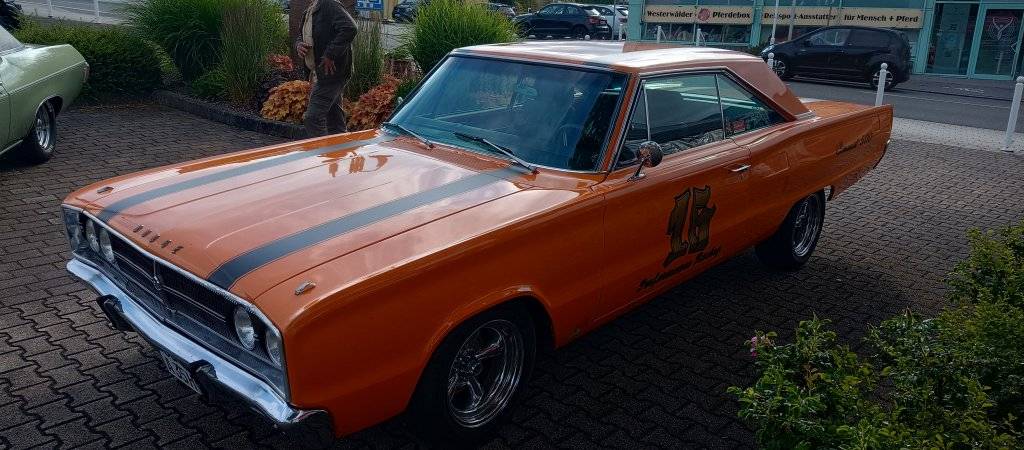

1. US car Meeting in Ransbach-Baumbach, RLP, Germany. Bad weather, just a few old cars. Most of them Mustangs. Nearly 0 Mopars.
But I fall in love with this black "beast". 6,4 (390?) Hemi 2500 RAM HD Power Wagon

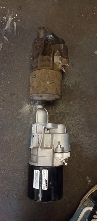

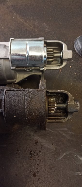

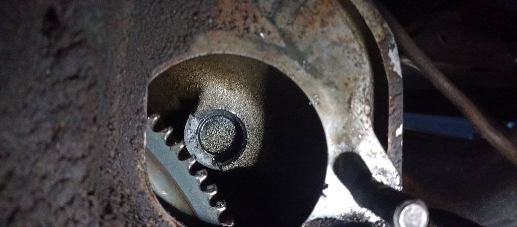

So it was time for a new starter... urgently time. Very urgent. 20% of the flanks have already been eaten away! It was still running perfectly, mind you...

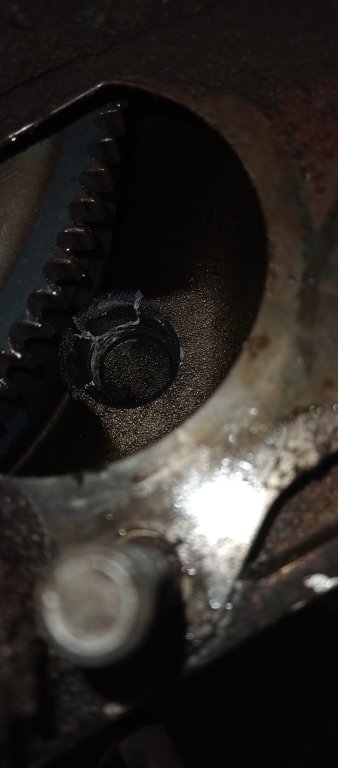

And what you DON'T want to see... :hypno:

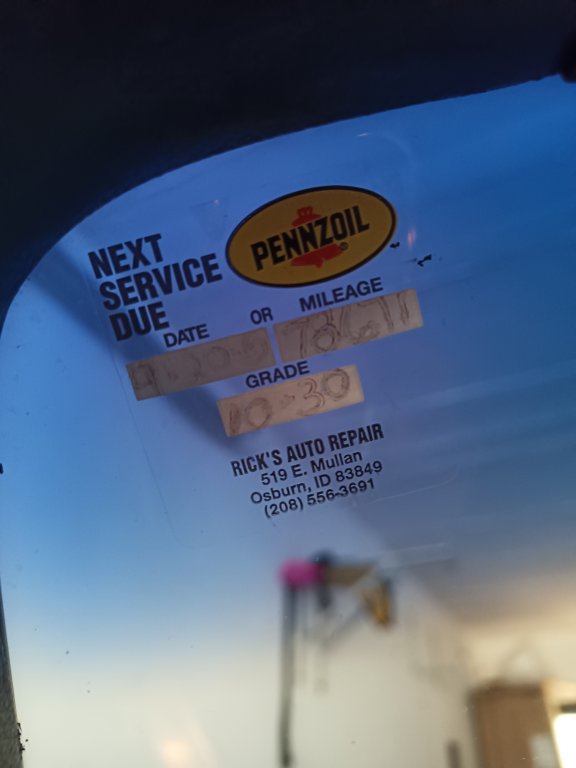

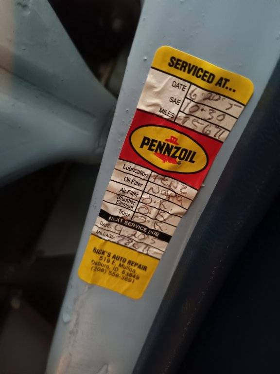

Still not much happening. The last US service of the New Yorker. 9/ 2015 in Osburn Idaho.
Wrong oil I say (10w30). Not it has 20W50.
Not so much the oil weight, but the zinc content. So I'd say get some good classic car oil in there. Castrol has classic engine oil. I think Castrol is easier to get in Europe.
After getting a little bit into this oil think i recognised, that the German 20W50 classis oil i use is made for European cars for which the content of 800ppm zddp is enough. @ayilar convinced me in going much higher. So further I will use MOTUL CLASSIC OIL 20W-50 with about 1460ppm. Thanks for your advice!
As discussed, zinc is important but so is viscosity. I’ll let experts like @CBODY67 @saforwardlook and @david hill chime in.
Back when VW was having cam lobe failure issues with its engines, the ones which run a high-pressure fuel pump off of a cam lobe, seems like the API SL rated oil was the newest standard they approved of, which is 1000ppm zddp in a synthetic motor oil. Castrol makes such a 5W-30 motor oil (black bottle) that is not "Dexos Approved" (which is now closer to 900ppm zddp).
The Amsoil syn Z-Rod oil is approx 1400ppm zddp, as Valvoline VR-1 syn or dino, hits that same area, too.
In the USA, whenever you get of of the usual viscosities of OEM spec oils, then higher zddp levels can result. But this can be variable. Especially since there are many "supercar" engines which use an oil heavier than 5W-30 these days.
The OTHER area where wear is decreased with a 1400ppm zddp oil is bearing wear! Lake Speed, Jr. has a video where he compared the normal, current Castrol GTX 20W-50 to the Castrol GTX Classic 20W-50 and bearing wear decreased by a good bit. I have never seen any of the "Classic" oil on the shelf, so it might be an oil to order. You can check his videos on YouTube. His latest gig is with Total Seal Piston Rings and his YT channel is "The Motor Oil Geek". Some videos on the Porsche Club Website, too.
For some reason, he recommends NOT to add a zddp additive to any motor oil, as it allegedly will not "mix" with the original oil. Plus as calcium levels are decreased, the zddp effectiveness can increase. Lots of little interactions that are involved! So finding an oil with the higher zddp levels "from the factory" as always best.
Enjoy!
CBODY67

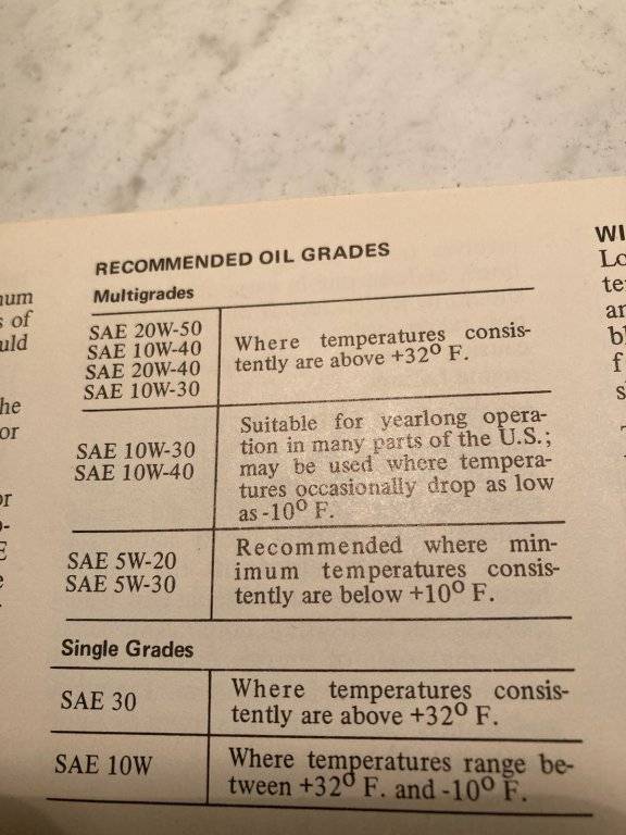

I have found the most reliable information on the use of various oil viscosities comes from the vehicle owners manuals, and here is one example from a 1972 Polara/Monaco owners manual that is placed in the glove boxes at the factory:
Since I reside in Southern California I usually use the 20W50 oils year round since it is very rare/almost never for temperatures go below freezing, I use the 20W-50 grade of oils in my older cars. I also believe it is important to use an oil that has anti deposit/wear additives. For example, if I use the Valvoline VR1 racing oils, they are low on anti deposit additives so if I use that brand I do make sure I get the engine up to normal temperatures fully and drive relatively long distances when I take my cars out but I also change it more frequently. The 50W when the engine is warmed up helps minimize engine wear when the cars are driven hard at/near full throttle.
Thannk you @saforwardlook ! I read this in my manual to and because I only drive in summer I choose the 20w50.
The biggest Mopar (only?) commercial seller in Germany sells the above mentioned Motul oil. So I think this will be the right choice over here.
