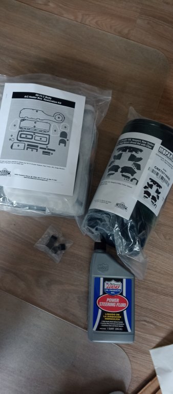

I love watching new parts arriving. Freshly delivered from Detroit Muscle Tec. over Moparshop Germany.
Thank you for your advice @david hill !!

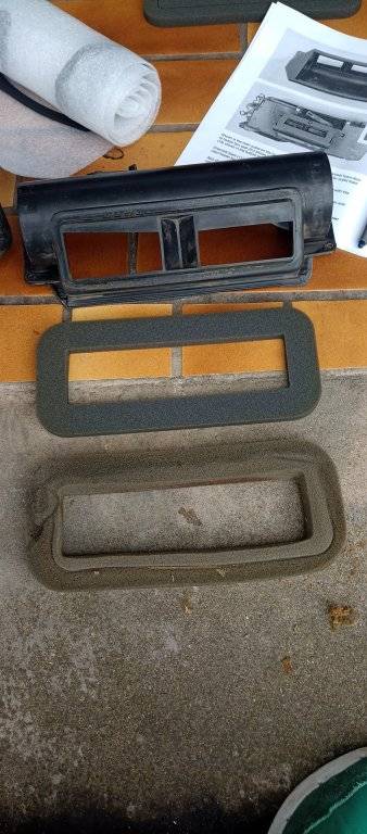

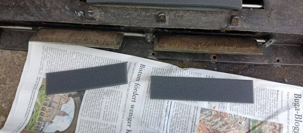

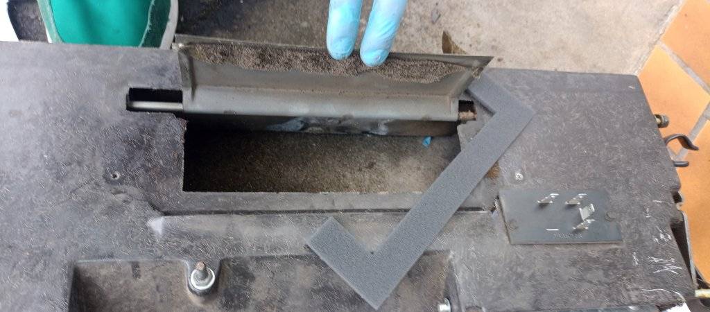

Removal of the blower housing under the hood will help you in the reinstall of your heater box later. If you haven't already order a set of foam gaskets from DMT, ( @detroitmucletechnologoies). They don't cost that much and will greatly improve Air direction flow and performance.
Soon I will mention it to you if this set fit's the '73 models @ayilar
I can confirm for a fact that it will fit 1973 full size models including 1973 New Yorkers. Repaired @73 New Yorker heater box about a year ago. The seals were a perfect fit.

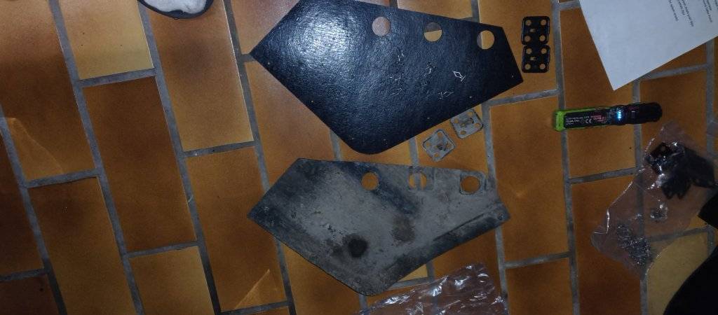

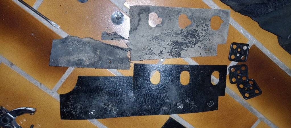

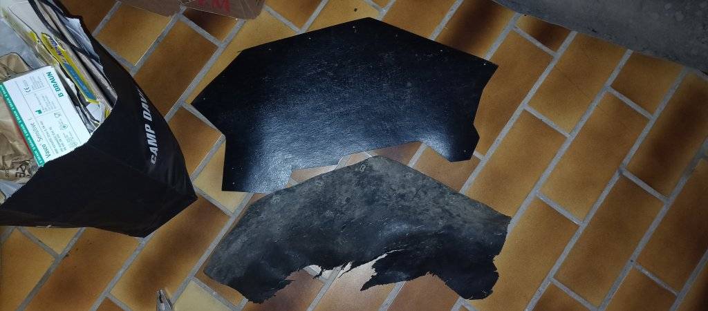

I didn't pointed out clear what I meant. It's the splash shield set on the right of which i'am not sure if it fits. It's listed for 69-71.
Started to put them in.
#1: fits perfect
#2+3: fits perfect
#4: fits perfect
#5(big one in the front): will fit, but holes have to be aligned. Doesn't fit directly.
#6+7: Not included in the set, but worn.
#8-10: fits.
To be continued...
This one i can't match to any place in the 73 NY. "2 dog leg shaped pieces wrao up unter frt bumper on both sides
The 2 pic shows something "starter splash shield".
Any ideas?
Found one answer: Mopar C Body 65-71 Starter/ Auto Linkage Splash Shield
Seems like the 73 NYB don't have this smal ones from factory. But i will later on check if it fits despite this.

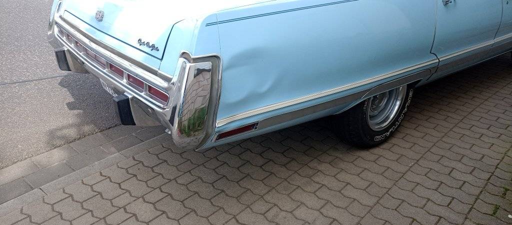

Today is not fun...the big boy had it's first documented crash. Minor damage, insurance pays...but i'am angry of myself...
Very sorry to hear. How did it happen?
1. May 2024. Me and the "Schlachtschiff" @Neuwied Germany Car Meeting.

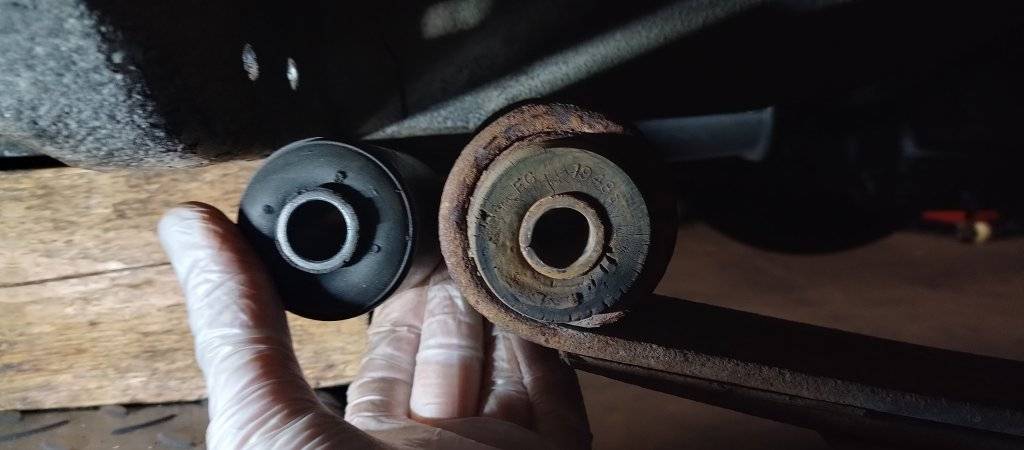

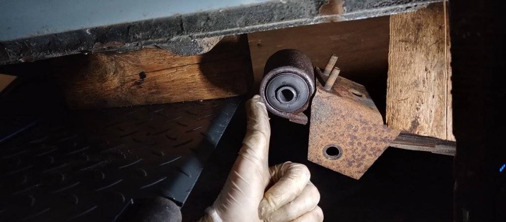

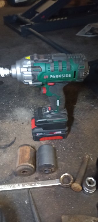

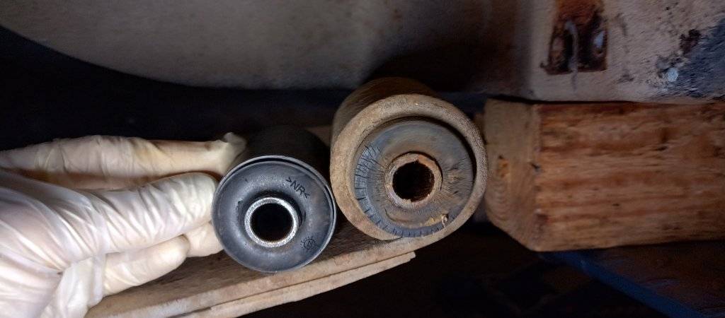

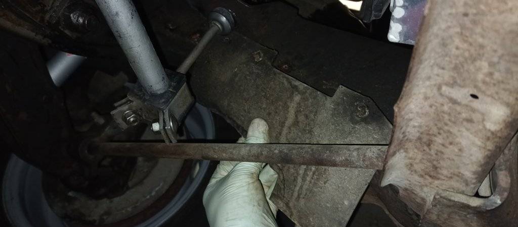

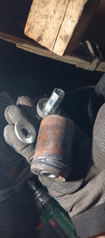

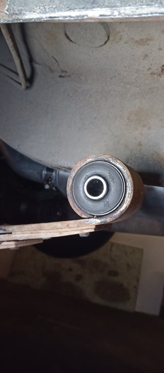

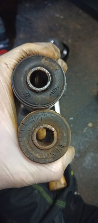

Doing some hard work on the leaf springs. But it was worth it! 400NM (about 300 ft lbs) Torque on this impact drill. Wrecked it nearly up, have to send it in for exchange (guarantee) :D.
Later today i'am going to start to exchange the engine mounts.

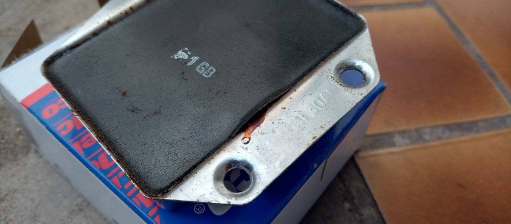

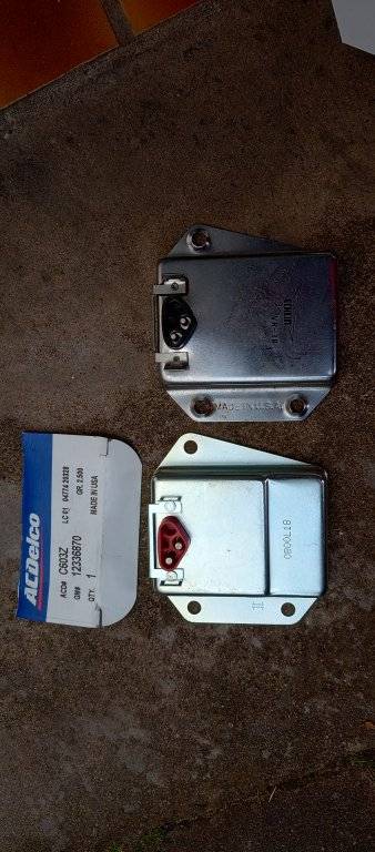

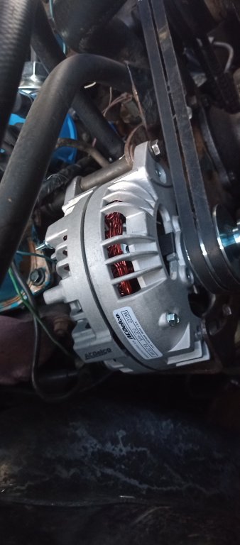

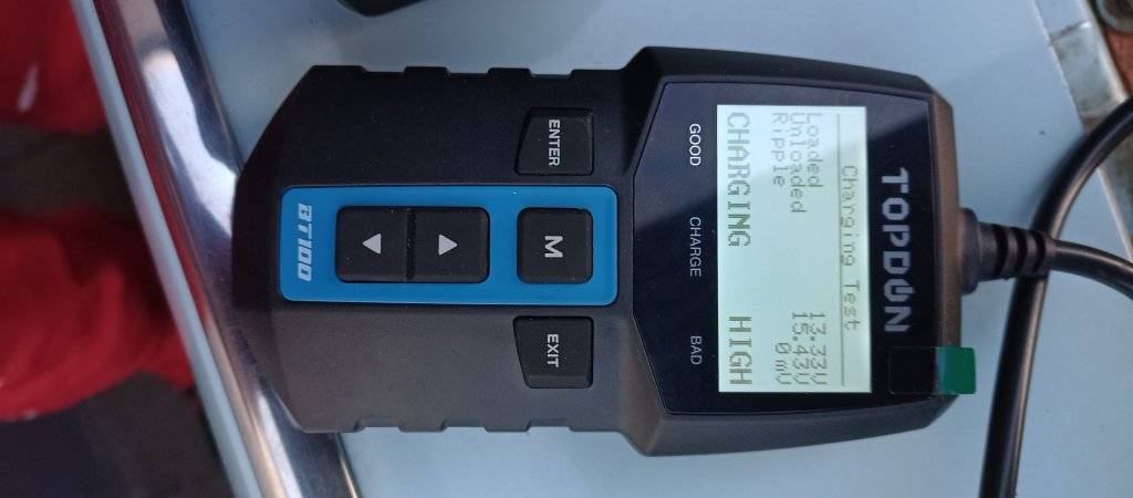

Not that much going on. New AC Delco (Made in USA) voltage regulator was defective out of the box (<15,X V). Now it runs on an chinese SMP V125T one with an replaced AC Delco in the trunk (just in case...).
