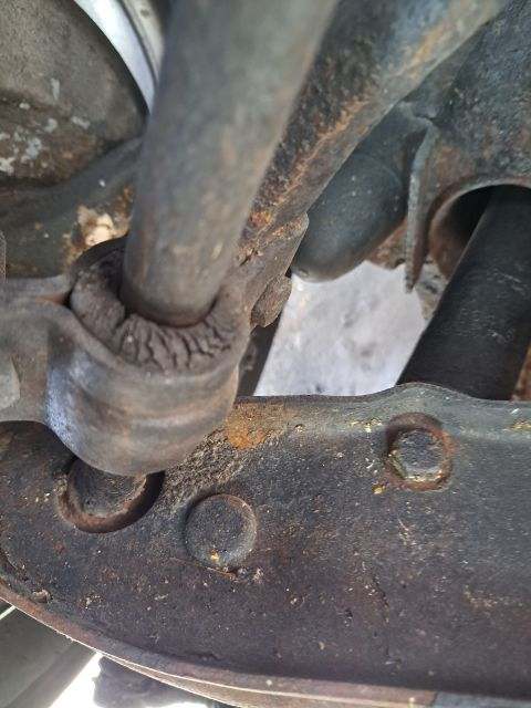

And I still think not replacing the first link in the chain - bushings - along with my choice in shocks is contributing to the lack of performance.

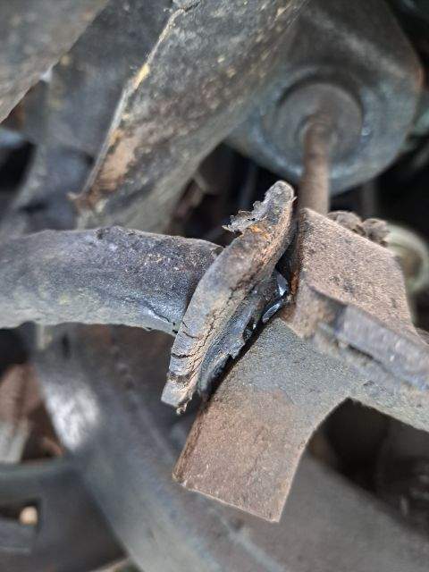

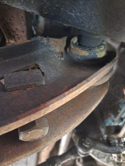

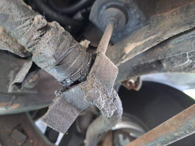

@davidhill sent pictures today that confirm the need for new bushings. Tuesday morning upper and lower control arm, strut rod and sway bar bushings will be ordered. Also KYB front shocks (KG4507) and Gabriel (81091) rear shocks have been ordered through Rock Auto. A big thank you to @ayilar for providing a road map on where to find these new parts.
Typical of what I see here at my place after guys pay for front end rebuilds, the zip ties and electrical tape bushing is a new one on me.
Great to see your doing it right.

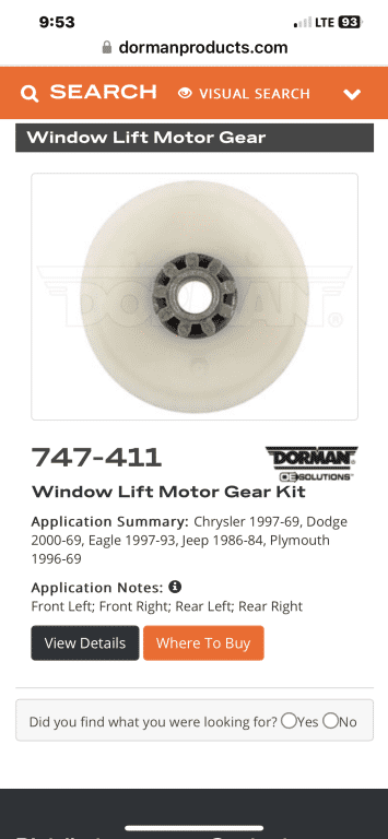

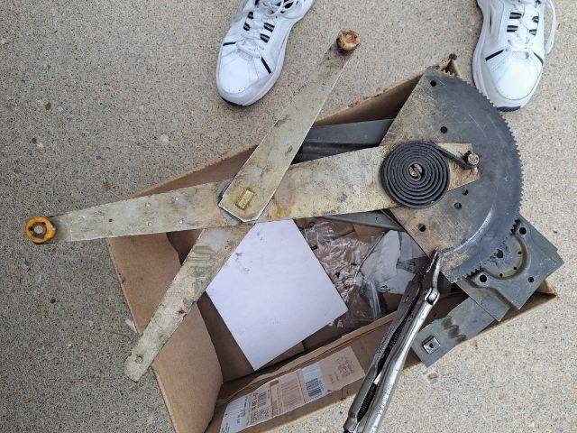

Small set back with fixing the driver side window. After replacing the window lift gear (#747-411) and operating the door the new gear was damaged. It was determined that a new door regulator would be needed.
A replacement door regulator was ordered from Murray Park along with a second window lift gear. The door phase of the project will be on hold until the parts arrive.
David will complete the heater box part of the project while waiting on the door parts.

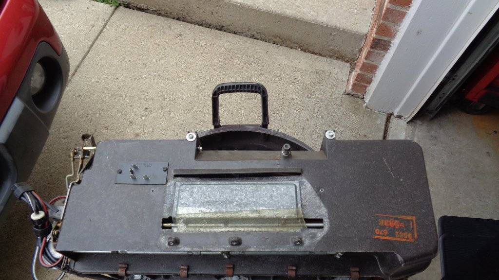

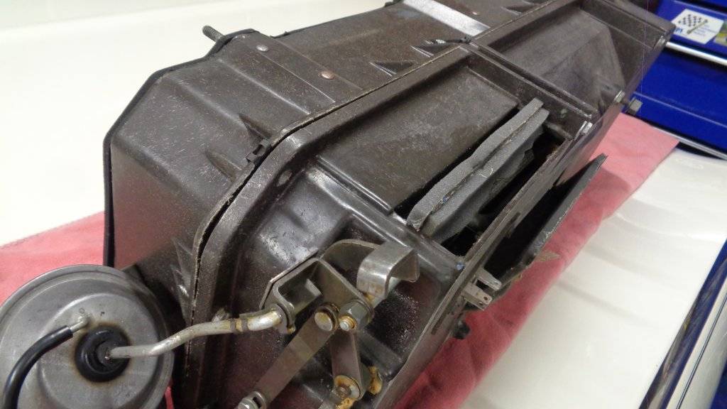

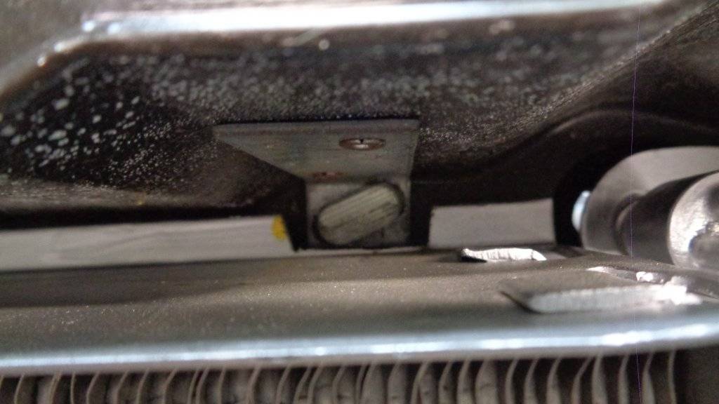

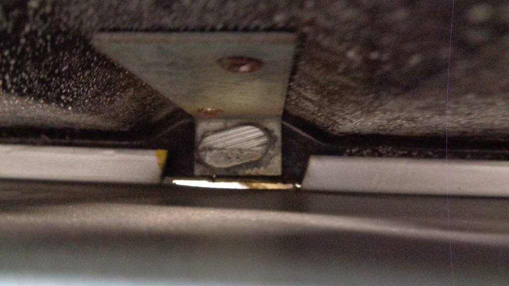

The latest from the Darkside stay here. The window regulator went back together perfectly. The failure was heavy wear at the main pivot point on the mounting bracket. Not noticeable on till all the spring preload was removed. Something you don't see often. Next to be done was the heater box rebuild. As you see in the following photos the overall condition of the heater box was very good. All blend doors worked smoothly and the actuators were operating to near perfection. After a good through cleaning the fresh foam from Detroit Muscle Technologies was installed. See photos,

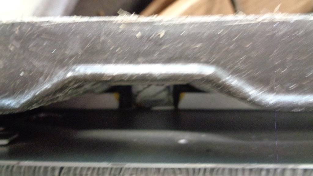

Note the heavy corrosion on the liquid line. The inside of the tubing is heavily incrusted. That would spell an early compressor failure and/or poor A/C performance. The replacement evaporator actually fit pretty well. Only had to notch the evaporator for case clearance. Re-install is tomorrow.

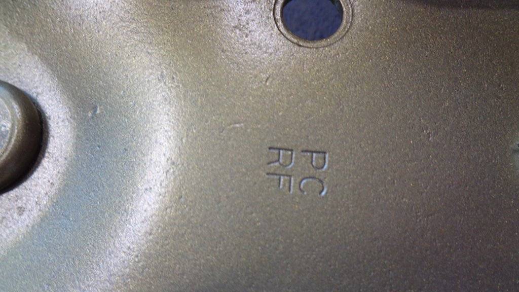

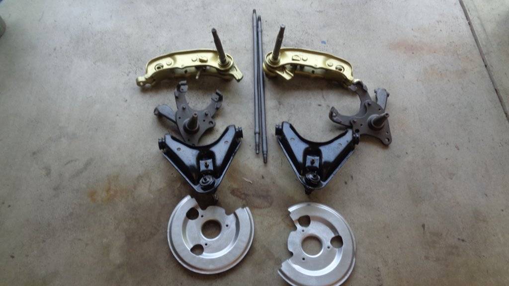

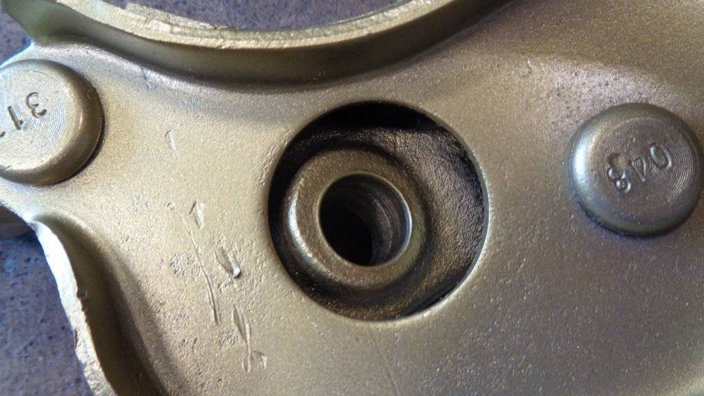

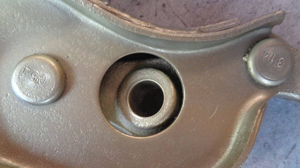

Here is the update you all have been waiting for. As per Randy's request the front suspension was disassemble and bead blasted for refinishing. the upper control arms were in pretty good condition needing just a bead blast and new bushings. Below are the rest of the front suspension after new bushings and painting. Note the orientation marks and the date codes clearly legible on both lower control arms.
Always remember to tap your torsion bars far enough forward to allow the retainer clip adequate clearance to seat.
I made wittness marks on both upper control arm eccentric cams on both sides to keep the initial alignment close. The aligment was still way off, my guess it was aligned w/ bad control arm bushings present. As it turned out I used my bubble level a fixed to the front brake rotor w/ the dust caps removed. Randy confirmed it was very close at the alignment shop.
