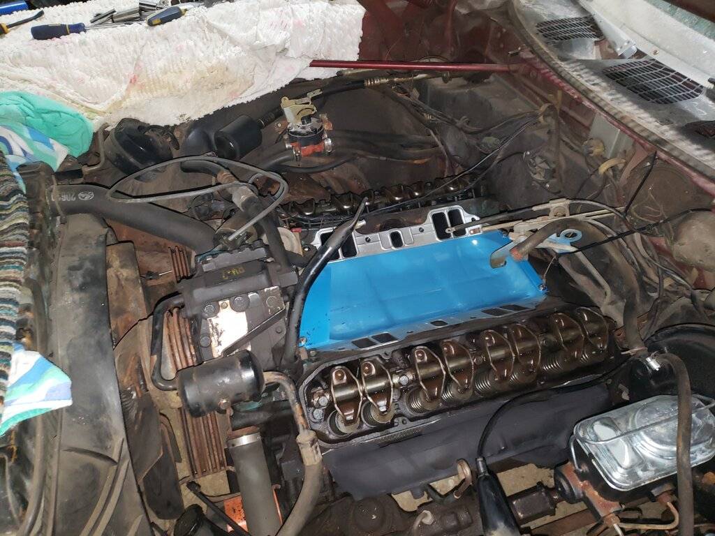

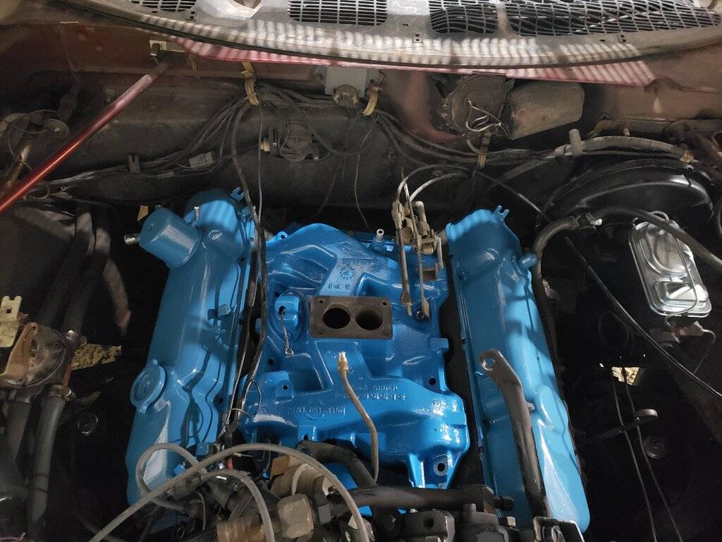

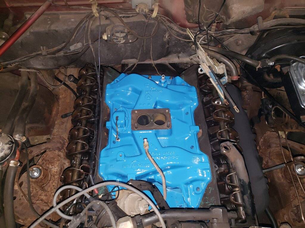

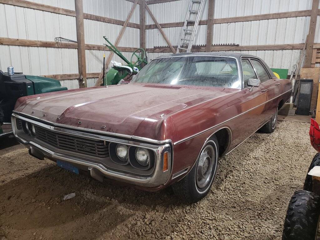

It's starting to come together. Here are a few pics. Still alot of assembly left to do but better done in the daylight.

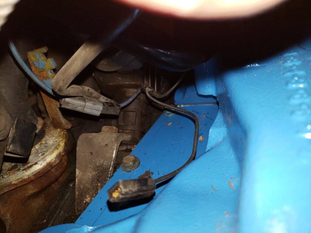

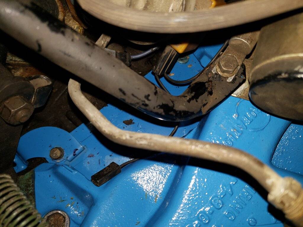

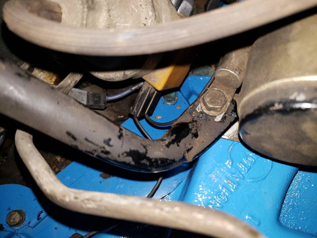

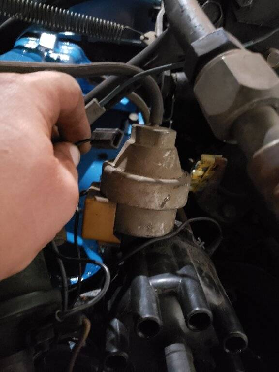

I am getting everything hooked back up and having an issue locating where the ground plug for the distributor plugs in. See picture attached. Any ideas. Of course this is one of the only things that I don't have a picture of when I took it apart.
That unit attached to the distributor is grounded when the carburetor throttle lever returns to idle position. When at idle, the unit will electrically retard the timing a specified number of degrees (usually 5 degrees) to improve deceleration and idle HC emissions.
Much of the time when one of those carburetors gets rebuilt, that ground contact on the end of the carburetor throttle arm adjacent to the idle speed set screw is discarded or it may still be there. But in any case, I personally wouldn't bother with it since that electrical retard device on your distributor probably doesn't work anymore anyway, and even if it did, it really wouldn't make any difference in emission levels of your vehicle enough to bother with (back in 1971 it was a measureable difference but no one cares about these old cars' emissions any more).
So just leave it disconnected (bury it in the other wires in that area) and set your timing to its normal basic setting (which is usually around 10 degrees BTDC) and drive on...................................
I just like to have the unit on my distributors for "correctness of appearance" reasons only.
I doubt but few folks know what it is for anyway.

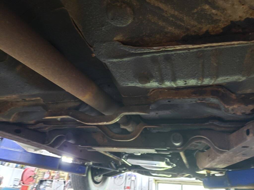

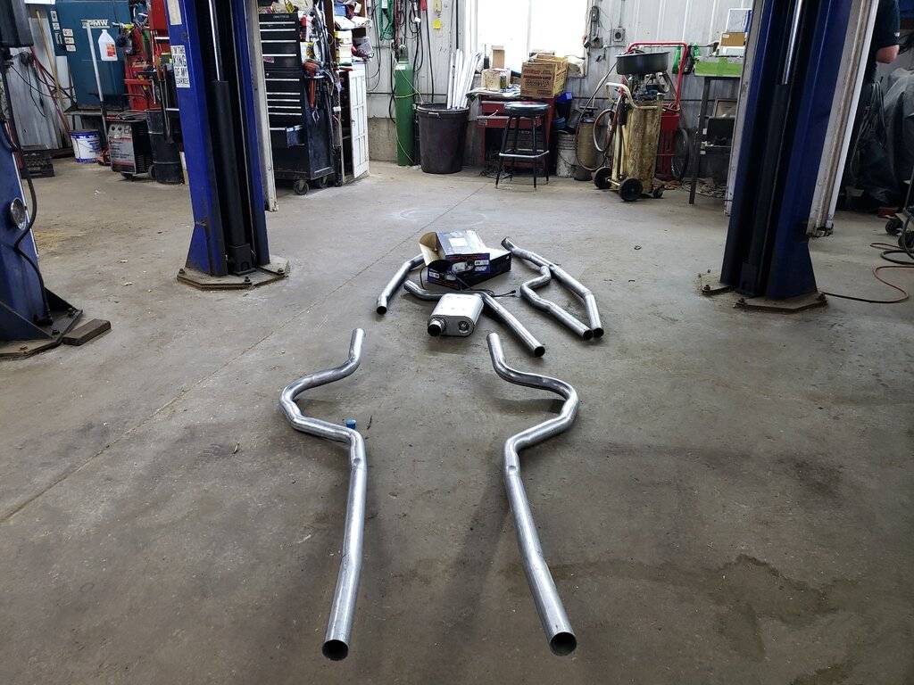

I can try to see if I can make it to the show in Waupun at the end of the month, but I am not sure my car will be ready. It is now ready for a new exhaust since the majority of the engine work is done except new plugs, wires, and adjusting the timing that I will do once the exhaust is on. Here are some pics. The show in Waupun looks like a good time. I will see if I can make it and bring the kids.
