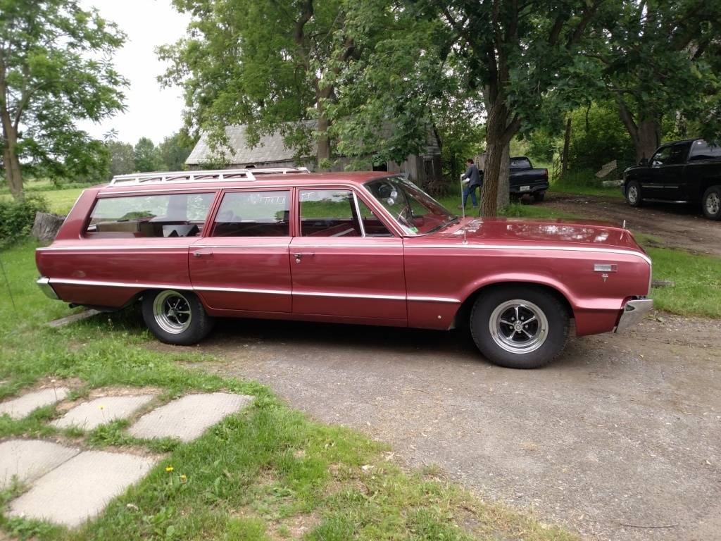

KevinView attachment 75098
This is, strictly in my opinion, the best overall tire size for these cars.
