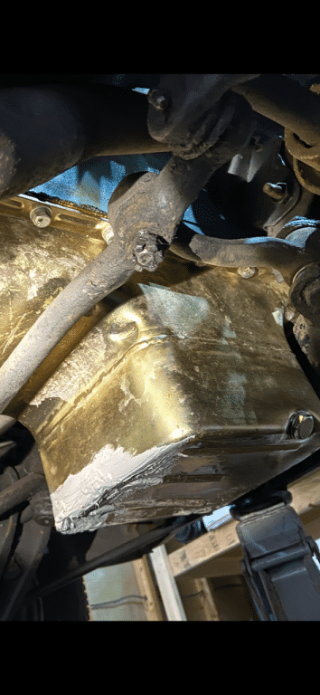

This is the old pan on it and an example of where it hits. This is what was on my car when I bought it a few years ago. I replaced this with an identical 7 quart pan, just so it wasn't fixed with epoxy, but it still hits.
Taking one of the 6 quart A body pans and getting the sump extended to the depth of the 7 quart might be a solution too. I have that Milodon pan saved in my Summit cart, can definitely try that too.
