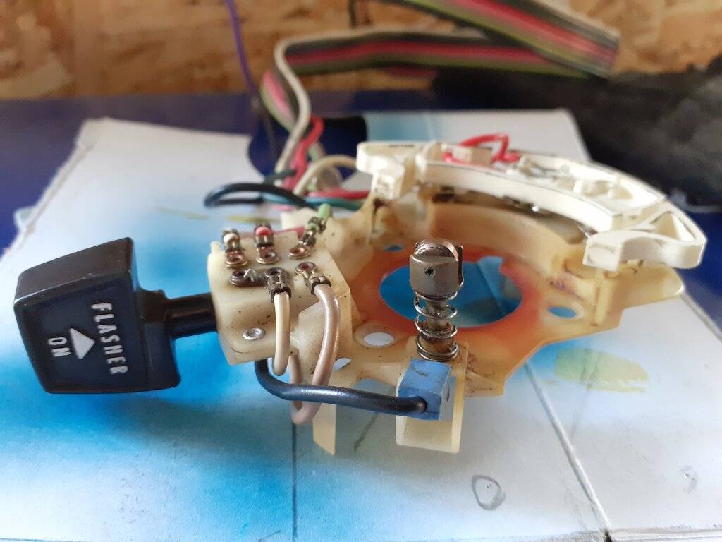

Hi,its a 1970 Polara, this is the original item,removed due to a short on the indicator side.
Item is the spring loaded wheeled plunger, on the replacement (Standard TR7)it's a spring loaded brass plunger that scrapes on the ring, just wondering if anyone has done anything?
The brass plunger that contacts the back of the ring, rather than the spring-loaded wheel pictured, is how every GM turn signal switch has been for ages. Should be no problems in that respect. On my '70 DH43, when the rim blow switch would short out and turn on the horn, the spring under the plunger would get weak and then "no more horn'. Future plans are no more rim blow steering wheel!
