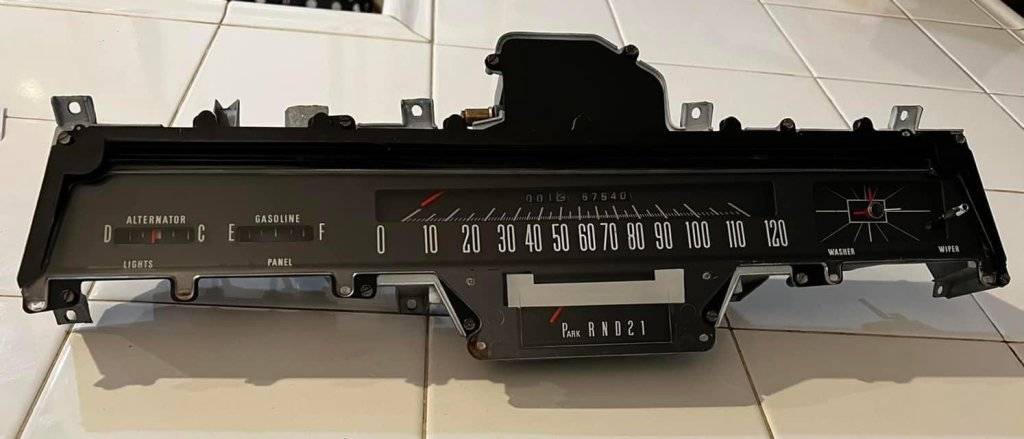

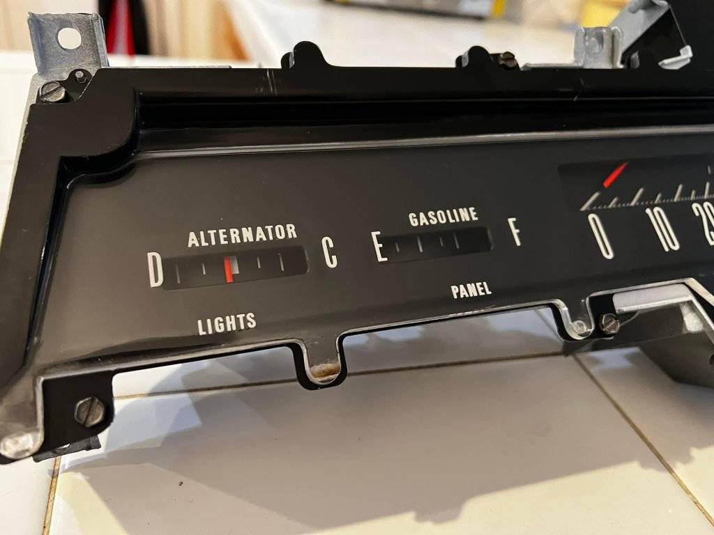

Also, I do plan on doing the ammeter bypass. In fact, I had my gauges rebuilt and in place of the ammeter is a voltmeter so it keeps the stock look.

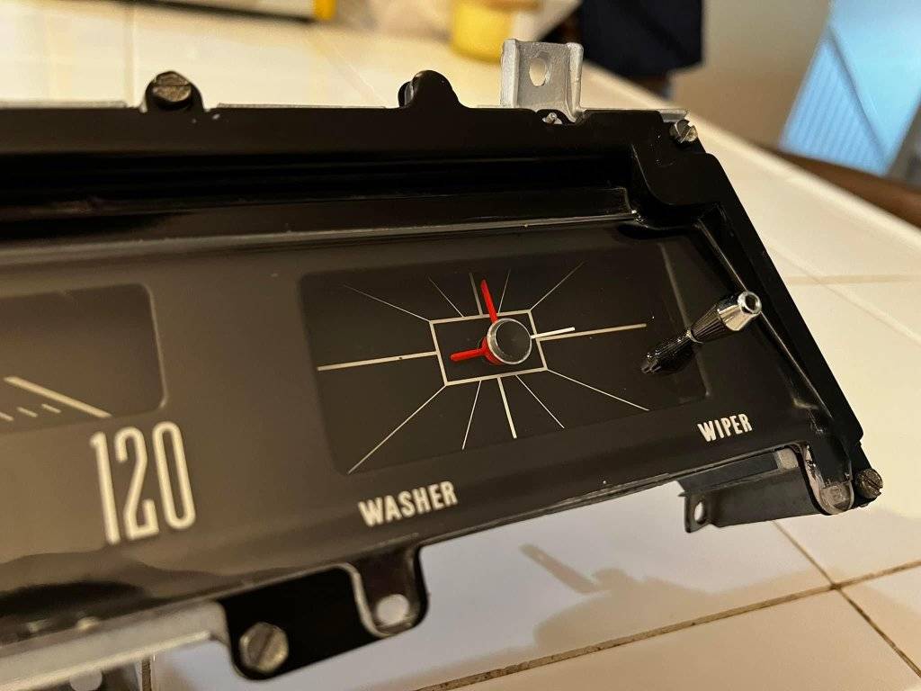

As a bonus I even had the clock converted to a quartz unit!

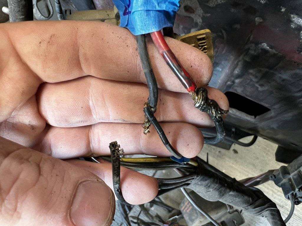

Also, it seems someone *attempted* an ammeter bypass. I guess you can say they succeeded, but it’s just so god awful I can’t tell if this is what put my car in the grave 44 years ago.
This was held together with some skimpy electrical tape. I’m glad I never got the car to run and drive without first seeing this or I would’ve had me a nice C body bbq
