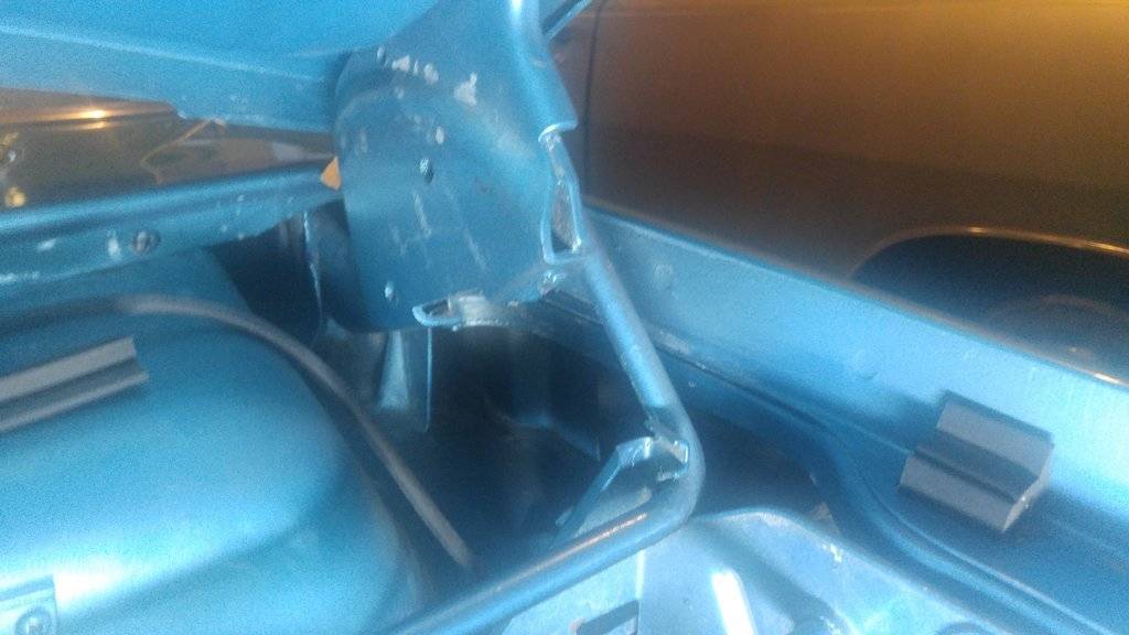

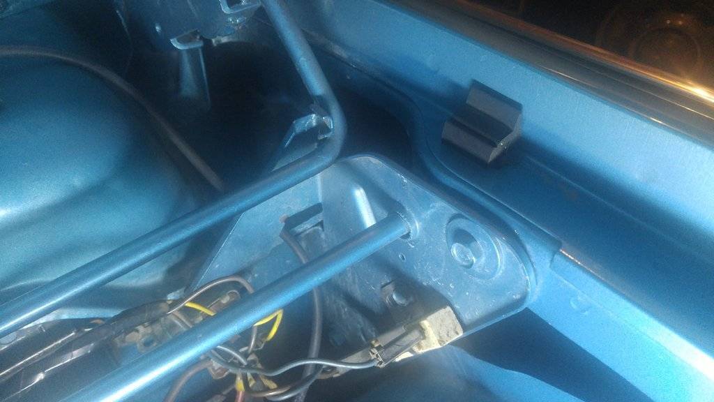

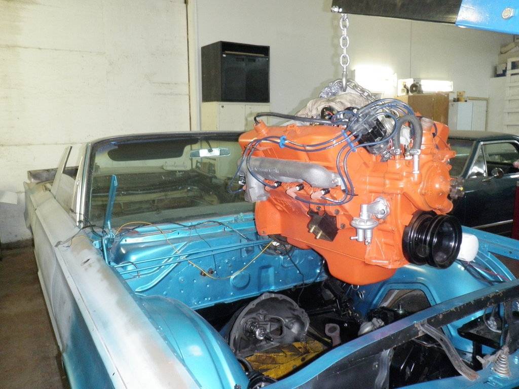

This is the best I have for pics of the car with no hood.

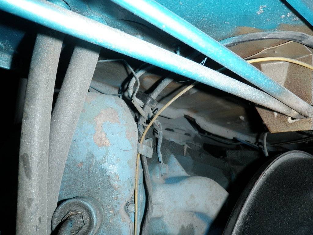

The centre support
can you take pics of the Ends on the back corners so i can figure out how it all belongs?

ive been searching pics for awhile now w no luck.
see how those end hinges are standing straight up on your car?
mine are nowheres near that.
