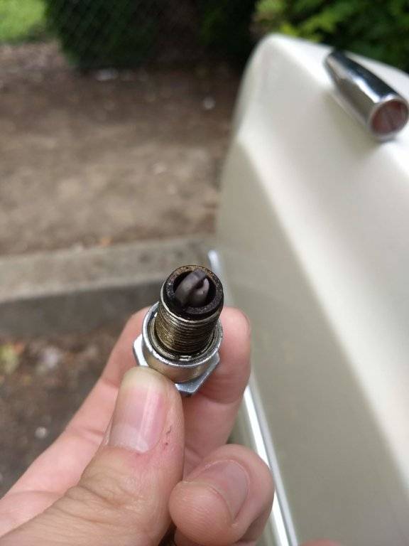

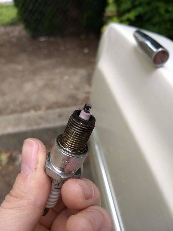

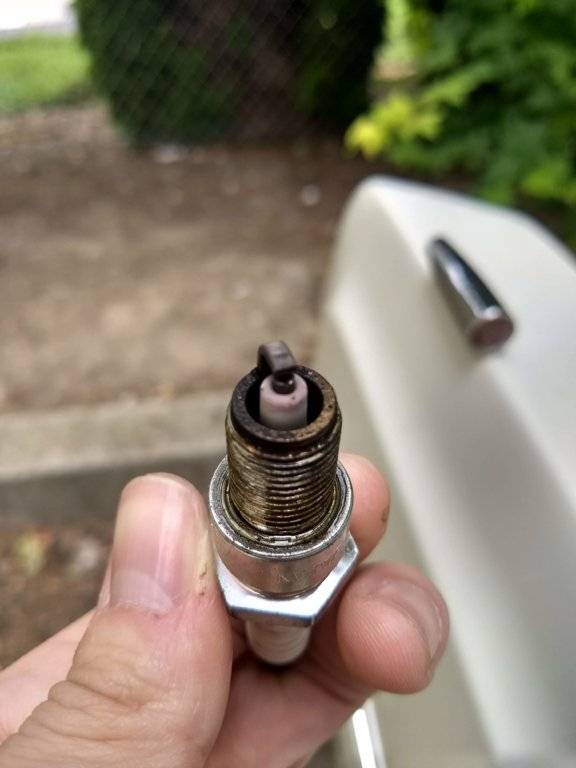

its a Fitech EFI 600HP. Im tuning out a lean tip in and richrbog out now, otherwise it seems to run great. Plugs seem okay too. using fuel only at the moment.
I'll assume a factory electronic distributor.
Does the mechanical advance work?
Is the vacuum advance hooked up and does it work?
