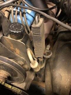

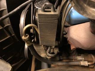

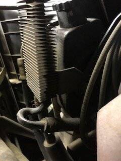

Here are a couple of pics of the PS cooler on my 1978 NY, built with the towing package.
This bad boy glows red hot during parallel parking - docking maneuvers ; )
