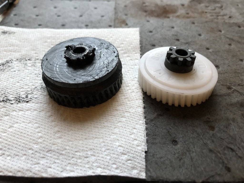

I recently purchased some gears (puck style) from the above seller. They will fit but need the seal that was used on the spring style (at least on my car).
The original gear was taller and fit the more open seal better, I didn't test it because I didn't want to get my clean parts dirty.
The other seal fits it perfectly.

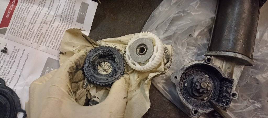

I can't believe how easy it was to repair the motor!! Done with a Cardone part. Thank you very much for this post and showing how to do it!!!!
