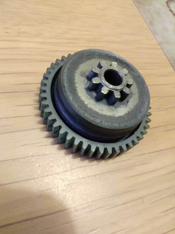

Guys!
Can you help me to find a new window motor gear, please?
I can not find this type gear and i am not sure about replacement part.
I have not seen just the gears available . I bought rebuilt motors and used my old gears which were still in good shape. Other guys have used these motors, in theory the gears should work, but if it was me I would just replace the whole motor. Dorman Power Window Motors 742-301

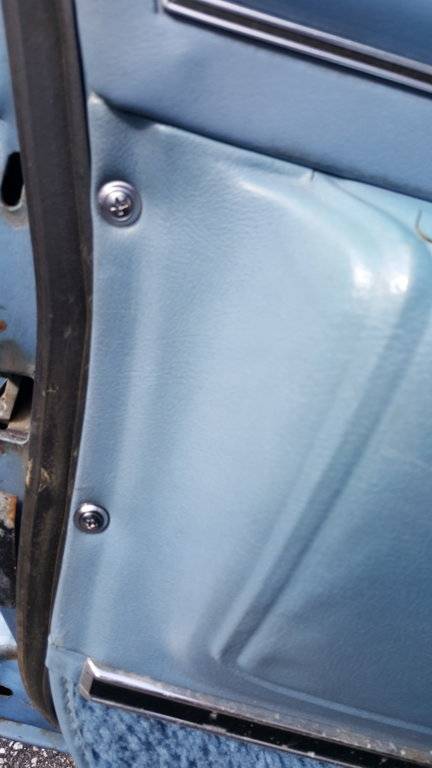

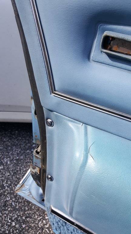

Formal door panel fix.....took 30 seconds and looks factory to me at least.
