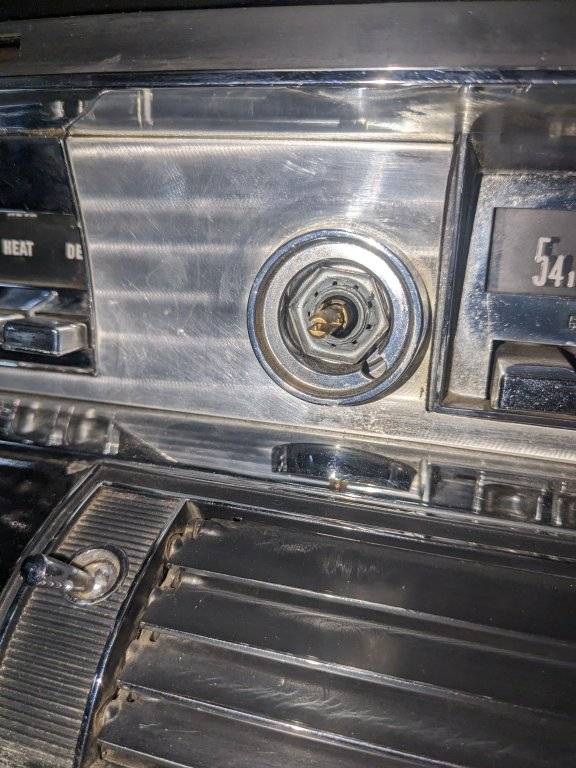

What do folks use to get this reverse nut off?
That is not the right nut there. Use a pair of linesman's pliers, and hold them open against the inside walls of the nut's flats, and use that to get the nut started to turn. Also, gently push on the bezel to push the whole assembly back as you're attempting to turn the nut, so as to take some of the load off the nut. Then it should turn much more easily.
